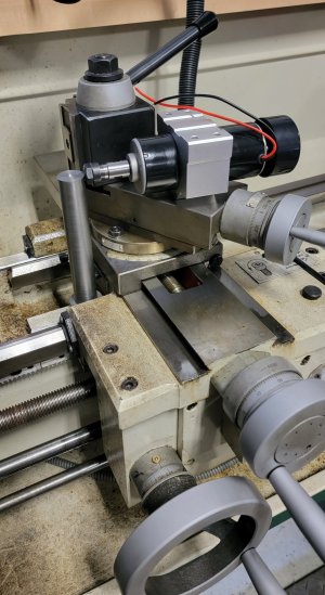

I recently received the spindle motor I ordered to make a tool post grinder. As delivered with the standard mounting bracket, it sits just about perfect to be on my lathe centerline.
Note that the vertical bar in the photo is my lathe tool centering fixture. To mount the spindle motor the best way, I think I need to make a special tool holder to mount to my tool post. I don't have a shaper so I'll either have to use my mill to make a special tool holder or find another way.
After looking at all the trouble @YYCHM is having to make the required dovetail, I am thinking I'll just buy a 60 degree dovetail end mill and make one on my mill.
Any better ideas?
Have a look at this link. A ton of information about making a tool post holder. Its on an Aloris.
Unless you plan to do grinding a LOT, I wouldn't bother mounting it via the quick change tool post. It looks like it would be easy to make a new tee-nut and bracket such that you would take the QCTP off and mount the tool post grinder in its place.
I like that unit looks to be the perfect size for your lathe and nice length it should clamp down fairly rigid.
I think the mill is your best route, but no guarantee's of success without the right setup but with the 60 degree dovetail you maybe have an easier time of getting the two surfaces correct,
