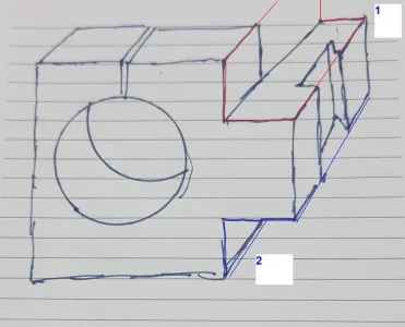

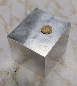

Here is my future grinder tool holder hiding inside this block of aluminium. The block is 4x4x4.5 It is all squared up and ready to machine in the features. It was an expensive block of aluminium by my standards so I want to save as much of it for future projects as I can.

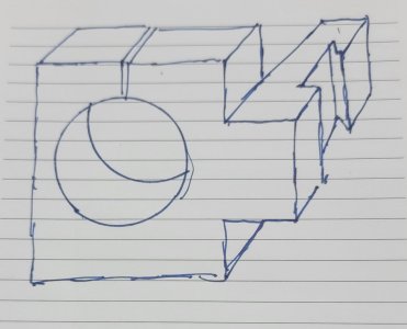

And this is what I think is hiding in there......
As I sit here noodling the machining sequence, I find myself realizing how green I am at this stuff and wondering how others would tackle this.
Although I'd like to start right off cutting out the three blocks so I can save them for future projects, I think that might make it difficult to clamp and position the spindle holder for subsequent machining operations like boring the hole for the spindle motor, cutting the wedge for the tool post, slitting the holder to clamp the motor, and drilling and tapping the spindle clamp.
Any suggestions?
Design concept suggestions and criticisms are allowed too.
Here is what I'd do:
I'd use a bandsaw to take out 1 and 2, then refine the faces on the mill. You now have a good place to work hold. This is also a good time to mill the dovetail. The rest of the details on the dovetail (the height adjuster) can be done later.
Then take out the remaining piece and mill the last face (behind the bore) You can now hold it any which way, and be fine.

That's sort of what I had in mind but you added the details I hadn't thought about - specifically to square up the leftover sides from those first two blocks on the mill BEFORE doing anything else, and then doing the dovetail right away.

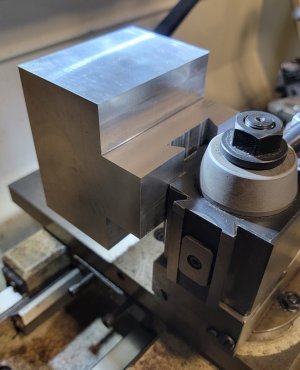

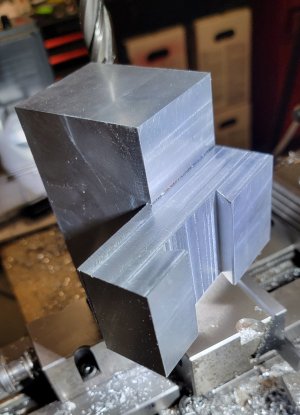

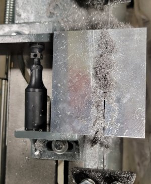

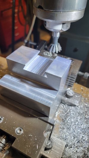

I cut the two bars off above and below the wedge with the band saw, then cleaned it all up on the mill, then cut the wedge groove, then tried it on my tool post. Looks GREAT!
Tomorrow, I'll cut the right back off, drill out the motor hole,and maybe bore it to size.
Gee, how did you manage to get that dovetail right the first time:D

That said, I had my tongue between my teeth the whole time. It's an expensive block of aluminium and I really didn't want to have to cut it off and screw two pieces together. I used my tightest tool holder as the model because I figured aluminium might get loose over time. An elephant could not have licked the smile off my face when that sucker slipped over the toolpost dovetail perfectly with zero room to spare!

Did you used the measure between pins technique to bracket the dovetail width?

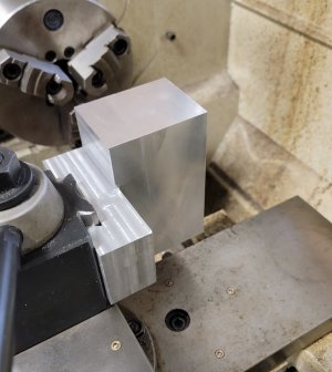

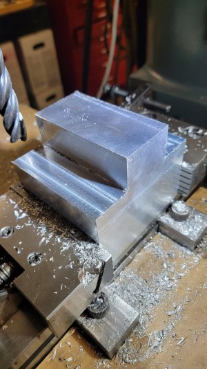

Today I tackled the 2 inch hole for the motor. First I cut off the big block on the right rear behind the motor.
Many thanks to @thestelster for the tip to use a machine leveler to balance the saw vise.
Then I cleaned it up again on the mill.
Still fits the lathe tool post perfectly!

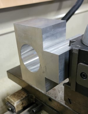

Next I used a two inch long by 1-7/8 annular cutter to rough out the motor mounting hole.

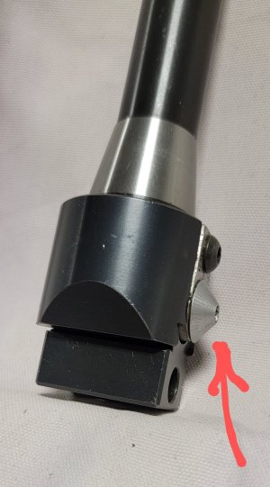

Anyway, after I cut the hole I hit a snag. Apparently a 2" boring bar has a wart on it. That makes it 2-1/8 diameter 3/4 of an inch or so above the cutting edge. That won't work. I need 2.055 inches down the whole hole - not just the first 3/4 inch.
So now I have to order a smaller boring bar which would delay the whole project a week or so, or cobble something up using a long bar in the 2" head. I don't like long tool stick outs.
@YYCHM & @trlvn, & @DPittman .
All three of those would have worked just fine. All very innovative solutions. Another member also privately volunteered to loan me the right size boring bar.
Before I saw your ideas, I went off line, sucked up some big air and went at it with a really long stick out on a honking big boring bar to clear the rest of the battle field. That worked just fine albeit slow to stop the chatter. Also had to slow down the mill a bit.

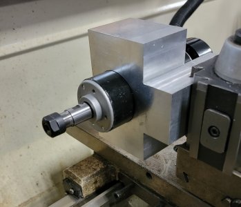

Here is the bored out holder.
And here it is with the motor inserted. I still have to slit it and then drill and tap for two clamp screws. I also want to reduce the thickness all the way around so it will bend more evenly as it tightens down around the spindle motor. Might even end up with another piece of scrap aluminium for future projects.
