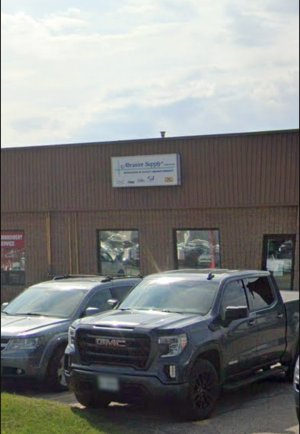

I got some nice mounted stones from a supplier in Cambridge a few years ago. Can’t remember which one though, maybe Abrasive Supply & Service? I just walked in one afternoon, looked through their catalogue of shapes and left with a 20 or so and a wheel dressing stone for my bench grinder.
If you can remember, it would be appreciated. I get there every so often and that would be nice fruitful adventure!
Since I walked in I don’t have any emails to reference but I’m pretty sure it was Abrasive Supply and Service.
