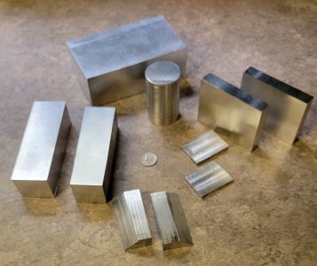

Oh yes, here are all the left over pieces from the block. I was reasonably careful to keep them as big and as useful as I could. Hopefully, they are all hiding a future part inside them that I will find someday. For now, they go into my piles of scrap and stock.

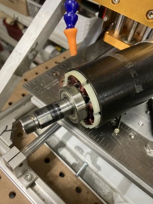

You folks are a very bad influence. Aghast with the idea that my spindle motor might not have bearings, I was forced to take it apart. I’m happy to say it has actual bearings, of a decent size, and pulling it apart took some effort so it appears to be a decent bearing fit-up.
And no, I haven’t mucked up the shaft. The black stuff is from a Sharpee, used to blacken the shaft so my optical tach could read spindle RPM.

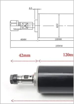

Is that the same motor? The Amazon link shows an output shaft (presumably running through bearings) & separate ER 'collar' mounted on shaft retained by set screw.
But your disassemble pic looks like an integral ER shaft running through motor housing/bearing(s)
