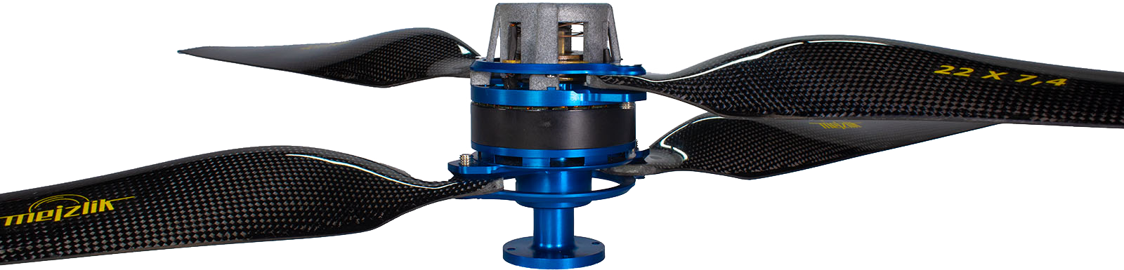

I follow Christian and he also has a variable pitch contra-rotating model that I was thinking of trying to replicate some time.
Another thought. If your mold could be segregated so the end bit was attached obliquely, that leaves the main mold as pretty conventional & represents 95% of the total prop. I'm doubtful the end has much in the way of an airfoil, probably more of a 'joiner-upper' for the blades? In which case you can fudge the section properties so that a separate tip mold could part correctly. Still a headache, but slightly less headache.
With CF the question becomes, how are you building it? In my world only the outer skin layer(s) are spread tow like Textreme, or cloth, but the inner are typically uni (tow) fibers to take the load. That's why they have these 'nail board' jigs to get all the progressive fiber lengths. Now these props are very thin section & large diameter spans which is the worst combination for strength. I've also seen a technique where they cut a specific series of layers like prepreg, again engineered to give the section or fill properties. Maybe if the section is sufficiently thick it works to advantage where random fiber slurry core is feasible. Either way its tricky to get the right fill, close the mold so that there is slight compaction but no voids & minimal flashing. But hey, others have done it, so can you.
Here is a link to props I run, shows some of his molds down the page

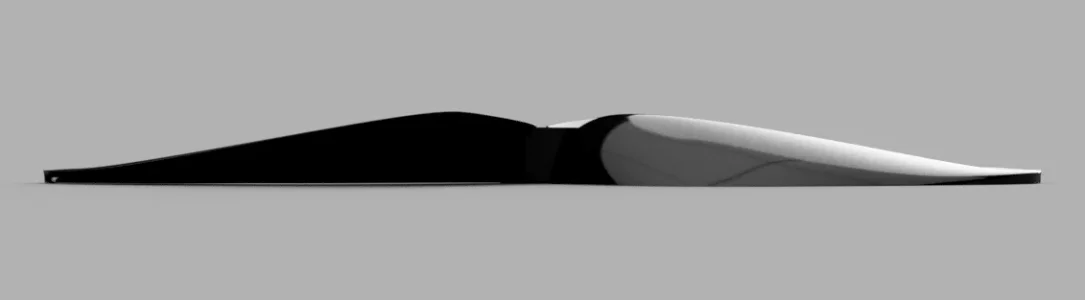

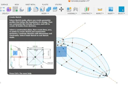

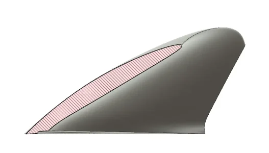

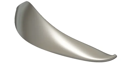

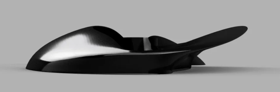

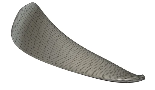

I had some time where I felt well enough to figure out how to model a toroidal propeller. I had done something similar a few years back but forgot the steps needed to create 3D lines that curves on multiple planes. I had to figure out how make a curved surface from one a curve along one plane in order to project a curve on a plane 90 degrees to the first onto the curved plane in order to create rails to constrain the loft of the propeller blades.

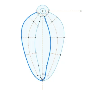

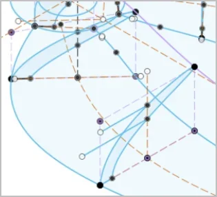

The image below illustrates the two complex curves that comprise the upper rails for the two leading edges of the propeller on one side of the prop. The flat plain in light blue has the two 2D curves that form the rails for the trailing edges of the props.
The image below is 13 different sketches, showing the same elements as above and the individual profile sketches for the propeller on their 11 different planes from a more tilted angle for better clarity of the base sketch
This and the opposite CW prop will be 3D printed so it has a flat on the bottom to attain enough adhesion to the bed. I'll test against a standard 5040 propeller to see if it has better thrust and sound characteristics before doing small production run for further testing.
It will be printed at a very fine setting, then receive post printing heat treatment, sanding and primer and paint coating. Then I'll make a multipart silicone mould in order to make small production runs with different plastics and hard two part urethanes.

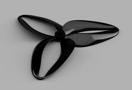

I added carbon fiber for a few renderings but 5 inch props are too small for me to make from CF

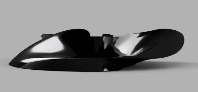

Update for anyone trying to learn from my post...
I used 6 profiles per side of each blade. If there is any misalignment of your profiles the parts will be wavy, and if you look at the above in just the right way you can see tiny imperfections.
The solution is to use the bare minimum number of profile sections to create the loft in combination with rails to make the part conform to your desired shape. I initially had issues with my profile placements causing the loft to intersect itself returning errors but with a few changes and fiddling I revised the prop to use just 3 profile sections per side to have perfectly smooth even curves with no undulations.

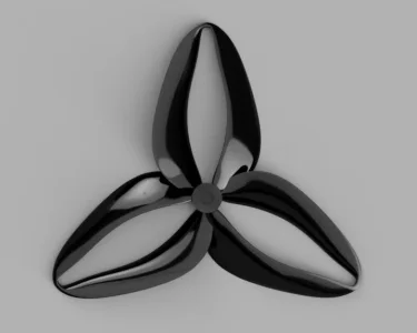

I do not believe a tri-loop prop will be more efficient but I modeled one to try as well, it reminds me of a trillium flower.

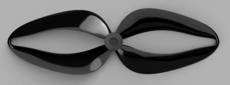

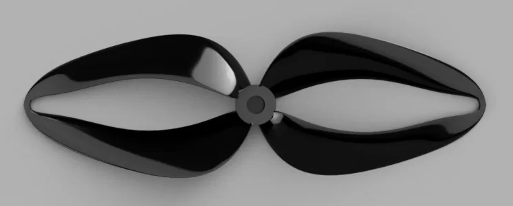

Revised Bi-loop

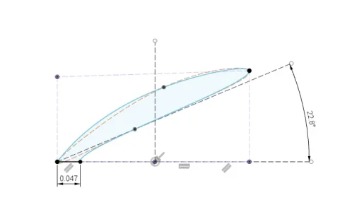

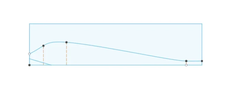

For the aircraft propeller I started with a foil shape taken from a standard 5045 propeller design and modified it. The modifications I made wear to allow it to be 3D printed successfully (hopefully anyway, I haven't yet test printed it) and to match as closely as I could the visual look of the final iteration of the MIT propeller prototypes.

The pitch angle on this prop does decrease from the blade root to the tip in order to attempt to maintain a constant pitch BUT the sketches I used for the blade root and tip profiles are not correct to maintain the correct constant pitch. My tip profile gave me all sorts of issues not wanting to loft and follow the rails.
Tweaking the sketches to assure the correct constant pitch is on tap for iteration number two.

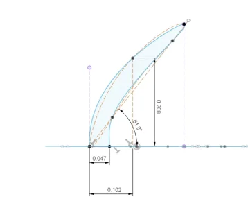

I have completed most of iteration number 2 and it is looking good so far. I have one tiny edit on a profile sketch to do but otherwise it is lofting with the correct pitch angles throughout the blade.
The hardest part was recalling the math to convert from tan a to degrees so I could redraw the foil sections to the precise pitch angles at the 3 loft stations.

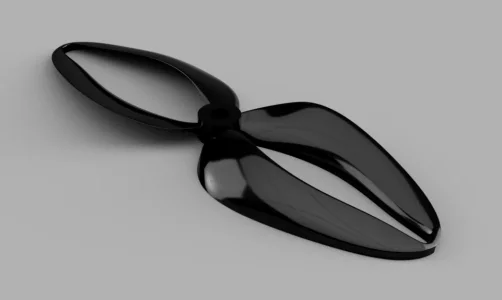

Viewing 1/2 of a loop it looks fairly standard except for the funny looking leading edge.
For this purpose I think the isocurve analysis is better for visualization. That and section analysis, to verify that the rails constrained the loft properly to assure that the expected pitch angle was maintained. I found an issue via section analysis when all else looked good..
Here is the process of how I laid out the propeller airfoil profiles in order to obtain an even pitch angle along the length of the propeller blades.
To prep for this I first laid out the primary loop shape on the bottom plane looking down from the top. The highlighted blue lines will be the trailing edges of the blades and the lower rails to guide the loft. The other two edges of the propeller outline need to be projected to 3D planes done in two separate steps.
Most of the dashed construction lines are to align construction planes perpendicular to the bottom plane to perform section analyses to check that the blades lofted correctly, and as planes to sketch the 5 airfoil profiles on.
Then I sketched the side view profile.

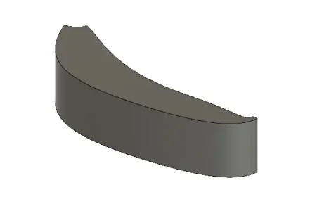

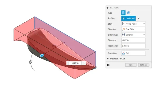

Then I extruded the left lobe of the plan view upwards to create a body...
Then I used the upper section of the side view to extrude a cut thru the left lobe body.
Below is the resulting body. These two extrusion processes were to get the 3 dimensional representation of the leading edge of the left side lobe which will later be projected onto a plane. You can see the curved line highlighted in light blue.
You cannot do both lobes at once because the leading and trailing edges are reversed for the right side lobe. The next step is to lay out 3 sketches for the loft, starting with selecting the construction planes, starting a new sketch on the plane, and then projecting lines to where the body intersects each plane.

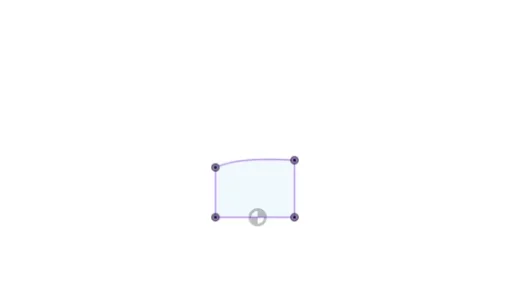

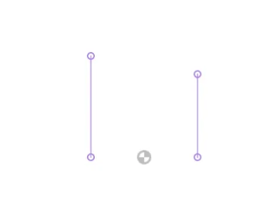

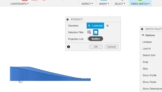

Select the previously constructed plane. Select create sketch.
Select create, project/include, intersection. Select the geometry to intersect, in this case the left side body. Make sure the selection filter is on body and not edges. To facilitate the sketching it is best to keep the body set to not visible, and just select if from the left side menu.
The selection should look something like as follows, convert all four lines to dashed construction lines, feel free to erase the upper and lower lines if you wish. Place your airfoil sketch inside the construction box being mindful that the profile sketch MUST have a point touching the lower left corner and the upper left corner or the the leading and trailing edge rails will not intersect with the profile sketch making it impossible to loft the blades along the rails.
You can see my starting blade root profile where it intersects the hub touches both corners as required. I calculated the required pitch angle for this radius and laid a construction line at that angle to ensure my airfoil closely aligned with the pitch angle. I sketched a base line the width of 2 extruded walls from a 0.4mm nozzle as a printing base. Then I sketched an ideal airfoil using a construction line and then sketched an adjusted airfloil in a solid spline starting at the lower left base corner and ending at the right side of the base line. I then adjusted the spline to match the ideal airfoil as closely as I could.

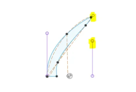

Then I repeated the process for the end airfoil using the same methodology as above. The result looks like this:
Then I created a blade tip profile that is common for both left and right portions of the bi-loop propeller. I deleted all the intersection lines but the four spline points are located at each corner of the intersection.

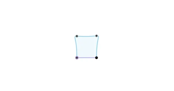

Next up are the right side profiles. But if you use the same method you will get this as your intersection result:
The leading edge and the trailing edges are reversed... if you were to copy and then mirror the profile from the other side the leading edge will not intersect the projected rail you will make next.
Modifications are required to draw a new side profile to use for the right side. I'll cover that in a new post later.

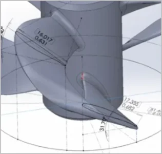

This technology popped up in some commercial/military publications several years ago and recently hit general public publications and is making its way into the commercial market.
While it falls under I must understand this category, I have to much on my plate other than to follow it in passing as it crosses my information feed.
My understanding is greatly increased efficiency in part of "winglets" and vented/controlled lift surfaces, with a lot less required HP. As this develops its going to change a lot of things in all industries that require liquid/gas movements of any kind.

My eye wants fillets adjacent to the hub
Me too!!! I wanted to say this earlier but swallowed the comment because I felt so totally unqualified to say squatt. Better to just keep my mouth shut.
But ya, I think the fillets are required to smooth the flow over the shaft and blades to avoid stagnant pockets at the intersection as well as to maintain a good stress distribution in the structure itself. This was partly behind my earlier question about flow modelling.

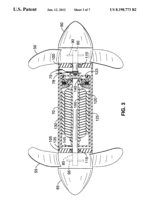

I'm going another route, I'll make two axial flux direct drive brushless motors with a low KVA rating, in a waterproof housing with no gearing. I've already designed a larger motor in this style for an ebike so I know the process. Each motor will have a stationary center ring that holds the stator and a rotor on either side connected to shaft that passes through bearings mounted concentrically in the center of the stator ring. Below is one half of the rotor assembly:
Below is one complete motor in whcih you can see how the central stator assembly can be modified many ways in order to mount the motor to a frame. In this case projections have been added to mount to brackets that will be welded to the bike frame in 3 places. In this case the central shaft is hollow and the same dimensions as a crank set that will pass thru the motor in order to be used as pure pedelec and to provide the perfect chainline as required for gates belt drive.
The shaft of the innermost motor will pass through the shaft of rearmost motor. The two stators will fasten directly to the inside of the housing to affect cooling, the The following image is for demonstration purposes only, just to show the layout. So both propellers will be very close together, an efficiency advantage over the previously mentioned motor with the large spacing between the inline props.
I do not like the propeller shapes below, but the arrangement will maximize the efficiency of the motor and contrarotating propellers. I am super keen to see if a sharrow design will improve things further.

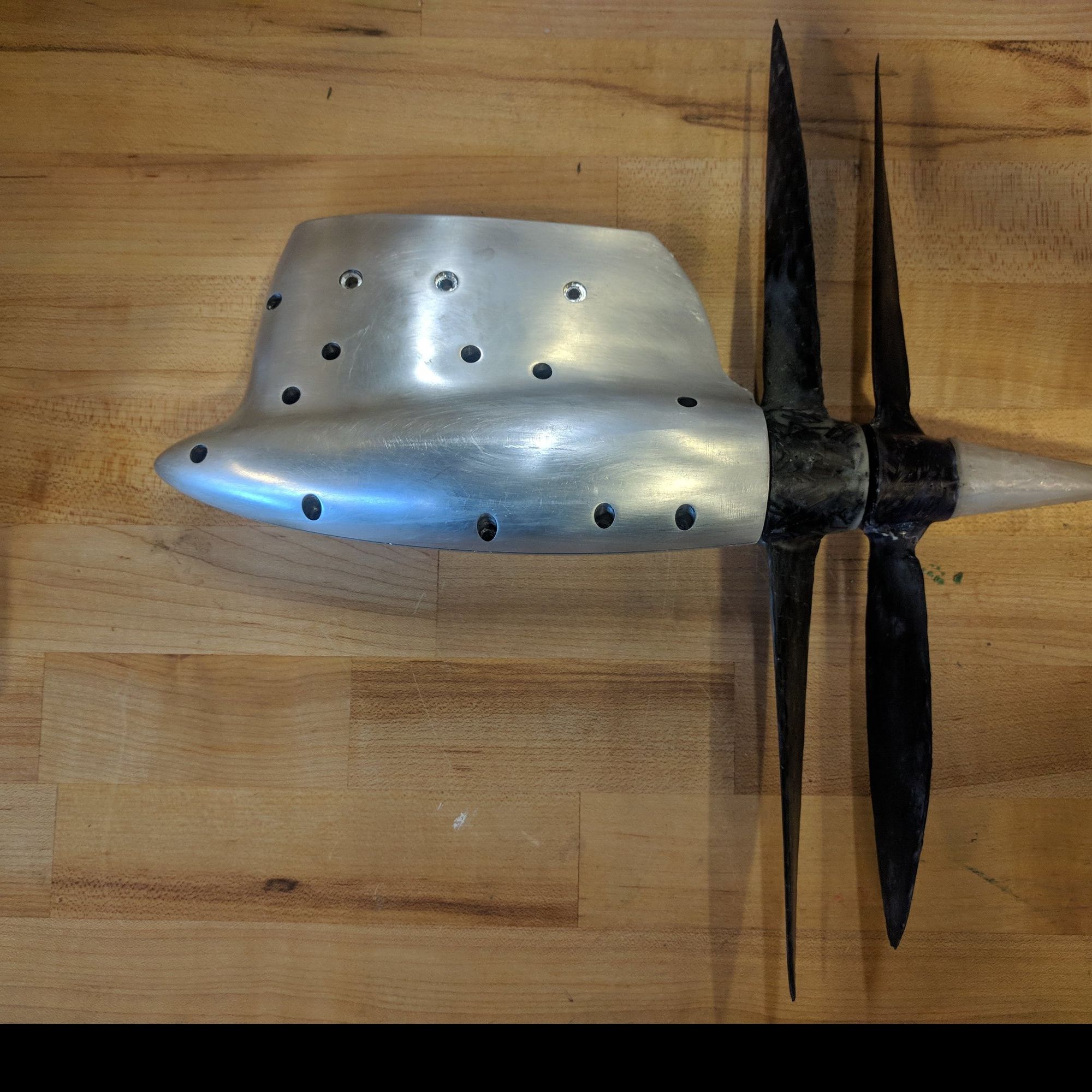

The inventor (Randall J Wishart) of the ugly contrarotating trolling motor is a prolific inventor and does have some good ideas along with a ton of ambition. He just recently patented high speed slip rings for power transmission and a contrarotating motor design with an optimized mounting system for drone applications.
The company is called CR Flight.. maybe I mentioned them already .They claim the following:
30 - 50% greater thrust efficiency​
Up to 100% increased operating range​
Runs quieter, lower noise​
They do not claim but this but drones equipped with their tech should have superior initial stability and should handle much better especially in windy conditions since each motor set will be close to zero torque, versus that standard technique of having opposing motors that rotate in opposition to each other. The motor torque set way out from the center of rotation on a lever require the flight controller to fight to maintain offsetting torques in order to maintain stability. Sadly, I can't find all the patent documents yet to try to copy this.
