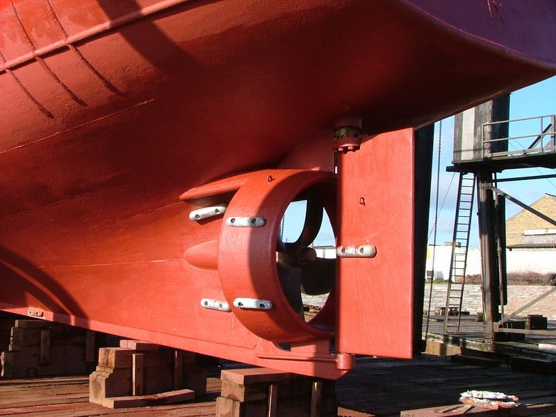

I'll have to read up on that. I know that a simple ring shroud can as much as double the thrust of a propeller for a given input power by mitigating tip losses (subject to a bunch of variables, not all within control). Its impractical for many airborne applications but I would think reasonable for many boat/fluid applications. And you get a bit of protection out of the deal. Probably many tradeoffs on the opposite side of scale.
