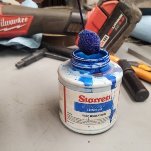

I don't think I can surpass that, but, I will have to see what I can do..... Does my sh!tty little can of layout dye with the mop count as one?
:rolleyes:

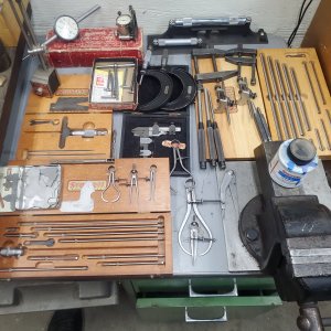

.........my name is Don, I might have a small issue with tools developing..... It started in my youth, I am no longer young. :rolleyes:
You are hilarious!
I'm envious of all the calipers.
@thestelster - I'm guessing that dial in the top 2nd from left is a cylinder gauge, but I'm not sure either.
A lot of cool stuff there.
I thought I had a lot of starrett stuff but even 2nd place has lapped me badly. Ya, I'm out.
