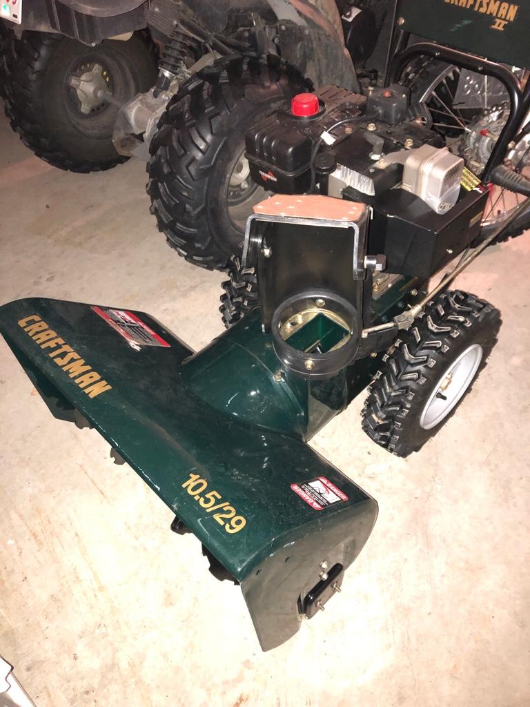

23 year old two stage craftsman 29” for me. Bought it new, back when sears did their own delivery
10.5 HP tecumseh , maybe 5 oil changes, original plugs , starts on second pull religiously
Only consumable part was a single sheer bolt after I put a piece of 2x4 through it
Had to reinforce the plastic chute with some sheet metal and rivets.

Sweet. The very first blower I owned I was ten or eleven years old. I bought it with a "loan" from my dad so I could make money clearing the local hockey rink in Glendale (Calgary). It was an old Craftsman "Driftbreaker" 3-Stage machine that had no muffler—which was part of the attraction. I thought I was the coolest kid in town.
Turns out I wasn't, but at least I felt like it when I was behind that machine. Good memories :)
