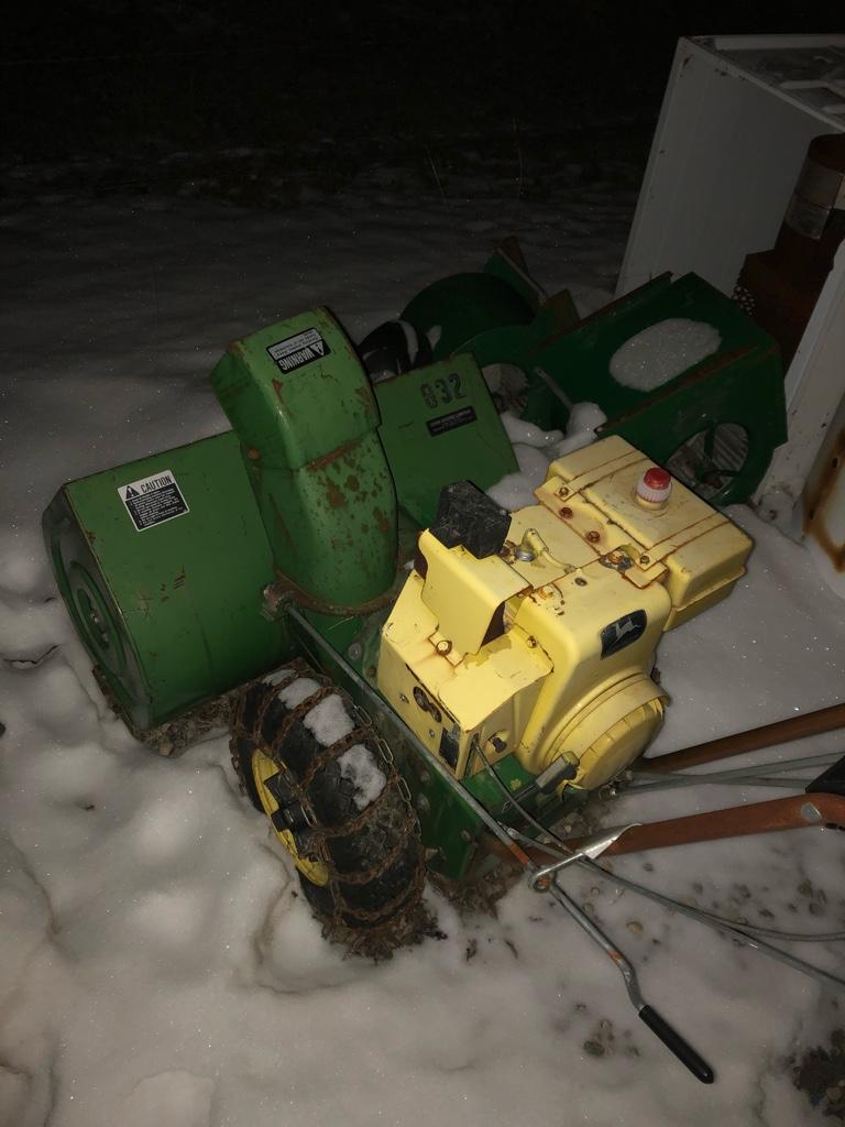

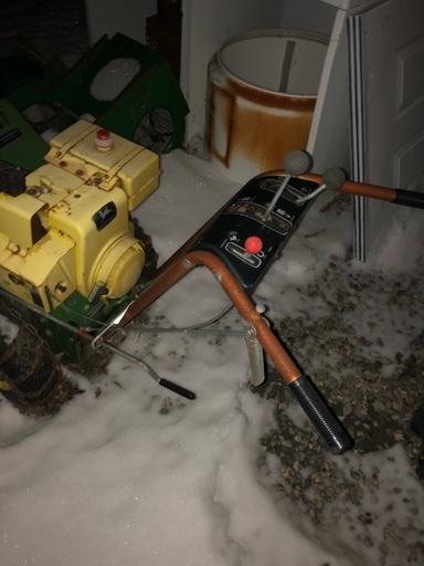

Free project snowblower to giveaway. Your euphoria has inspired me
A vintage john Deere 832. Motor needs work/ might be pooched. It ran but “sparked” a few years back. Buddy was throwing it out, couldn’t watch him do it. This thing is all metal
Msg me if there are any takers
