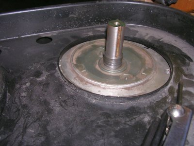

The 3 PH motor shaft is almost 1/2" shorter than the 1 PH motor. So I had to mount the 3 PH motor higher on the mounting plate (I may have to lower it some, time will tell). Still, the motor pulley had to be raised from it's natural resting place to line up with the idler pulley and spindle pulley. I didn't like this situation so I decided to make a spacer for the motor pulley to rest on......

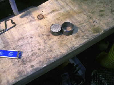

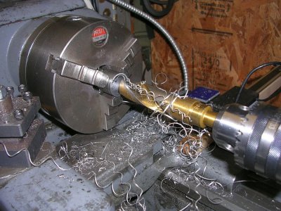

1" round stock drilled out to 7/8".

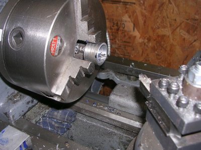

Turned down to the required length...
And installed on the motor shaft.

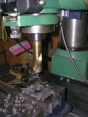

I drilled to 1" (in steps) running at 30 HZ no problem. 30 HZ translates to 400 RPM. Currently belted for 770 RPM with the VFD set for a range of 30-90 HZ. That translates to 400-1200 RPM. I'll try milling in the low and high RPM range tomorrow.

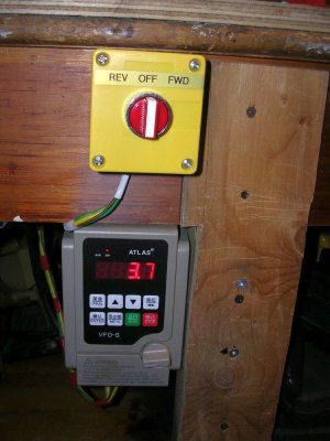

I do now.....
Had to go the hard wired route.
There are 5 wired options.
run-fwd
run-rev
jog-fwd
jog-rev
fwd-rev switch
I only implemented run-fwd and run-rev. Not a clue what "fwd-rev switch" would accomplish???
In any event it does what I wanted it to do now...

Nothing special about the switch actually.
https://www.princessauto.com/en/3-position-select-switch/product/PA0000700324
There is a setting in the VFD that sets the run command channel to panel, terminal, or comms? (it has a Modbus port?). Once you set the command channel to anything but panel, the front panel run, stop, and jog buttons cease to function. There are 5 low voltage terminals that register 12V against ground. I assume only one should be active at a time. There are 25 options that you can configure each terminal to perform but some don't make sense. For example "Key runs" vs "Wire runs forward". What key if the front panel is disabled? If you set the run command channel to panel then the terminals are ignored.
Soooo...… dunno.
Craig, did you get all the functions on your VFD working?
Just FWD and REV, adding more would required a more sophisticated switch than PA sells or multiple switches.
