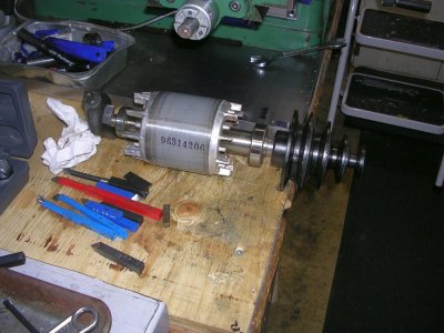

Well.... wasn't hard to disassemble.
No centrifugal switch to disconnect. Lots of dust. The fan and fan cover cowling are plastic???

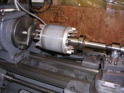

Should be able to do something with this. Just have to careful not to take too much off.
:oops:Ooooops….. not exactly what I intended.
I managed to take the shaft down to 0.858" on the first pass so now it's 0.0075" undersize. I thought I had just touched the tool to the shaft for the first pass not intending to take anything significant off?????
I any event I don't think it's a write off. There is a little bit of wiggle but not much. That pulley wiggles a little on the 1 ph motor as well.
Making the key is going to be fun.... I need the pulley on the mill to make the key yet I need the pulley off the mill to check the fit:(
You get to use your drive plate and custom center, that’s a win!
Were you using a carbide or HSS tool? It’s hard to take a few thou with carbide.
I used a HSS tool due to the interrupted cut from the key way. Finish was excellent, just removed a little more material than I intended.

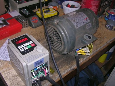

Motor is back together now...
Everything is working as it should. On to making the key next.
Why is it hard to take a few thou with carbide? I thought it was just me?
Carbide tends to be ”dull” compared to a sharp HSS tool. It can be sharpened but the the edge is very fragile. I can dial in and take of 10 to 15 thou and it will be as accurate as I can measure. If I try a couple of thou then it just rubs until I advance the tool enough that it starts to cut more than I want.
