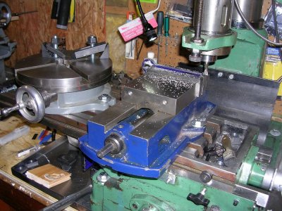

Setting it up with a square gets you to within 0.002 over 6" on the fixed jaw.
Hard to say but even if the vise was perfectly square initially, its possible to introduce that amount of run out just tightening the bolts. By applying torque you are twisting on the washer which is displacing the vise. Even if you alternate tightening the heads progressively back & forth between 2 bolts, chances are good the displacement will be in the same collective rotation direction (vs opposing or cancelling one another) as one bolt kind of acts as a pivot for the other. What might help is 2 washers so they slip. My vise has a slot & uses Z shaped type hold downs which is more downward force vs torque. Even so its still possible to introduce a bit of junk.
Just a personal opinion but I just use the square to get it quite close, usually within the same range as you are getting. Clamp one bolt rather firm, say 60% of full tight & leave the other looser. Run the DTI across the jaw, bump the vise & dial it in, snugging up the looser bolt. If you dial it in as table is moving you can usually get it within one pass with a bit of practice. 2 or 3 for sure so it really doesn't take much time. I know a lot of people use milled keys in the T-slot & prefer that. But I find the key position sometimes don't land the vise where I want it, so I just clamp it where I want it & dial it in. Its maybe personal preference. Keys might have a bit more stability retaining the vise under heavier load/vibration, but I think only if it fits the T slots well on both front & rear edges. My current mill is pretty good but my RF-45 was pretty rough.

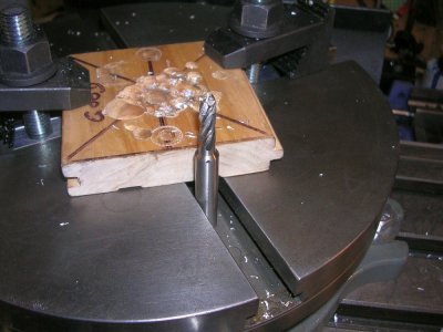

Well... the RT works per my expectations..... solid and smooth.
However the operator sucks big time LOL. That didn't turn out very symmetrical did it!!! I'm attempting to make a spindle wrench.
Good attempt, Craig. I find that laying the pattern out first - either straight onto metal or on a piece of paper that is then taped (or glued) onto the metal - helps reduce errors.
I figured out why I messed up the first attempt LOL. The table is labeled 0-10-20-30...90-80-70-60...0 all the way around.
I'm now working on my fourth attempt to figure out what dimensions will capture the splines on my spindle.
It's 1" OD, and the splines appear to be 0.25" wide and 0.05" deep.
Suggestions anyone?

Well..... it took 7 prototypes to nail down a pattern that fit my spindle splines.
The winning combination was 9/32" holes drilled 0.463 from center and cored out with a 1/4" endmill 0.338" from center. If that makes sense to anyone please explain it to me as calculating the geometry just eluded me.

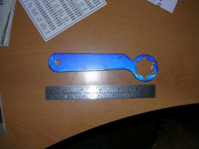

Making the wrench head went well apart from one little ooops and that was milling the OD to the wrong line. Oh well, we will just make the handle narrower is all.
This is the finished wrench. That funky offset handle was NOT planned. When I went to mill the handle the end mill appeared to get a mind of it's owned and peeled off 30 deg in the wrong direction! I don't know if the work piece moved under the clamps or the RT rotated on me. To salvage what I had done so far I finished the handle on the bandsaw.
I suspect it was the work piece that moved as I had it kick out of alignment when I went to round the end of the handle. I probably need to use MDF or hardwood as backing rather than this particle board.
I think I'll try this all again in mild steel.
