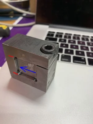

Here quick picture...
@JangerClamping along the blue lines is to resist the force of the part, and the resistance through the hole should be greater...
I had intended (but I probably forgot to mention that it should be relieved along the red lines. I hope this is a little better explanation.
I like these improvements @Janger . I'd also add a vertical slit at the bottom right.
What @Dabbler s slits do is provide for some compression in the other columns. Those big steel columns need to do more than bend a bit - they need to compress. But the big steel blocks cannot be easily compressed with a small screw. The compression will be insignificant. The slits allow for some spatial compression in the gaps not in the steel. I'd make those slits quite long. In fact, size the remaining piece (uncut portion) about the same size as the screw. There is no point in bigger than that anyway. Lots of nuances in there about how fasteners work as well as the distribution of stress and strain in the part.
That said, I think two screws - one on each side - is a superior solution. This allows for 100% compression of the two side columns. As you visualize what the two screws do to the block, I think you can begin to see the issue with the one screw version. The two screws put compression into both side columns, (but still leave the top and bottom uncompressed). Of course the slits help solve that in the one screw version.
In my mind, I am visualizing a simplified finite element model of your parts. That is to say, break the components of the outside block into multiple blocks in your mind. When you do this, you can begin to see how each adjacent element influences the one next to it and so forth around the outside block. If you do this for your original design, you can watch (in your mind) the top bar bending (somewhat like a cantelever) down on the right. But there are only very low forces to pull it to the right as the screw is tightened. The only forces doing that are the restraining forces in the left column that are trying to stop the top bar from bending. They are somewhat like the anchor for the cantelever. But this effect gets dramatically reduced for each leg. In addition to providing space for compression, the slits help turn the hinge points into quasi unrestrained fulcrums for the other three joints.
The two screw version provides raw vertical clamping but no side clamping.
All this said, unless the complete assembly is different than what I think it is, I still don't see why clamping is required at all. I would just make it a vertical slip fit and let the backlash look after itself as the outside jaws are tightened. Think of this a bit like a part put between two (or three) jaws. As the Jaws tighten, the first ones contact the part, and then the part slides until it hits the second, and then the second and the parts slide until they hit the third, and then when no more sliding is possible, compression clamping begins.

Here I finished the test with additional saw cuts. It works much better now - you can see the right side gap is noticeable closed. It no longer moves with hammer blows so it’s tight.

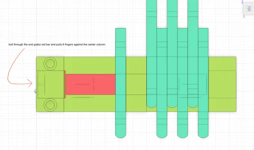

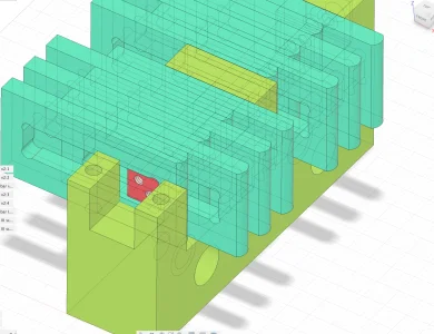

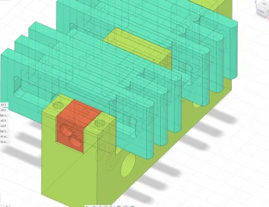

Ok here is how this is supposed to clamp the fingers. First picture shows the red bar it is 0.75"x0.75". You can see it is slightly inset against the fingers. Now look at the second picture. The orange block is is 1x1x1". Bolts go through it into the red bar. Because the red bar is smaller and shorter this means as the orange block is tightened against the red bar the orange block pushes against the fingers squeezing them against the green center part of the vise. The other end of the red bar is the same, the orange block at the other end is also tightened in the same manner. Both orange blocks then squeeze the fingers against the immovable center block. see picture 3 to see the vise jaw block.

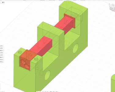

What I am keenly interested in at this point is how the entire assembled vise works. Do you have any drawings of that yet?
I think you only need one through bolt. If the bolt goes all the way through from one side to the other, it will pull both orange blocks together simultaneously against the center block. You can use a bigger bolt that way and only have to tighten once.
Are you using Fusion 3D? I think I may have solved my problem there. I was reading about @Dabbler rescuing an old gaming laptop for his needs and I realized one of my sons has one gathering dust. I may need to add memory, but with a gaming heritage I'm guessing it will run Fusion. It would be nice to have that capability in my shop.
I don't have any other drawings yet - just this 3d model. Yes this is all Fusion 360. @Dabbler was trying to use Fusion 360 on an older machine - the limiting factor seemed to be RAM. 8GB just wasn't enough. I have 16GB on my 5 year old macbook pro laptop and it works pretty decent.
