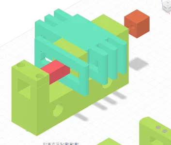

I had another idea I worked on yesterday. To make more room for the fingers I went up above the vise jaw. So now the vise jaw is a fat one 2" thick and the fingers rest on top of that. This frees up about 4.5" for the part. The part would be up higher and require some innovation to use parallels. The red bar is also now 0.75" square instead of 1x2".

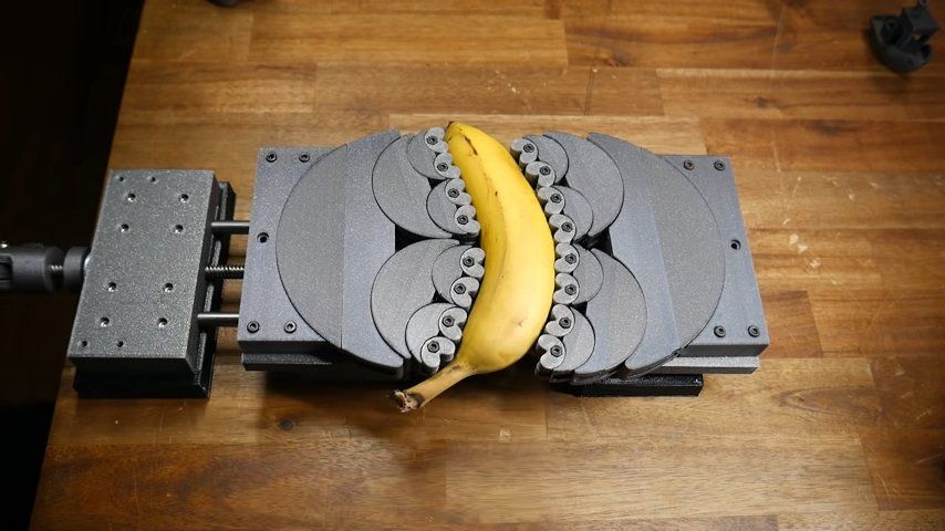

That has to be one of the coolest things I've ever seen. A Banana peeler would be so handy. I bet you could use the banana holder for other things too......
Seriously though, there are a lot of parts on parts on parts on parts on that thing. Gotta wonder how rigid it is. Then again, if it's only used for holding soft parts, who cares!
Very very cool!
Where did you find that?
Don't have one wish I did, saw a YouTube video of a restoration of one. Search for Fractal Vise, original design is actual old.
Apparently they hold extremely solid as it is equal pressure contact.
Thank you! Here is an article on it.
Very very cool!

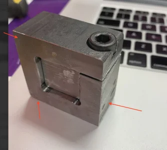

I got this test piece made. Even doing up the bolt as tight as I can the middle still slips by tapping with a hammer. The part is only clamping the middle in one tiny place - light is visible all around that spot. I could extend the saw slit into the back half. The walls are 1” wide and 1/2” thick. Ideas?

3 more holes (one in each corner) to allow the corners more flex which will allow the unit to clamp equally on all sides.
This way it will act more like a band.

I think @Degen s suggestion will help, but maybe not enough. Fundamentally there are no forces to shrink the bottom or the left leg. And even the top leg will struggle on the left side. Bending will not close the gap at the legs.
I can't think of a way to rescue it beyond what @Degen suggests though. I'll sleep on it.
The real goal here is the clamping on the vise jaw of the orange 1x1x1 block. My original intent was to put set screws in the top and just push down on the orange block. @Dabbler thought it would be weak and suggested a clamping structure. Hence the test above. I could put set screws on two or three sides. ?
I just had another thought - the top could be a separate unit completely ie saw all the way across and then use two bolts one on each side at the top. maybe that is the simplest way.

Even thinking on it for a while hasn't changed my view. Your setup is only clamping on the screw leg. All the other legs are way stronger than the screw and are not going to clamp anything. Even if they bent, the overall length will exceed remain the same. It really isn't like a band that slips. It's more like blocks that won't compress. And even if they could, the center block is weaker than they are so it will still be loose.
Even cutting slits all the way around (inside or outside) will not likely solve the compression/bending issue because of the square shape. But it will help.
You might gain significantly though by using two screws on an angle. Essentially pulling two V blocks together. That way each screw acts on two legs and all legs can be shortened to clamp the center block.
