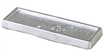

Gentlemen...even better than epoxy is fusible alloys (Cerrosafe). Take your part you want machined, place it in a metal box. Put Cerrosafe in a pot with water, put on a hot plate. Heat it up until the metal melts, pour everything into the box that holds your part, water and all. Wait til it hardens. Now do what you need to do. The water prevents the alloy from getting to hot, because Cerrosafe melts below boiling temp of water. When finished, put the whole thing in boiling water on the hot plate until your part comes loose. Reuse the Cerrosafe.

What @thestelster didnt say about Cerrosafe is its use as a casting metric. You can use to to get very accurate inside dimensions of bores. When you cast it, it shrinks a bit after it hardens so it can be removed and then a while later it returns to its original size so you can measure it and get a very precise measurement. That's what I use it for.
But I love the idea of using it as a soft jaw! For most things you wouldn't even need a release agent. Just leave it there for the usage and then melt it away when done!
This means that for some limited uses, babbett can be used in a pinch - what a great world! thanks for mentioning cerrosafe - I've used it to cast chambers to help diagnose shooting problems, but never as a soft jaw - that is brilliant!

Brownells CerroSafe. They make some interesting points about this product vs. some of the other common names I hear about Cerrobend, Woodsmetal & other somewhat similar alloys

They provide a chart that lists time VS shrink. I can attest to the fact that their published claim is bang on.
They make a point about the need to adhere to the heating process. I found that it attracts impurities after many uses so I'd recommend it only be used a few times for metrics but it could be used an almost unlimited number of times for soft jaws and similar tasks.
See if I understand. After its cast & just cooled to solid, it has shrunk slightly so can slide out of the part? Then while resting slowly grows, at 30 min it equates to original dimensions?
What does the 0.0025" refer to? Do they mean inch per inch?
Hmmm.. that could be useful for other things.
Brownells> Unlike Woodsmetal which swells upon cooling and cannot be removed from a gun chamber, Cerrosafe shrinks during the first 30 minutes of cooling and then at the end of an hour, is EXACTLY chamber size. At the end of 200 hours it will have expanded approximately .0025". This factor is well known by all toolmakers and they will take it into consideration when making dies or reamers or gauges from your cast
