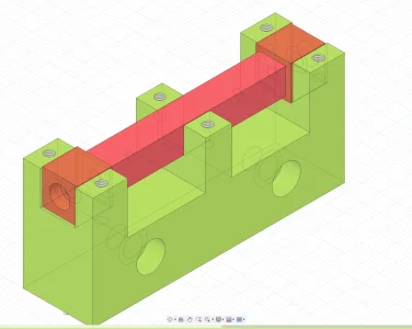

I think you only need one through bolt. If the bolt goes all the way through from one side to the other, it will pull both orange blocks together simultaneously against the center block. You can use a bigger bolt that way and only have to tighten once.
Btw, I'm still thinking you don't really need that square clamping system. Just take up the backlash and go ..... 😉
One bolt seems like a good idea - I was thinking twisting forces with one bolt might be a problem with the red bar trying to rotate on it's axis. Probably over worrying that as the fingers should hold it tight.
For the square clamping system it may not be needed - but I need to mill those square holes. The middle column one is especially tricky. Need a 4" reach through the side square 1x1" hole down to the middle column. So instead if I have top clamps then it will be easy to mill the square hole from the top of the vise jaw.
Agreed. Clamping cap on middle column good approach. Helps to tighten down on fingers and also after set-up the third cap is easy

One bolt seems like a good idea - I thinking twisting forces with one bolt might be a problem with the red bar trying to rotate on it's axis. Probably over worrying that as the fingers should hold it tight.
Yes, I was looking at the center piece and wondering how you would machine it. Caps on all three posts would solve many many issues.
I'm anxious to see the entire assembly. I'm thinking that whole square center piece (both orange and red) does not really need to be square. If the bottom of the Fingers ride on the bottom of the E, they will be flat enough. If not, then one long flat cap that covers the fingers and the E from end to end will force them all flat. The sliding forces between the fingers will never be enough to move them when they are clamped together in a stack - especially if they are not polished.

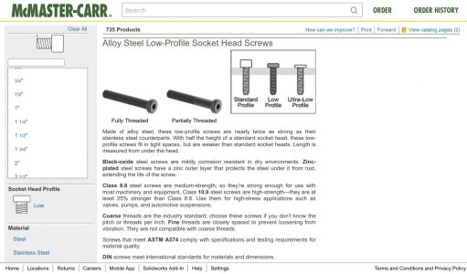

Material between bottom of cap head screw cap and bottom of clamp is 0.085". Too thin? I wanted the clamps to be below of the surface of the fingers but I suppose if it is the same that is fine. I could make the clamps 0.1" taller making the material between the bottom of the caphead screw 0.185" thick.
To make the clamp stronger without sacrificing height, consider countersink screws instead. They retain more of the parent material.
--9 thousandths is too little; .185 is not too bad.

You could use low profile SHCS like these to regain the strength in your clamp bottom without sacrificing any of the other design features as the counter sink will be shallower thus leaving more material on the bottom.
