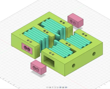

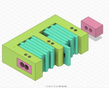

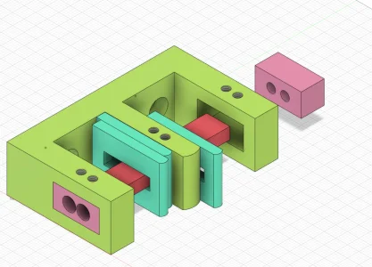

I've been puzzling the problem today and came up with this.
It's a vise jaw which bolts in to the kurt vise same as the usual hard jaws. There would be two of them mirrored.
The pink blocks bolt to the red bar and squeeze the light green fingers against the middle of the E. The pink bocks are then further held in place with set screws through the top.
The jaw is 7.25" long by 4.5 wide and 2" tall. The fingers slide back and forth 1". I am thinking the big E would be milled from a solid block - but could one get away with making the 3 pieces from bar stock and bolting them to the back of the E perhaps with dowel pins? This would need more machining but it would use a lot less material than a solid block.
Machining the square holes to accurate heights of +/- 0.001" I think would be critical to prevent wobbling and lifting. The sides are less important.
No idea if I am going to make this but it has been interesting thinking about it.

I don't understand a few things John. Please forgive a few really dumb questions. But I can't provide any meaningful comments if I don't understand the basics.
Why only 3 fingers? Visually scaling it it looks like you need 6 in each opening of the E for a total of 12 fingers.
And what is the center post of the E for? Are you clamping two parts simultaneously or is it a sort of gauging (or hard) finger? If so, why isn't it skinny like the other fingers?
And why is the whole fixture so big? At 4.5" wide, that's 9" for two of them. No room left in your Kurt for a part.

Only 3 fingers -> I just didn't draw them all in yes I would need 12 of the movable fingers. The center post is fixed and here I'm copying the Norgen design which has a fixed center post too. I think it's because of jaw lift and the center post provides more rigidity. The Norgen one is also 0.75 wide. And it's big at 4.5" - My fingers move 1" back and forth which is more than the Norgen making it too long - you maybe right that I will not have enough room. I'll have to go measure. Didn't think about that issue much.
View showing the threaded holes in the hold down bar where the pink blocks attach and squeeze the fingers.
@Susquatch you are right I'll get 1.45" of jaw opening space with it sized the way I have it. I guess that is why the Norgren fingers have less movement. I could make the red bar less wide say 0.5" instead of 1" and reduce the finger travel by another 0.5" that would add 2" total of additional space. Would the red bar then be too weak? It is not clear to me if preventing jaw lift is the job of the red bar or the friction between the fingers and the center fixed finger.

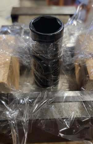

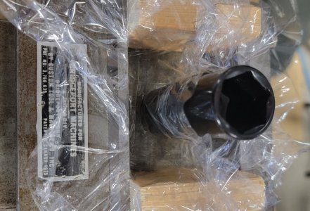

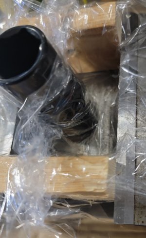

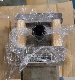

And here is how I use epoxy in a similar way. I couldn't find any jaws I have made in the past.
This method works exceptionally well on fragile parts and even fancy wood such as carvings. You can fill in any voids that might trap a chuck of epoxy with modelling clay or playdoe.
The part I am using as an example is a socket that has a conical body. Just humour me and assume it's an irregular hard to clamp part.
Two pieces of ordinary wood are used to create the bowl. Cardboard works just as good. No real clamping takes place yet.
The part is placed in the vice and then two sheets of saran wrap are used to make a bowl on either side of the part. Sometimes the saran wrap can be separated with more cardboard.
The two bowls can then be filled with liquid epoxy. And left to cure. Everything is easily separated and the saran wrap conforms to the part surface due to the weight of the epoxy. It can, also be smooshed to the part as it cures if better conformance is needed.
Sometimes the two halves don't want to separate easily because of interfolds between the two layers of saran wrap. Therefore I like to pull everything apart after the epoxy firms up and sets, but before it fully cures. If you miss the window, a hacksaw along the seam almost to the part but not quite usually does the trick.
Think of the whole process a bit like casting softjaws but without the sand or furnace.
View attachment 23138View attachment 23139View attachment 23140View attachment 23141

Another advantage of making the safe jaws right in your vice is that the fit to the vice is guaranteed to be perfect too.
Ive also used small hand made carboard boxes, and even just two zip lock bags that are sized for the job. But very few things will conform to the part as well as saran wrap will.
Another thing I like about the cerrosafe is the fact that a separating wall isn't needed. Just melt the stuff away when the job is done.
Lots of twists on the same theme, and lots of ways to solve different problems.
That is pretty neat John - do you buy the epoxy in two big 1 gallon jugs - $90 on amazon for example.?
In my view, a little release agent is almost always a good thing with delicate parts. I like Brownells spray on release agent. I have several cans of it that I use sparingly because I worry about being able to get it reliably in the future. I have also used Johnson's wax (including the spray on variety) and
shoe polish wax. It's easy to buff (just rub it with a soft cloth) to a very thin coating that is easily removed with some alcohol. Or just leave it there forever as a rust preventative. All depends what you are doing.
Last but not least, wood parts sometimes need special care to avoid crushing it or damaging it. When hard epoxy just isn't appropriate, I often use Minwax High Performance Wood Filler. It's a two part epoxy too, but with totally different compressive and structural performance. It's much more like a wood product itself (and great for repairing rotted window/door jams too).
You can pull the saran wrap away from the part a bit to leave behind a curved surface that won't leave a dent in the wood part when it is clamped down. I use this technique when I am inside milling an existing fancy finished wooden object that I don't want to damage with a regular wood clamp.

It all makes sense now John. And it's a great design for what you want it to do.
A few suggestions/comments.
I like the idea of that center part. It acts a bit like a hard stop on the part if everything else is pushed outward before closing the regular jaws. But I'd prolly make it thinner. Maybe the same size as the other ears.
If I were you, I'd make everything shorter. As we discussed earlier, that soft jaw design takes up most of your vise travel. In the absence of a design objective to the contrary, I'd prolly shoot for 1/3 Soft Jaw A, 1/3 Part, 1/3 Soft Jaw B. If anything different, perhaps 1/2 part and 1/4 each for the two jaws AFTER removing anything non-adjustable. That way the outside jawlets can always close around the part.
I would not fuss too much about the fit of the jawlets on their arbour. Let them move a bit but have rough surfaces for better clamping retention. I do think those pink clamping blocks need a good tight fit.
