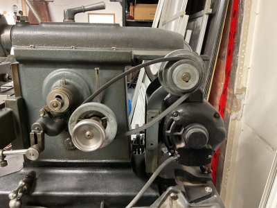

Take a look at this photo, it shows the adjuster for setting the amount of table travel per stroke and the direction of travel. Just to the left of the driven pulley entering the shaper and a bit higher, is a nut on what appears to be on a shaft. Behind the nut is a slot, loosen nut a bit, now this slot is able to be moved, center the slot and there is no table movement, put slot all the way to one side and table will move one way, don’t change the ratchet direction, move the slot the other way and the table will move the other way.
Yes, the ratchet dog will change the direction the table moves, however the table should move when the ram is on the non cutting/return stroke, I say non cutting stroke as the ram “ could” be set up to cut on the back stroke, do not know why it would be, BUT.
Moving the table when cutting results in a tapered cut and much higher forces on the screw and ratchet mechanism.
I hope this helps @Susquatch. @140mower also talks same things in the above posts
If this is not clear, I can try to muddle and muddy up the waters up more. LOL, choke, gasp, up for air.
There is also a second adjuster for setting amount of table movement with the knurled knob and it’s slotted track on the pivot arm.

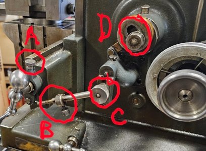

I had a good look at how it all works. It's not obvious at all and some of it isn't even mentioned at all. It will take me a while to sort through everything.
The good news is that your quick check works out ok for the cut I was taking. Well, I say good news but I suppose bad news would have been better in terms of fixing the issues. Bottom line is that my feed happens, during the return stroke, not during the power stroke.
It seems rather obvious to me that rigidity in this little shaper isn't going to be stellar. There may be lots of things like this that need to be compensated for or just outright accepted and lived with.
One thing I noticed right away when I was investigating your suggestions. There seems to be four ways to adjust the feed rate. A, B, C, & D in the photo below.
A has 4 positions R, L, and 2 neutral. The R position moves the table Right, and the L position moves it Left. The neutral positions allow the user to move the table manually. Moving it manually in L or R, does not appear to be healthy.
The B adjustment just seems to clock the feed arm relative to the feed drive. I suppose that there are preferred relative locations that maximize or minimize the relative translation. It works as is and seems to be pretty close to 1 to 1 so I've left it alone as is.
The C & D adjustments are quite interrelated. Both will increase or decrease the feed stroke which increases or decreases the feed rate. C is a plain linear adjustment that even has numerical markings on it.
D is the most interesting. There are no graduations and no directional indicators. However, moving the eccentric to one extreme or the other changes the timing of the feed to coincide with the direction of the Ram - feed during power stroke or feed during retract (what you referred to in your earlier note). There are no markings to show which is which. I suspect you should normally choose which one you want at the same time as you adjust the length of the Ram stroke. However, you can also set the eccentric to intermediate positions ranging from full eccentricity to zero eccentricity to full opposite eccentricity. I gather the choice is best used simply to fine tune adjustment C.
Comments? Did I miss anything or mess anything up?
This is the table step over amount and step over ram direction adjustment on a 8" Peerles shaper. Amount is controlled by how far the connection link mount is from the center of the slotted drive wheel. Direction is controlled by which side of center the connecting link mount is on the slotted drive wheel.
Your Ammco shaper will pretty much work the same way.
D is an either/or position. Always set it to one extreme or the other. It determines when the feed occurs as in on forward or back stroke. aka Eccentric feed nut.
C sets the cross feed amount. 0.003 to 0.018"
B adapts the feed arm to height of bed.
Page 6 of manual is what you need. Terrible manual, they taught the Chinese how to write poor manuals IMHO :-)
You may want to be careful of "B", make sure the link does not bind on the ratchet housing when moving, can be adjusted by changing link length.
"C", I only use to adjust amount of feed, fine and course amount. "D", I use to course set feed amount AND to change table movement advance to return stroke of ram. Being as table can move either way and cutting can take place on either side of project, eg. cutting on left side (facing machine at table end), table feeding towards left, or cutting on right side of project, with table advancing to right side.
