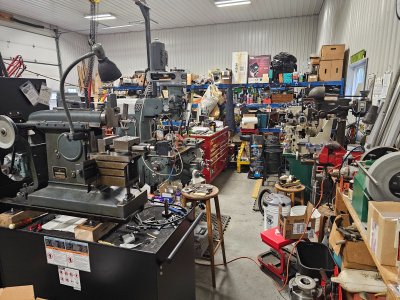

It's raining today and my bride is ignoring me, so I slipped out the back door and made a bee line to my shop. I'm tired of crawling around the shaper so I dragged it over to it's new spot and put it in place. It's now neatly lined up with my lathe, my mill, drill press, and bench grinders. If she knew what I did alone she would natter at me for an hour.
Very happy with it there.
With a 2" stroke length, it is just fine as is. With a 7" stroke, it's a pretty wild ride. So I'm thinking of jacking up the tool cabinet it is on and putting it on wood blocks. If that starts dancing, I'll see if I can find some rubber block to put it on instead.
So far so good.
