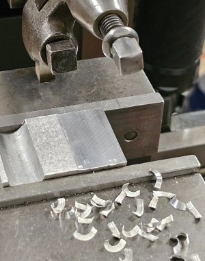

So, I took at stab at grinding a shear tool. That's no piece of cake. In the end, I abandoned the idea for now and made a plain rounded end tool. Most of us know what a radius point on a tool, or round inserts do for finishes. Well the shaper was no exception. A round edge was like a miracle. Not the mirror that @140mower described, but still beautiful.
Left side was the first pass with a normal HSS cutter. Right Side is with a rounded edge cutter. The chips tell the story. If you look closely, you can even see a slight unmeasureable wave to the newly cut surface. Sorta like you see on a nice light surface grind. Very Nice.

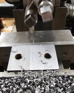

Ground a new Shear Tool this morning. Looking better. Not curls anymore. But too big and not long enough. I think I'm too deep (taking too big a cut and not enough angle on the tool. The finish is getting better though.
The chips nearest the camera are from the previous grind discussed earlier.

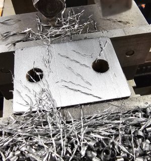

Getting there. Cannot detect any roughness in the cut. But not shiny yet.
Roughly 120° grind, approx 4 thou depth of cut (too much slop on the depth dial to know for sure) less depth of cut, and slower feed 2 clicks.

You are getting closer..... Try halving the cut.... Very light cut and a fine feed are the order of the day.
Just running out the door.... You are on the right track, the chips are getting that long twisty wire look to them.

Getting there. Cannot detect any roughness in the cut. But not shiny yet. Aluminium would undoubtedly be better than Mystery Steel.
Roughly 120° grind, approx 4 thou total depth of cut (too much slop on the depth dial to know for sure), and slower feed 2 clicks.

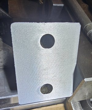

Here is the final finish. Not a mirror, but it feels really nice.
