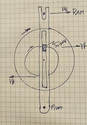

If you're not familiar with the mechanism there is a vertical arm hinged at the bottom. At the top the arm is hinged to the ram. Motion is derived by a pin rotating on the bull gear and running in a slot in the vertical arm. When the pin is on the top of the bull gear traveling horizontally it scribing a larger arc than when it is traveling horizontally on the bottom but the rotational speed is the same, so longer and shorter travels in the same time have to be different speeds for the ram.
On the 6 and 7 AMMCO Shapers, the Ram is driven back and forth by a vertical arm that is hinge pinned at the bottom and pushes the Ram back and forth at the top. The arm just rocks back and forth as the bull gear slider/eccentric goes around and around. The slider itself is bolted to the bull gear but slides up and down in the arm as it goes around and around on the bull gear.
The arm is driven back and forth by the sliding eccentric that is adjustably pinned to the bull gear. The radius that the slider is set at defines the stroke. When it is in the center, the slider merely rotates and the arm does not move and therefore neither does the Ram.
As the radius of the block set point increases, so does the rocking of the arm and therefore the stroke of the Ram increases. At a maximum radius of 3 or 3.5 for the 6 and 7 inch shapers respectively, the eccentric/follower moves in its largest circle which moves the arm in its largest back and forth arc, which moves the Ram through its biggest stroke.
That's the simple part. The more difficult motion to see is the result of geometry.
The Ram always slides back and forth at the top of the arm on the drawing above. But the sliding block moves with the bull gear at a variable distance from the arm pivot. Since the rotational speed is the same, Vt and Vb for the block are the same, but in opposite directions.
However, the speed of the top of the arm depends on how far the block is from the pin. At the top, the Ram moves just a bit faster than the block. But at the bottom (return stroke), the Ram is moving about 5x as fast as the block because of the ratio of their distances from the pivot.

One of the reasons I worry a bit about your motor turning backwards, is the mechanical leverage. When the Ram is driven by a follower with a 5:1 leverage, something could break. It's better to have the leverage low to reduce the possibility of damage.

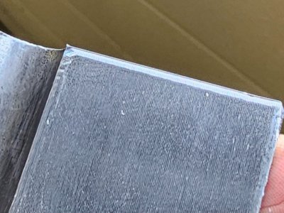

Beautiful finish. Camara lens makes it look ugly, but it's gorgeous......
But, I need some shaper advice here....
Look at the leading edge. Looks like it digs in a wee bit deeper when it first connects and then bounces out to finish the cut. And what's with the wee bit of shatter as it leaves the cut on the left side? What is going on?
