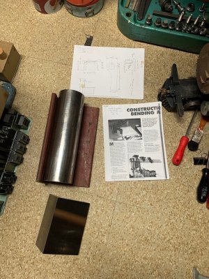

While waiting for all of the bits and pieces to arrive for round two on drilling the #80 drill holes in the steam jets, I decided to tackle the last major workshop build that I probably will ever do and that is to construct the very advanced miniature tube and pipe bender which was described by a retired Rolls Royce tooling engineer from memory of the ones used there to bend all of the stainless and other exotic tubing used in aircraft engine production.
The two part construction series was described in Model Engineer's Workshop magazine No. 94 dated November 2003. It was awarded the silver medal and the Bowyer-Lowe Challenge cup at the 72nd Model Engineer Exhibition.
It is not a beginners project and to be really useful, it has many accessories which need to be built (much like the Quorn) to handle every and any type of simple or complicated bending job that may ever come up. And it is not easy to build. I found this out right from the start.

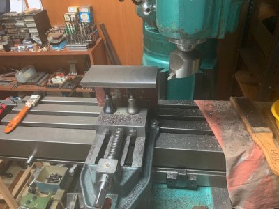

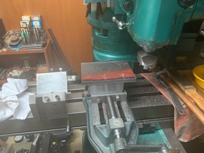

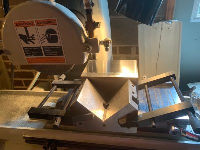

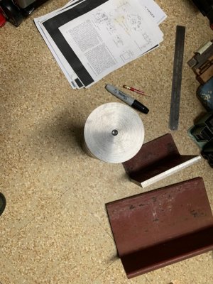

To start with it requires a length of 6" x 4" structural steel angle 1/2" thick and a 12" long piece of 3-1/4" diameter round mild steel bar as seen in photo 4. You don't just go into your local metal supplier and say you want what you see in the photo because structural angle that heavy is not all that common and if they do manage to find any, the price will bankrupt you.
Anyway, the first preliminary operation after roughly cutting the pieces to length is to square the angle on all sides and on its outer faces. This alone took hours and hours. And since I finished only one of the pieces on the hand traverse surface grinder (the setup as seen was at the capacity limit of the machine), many additional hand cranking hours were involved to do this. I do not want to do this ever again.

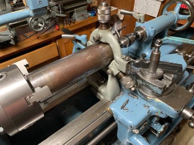

To face and put centres in the bending head, the 3-1/4" diameter round bar has to be set up in a fixed steady. My 13" SB fixed steady will just do it as it is right at its absolute maximum capacity. And that bar weighs 30 lbs. Nothing for a commercial shop but something else for my home shop machines.

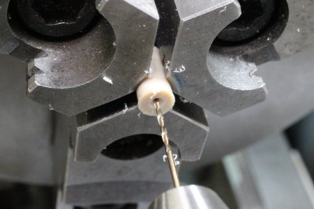

Oh and (unrelated) a few pictures for you. I used my sensitive drill Albrecht in the tailstock the other day in some grabby GF30 PEEK 0.8 and 1.0mm dia hole x 20mm long in peck mode. It worked pretty good. You absolutely need a proper spot drill >= drill included angle on the small stuff. As mentioned before I've drilled smaller diameter holes than this with carbide circuit board drills which have a nominal larger shank, 3 or 4mm I cant recall. I actually prefer them, I can grip them in a conventional precision chuck. But you have no infeed feel with the tailstock wheel & pecking is clunky. The Albrecht wins on that front. I bought mine used in excellent shape from someone on the forum a while back, but I'd have hard time coughing up dough for a new one.

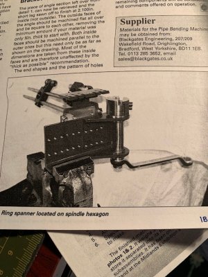

Hi Peter,

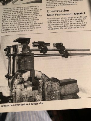

Here are a couple of shots of the overall bender from the construction articles (Nov. 2003, Dec.-Jan. 2004 MEW). I can't send the actual construction drawings from the articles as they are marked copyright. But there are many sources for back issues of Model Engineers Workshop if the project looks to you worth undertaking.The tooling though is really something.

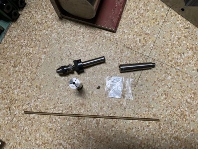

The special, ultra sensitive miniature hand feed Albrecht drill chuck, with micrometer feed, like Peter T, I bought used but it was like new. It was just dirty and needed a thorough cleaning and oiling to operate smoothly. These chucks do not come up often so when they do and if you need one...
It was expensive enough but not anything like the new price. It will be held in a 1/2" ID MT 2 collet in the tailstock of the 9" SB lathe. You do not use the tailstock hand wheel for this drilling operation.
I am now holding the 3/16" brass hex bar stock in a purpose 3/16" 3C hex collet to minimize runout instead of a 3 jaw chuck as in the first go round. Also, I now have a dozen #80 HSS drills to play with. We will see how it all goes.

Pushing on with adding centres to the 3.5" diameter bending head bar billet.
It seems simple enough but I was dreading this operation as I had never handled such a heavy piece in the big SB lathe before nor had I used the fixed steady before.
See the setup used, photos 7,8. I used a dial indicator to centre the far end of the bar in the fixed steady and a 3 jaw chuck at the headstock end but no matter what I tried, the fixed steady rest end of the bar would not centre better than to 0.007" runout. I measured the OD of the bar and it was good to 0.002" wherever I measured it.
To make matters worse, the bar wanted to walk out of the 3 jaw chuck when facing the end and I nearly had a disaster several times just stopping it in time each time.
What was going on?!!
Either my 3 jaw chuck was no good or the bar had been centreless ground and was lobed. I don't know but I will investigate. It obviously was misaligned somehow/somewhere. If you have any suggestions on what was happening or how to set it up better, please chip in.
Anyway, In the end, I did back off the steady rest fingers slightly until the bar turned freely in the steady rest. Then I very carefully faced each end of the bar and used several increasing sizes of centre drill to put a centre in each end of the bar. It was tense, intense, tense work.

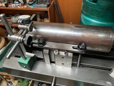

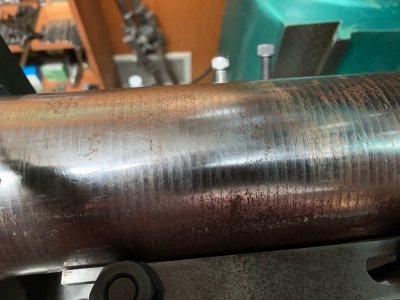

Hi All,

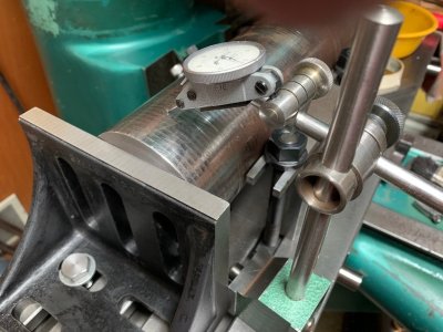

The results of my lobing setup. I used my largest v-block to set the bar in.
The results of my lobing check as I slowly rotated the bar. The indicator read 7 to 0 to -3 to 0 to 7 again. Is this indicating a lobe or was the bar just out of round by that much where I measured? The closeup photo of the surface of the bar looks to be rubbed in a thread like pattern. You be the judge. That out of roundness would certainly have caused the bar to walk.

Is there a particular reason you dont want to or cannot just skim the OD surface to remove any irregularities?
Hi Peter,
I could have if I had realized all of the difficulties which came up but now that the centre's are in on both ends of the bar, the bending head has to be machined all over to come to its final form. If you have the drawings, you will see the enormous amount of material which still has to be machined away.

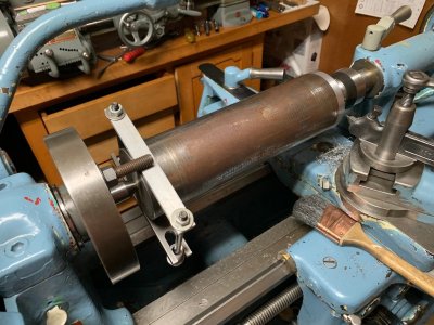

Hi All,

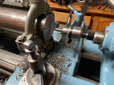

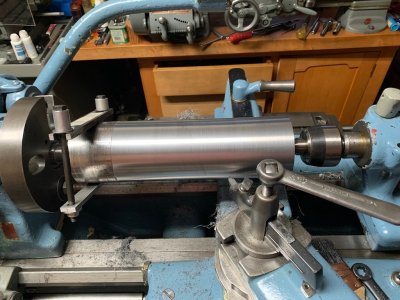

Making the first skim passes.
The old girl can still turn out excellent work if you know how to treat her. But the bar seems to be made from free machining (leaded) steel which produces a ready turned fine finish. There are miles to go yet as I have to turn down the bending head stem to just around 1.5" from 3.5" over the turned section seen. There are a barrel of chips already and I have just barely started.
I had to make the Rube Goldberg drive dog for this bar as seen in photo 13. I did find a commercially made 4" capacity drop forged lathe dog on ebay but it weighed 10-12 lb. alone and the shipping was too much. I had to modify my creation and mill a partial recess into the aluminum top cross bar where the threaded drive pin can now sit down into as otherwise the driving forces skewed and unbalanced the cross bars and they nearly flew off the bar. I saw it and caught it in time but live and learn. There is no such thing as an unimportant little detail.

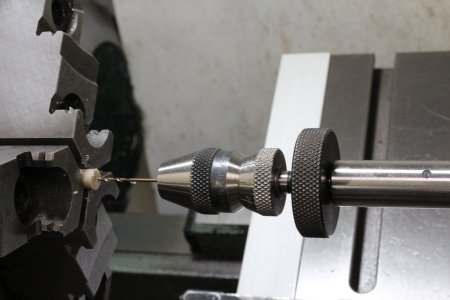

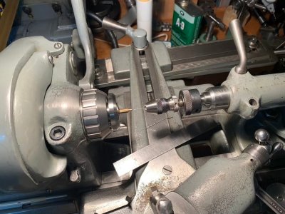

Hi All,
Going from one extreme to the other.

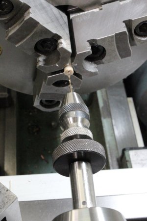

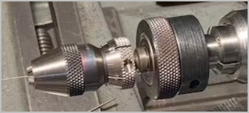

I just finished drilling the first steam jet with a #80 (0.0135"dia.) HSS miniature jobbers drill. I was amazed at how easy it was when you have all of the right (but expensive) equipment. No problems were encountered at all.
So, the changes made. I am now using a dedicated 3/16" hex. 3C collet instead of previously holding the 3/16" brass hex stock in a 3 jaw chuck. I am now not using the SB tailstock hand wheel feed to drill at all but rather the spring loaded Albrecht fine drilling assembly which consists of the Albrecht micro drill chuck itself (with integrated micrometer) and the spring loaded drill chuck carrier. These are two separate units which may or may not be sold separately or as a complete unit (I have seen it both ways advertised) but this one came as a complete two piece assembly. The drill chuck assembly itself is set in a MT2 collet having an internal straight bore of 1/2" to fit the tailstock taper and the chuck carrier.
When drilling, I did not use the micrometer feed on the drill chuck itself, only the spring loaded carrier to move the drill. With this sensitive setup, one can feel when the drill is at the very end of the hole and is starting to drill. I used peck drilling to feed the drill and a very fine pointed artist brush to clear chips from the flutes of the drill. The #80 drill is so small, fine, and delicate, one cannot be brutal here, one has to be very careful when handling the drill and centering it in the drill chuck.
The SB lathe was set at its highest speed (about 1200 rpm) which is only about 4% of what has been stated here it should be run at but I didn't encounter any speed problems when drilling but one has to use the right technique which is:
With the tailstock locked to the lathe bed I used my right hand to hold the black ring nearest the tailstock to maintain some tailstock seating pressure at all times while at the same time my left hand gripped the knurled ring (which is the sliding spring loaded part) adjacent to the black ring to feed the drill straight forward without turning. When I could feel slight resistance at the bottom of the hole, I would peck drill two or three times before withdrawing and cleaning the drill. Use only a slight increase in hand pressure when peck drilling (don't force anything, let the drill do the cutting) and move the drill forward and backward slowly but steadily. The spring loaded carrier makes this very easy without shake and any side movement.
The depth of drilling and drill stick out was set from a graduated scale such that I just drilled slightly deeper than needed when the end of the drill chuck nearly touched the end of the workpiece.
