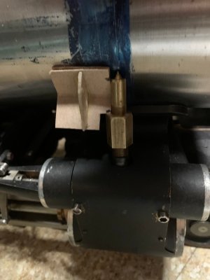

Hi All,
Spotting the downcomer pipe locations through the smokebox shell and glueing the cardboard aligning piece in place.
You will see in the next installment what an oblique angle one is faced with. You cannot use a regular drill here, it has to be a short and stiff center drill and short and stiff end mill(s) to make the openings.
The two black inked marks on the cardboard aligning piece are the two places which will define the angle which the centre drill and the end mill(s) must follow as they are on the centerline (at 1/2 the diameter of the locating piece at these points). Any cutter needs to be at this angle and offset from the curved shell at 1/2 of their diameter also to have the opening remain centered and coincident with (and not offset from) the original punch mark. Tricky.
to be continued.
to be continued.144 Opening Location on the Opposite Downcomer Steam Line.jpg146 The Cardboard Aligning Piece Glued in Place with Aligning Marks.jpg

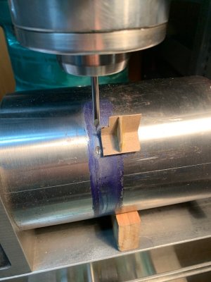

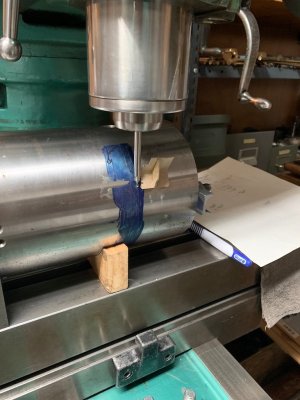

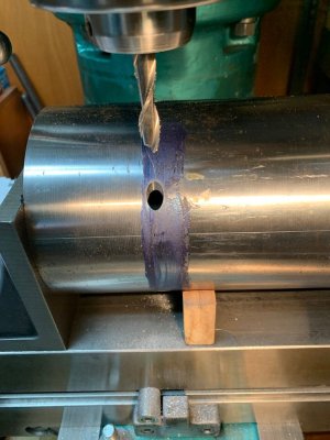

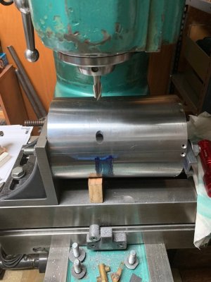

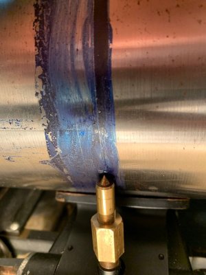

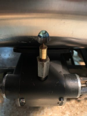

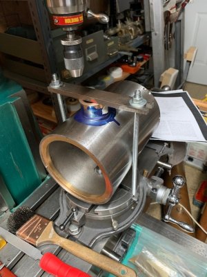

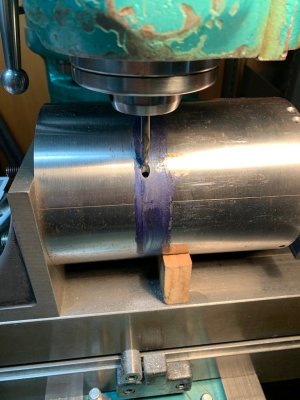

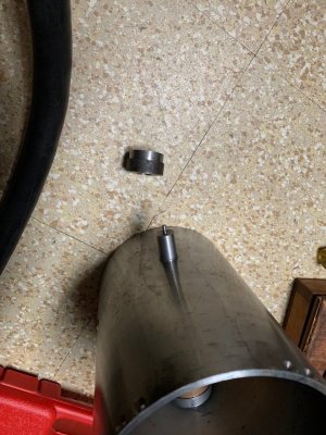

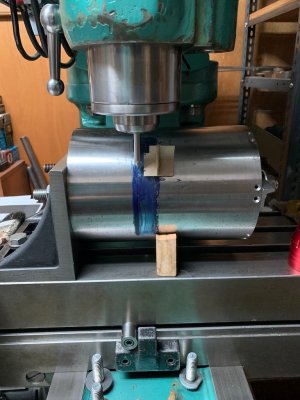

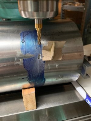

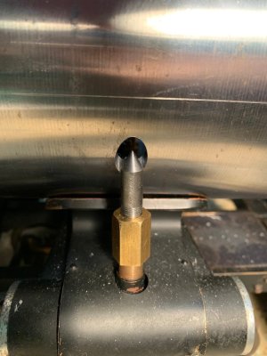

Hi All,
Proceeding to machine the oblique openings through the smokebox shell.
The setup to do this is shown in photo 147. Ensure everything is bolted down tight against the angle plate and cannot move at all.
The through point location on the smokebox shell always looked wrong to me so everything was checked several times before any machining was attempted.
One has to create a small flat first on the curved outer shell to be able to use the extra long centre drill to make the initial break through on the shell wall. Use a very sharp small centre cutting end mill and advance the cutter very slowly and carefully. Once the initial small (3/16") through hole has been created, the cardboard aligning piece can be removed. All cutters were held in collets with the minimum extension one could get away with.
Then continue to open up the opening to its final diameter of 7/16" in small increments and plunge through very slowly using very sharp (extra long end mills if needed) two or four flute end mills. Both types will work equally well if they are sharp.
It all looks so easy from the photos but it is a very tense operation particularly at the beginning.
I also did cheat a bit. No trusting myself, at the 5/16" diameter opening stage, I marked the location of the shell on the angle plate and removed it entirely to test the hole location and angle with everything bolted in place on the chassis of the locomotive. The angle was perfect but I did have to adjust the longitudinal position of the opening a bit to have everything dead centered. Returning to the mill setup, I used a ground piece of 5/16" bar and the locating maks previously made to "pick up" where I had left off and then make the slight horizontal position adjustment.
The result, a perfectly centered and aligned opening (photo 152).
Was I ever relieved. I still have to do the other side but the procedure is exactly the same.
to be continued.
Hi All,
The second steam downcomer opening through the smokebox shell is now finished and it came out perfect as well but again I doubted myself. Halfway through the operation I said this doesn't look right so everything was marked and removed from the mill and set back on the saddle of the two piece cylinders, the smokebox shell locked in position and the downcomer steam pipe centre point on the shell and the cardboard aligning piece verified as to the correct angle when set against the custom made dummy pointed downcomer pipe pieces as seen in photo 152.
Then reassemble everything on the mill and the position and angle was exactly as before! I couldn't believe it. It looked wrong.
Just a few more notes to clarify things.
The custom made straight pointer in photo 153 is aligned to the two black marks on the cardboard aligning piece. These marks have been created when the cardboard aligning piece is set against the dummy downcomer pipe pieces as seen in photo 152 and when the cardboard aligning piece is glued to the shell of the smokebox. The end of the pointer picks up the layout punch mark which is the centre of the oblique opening. Also, the shell itself is rotated until the two black marks are 1/2 the diameter of the pointer or are on the center of the pointer thickness wise. Some fiddling is needed here to satisfy both these conditions. Then everything is locked. This will ensure that all of the subsequent plunge end milling operations are centered and located correctly (photo 154).
One further point and I am not certain if this is relevant or not.
The smokebox shell is clamped in the upside down position for all of these operations and the shell is also turned end to end when doing the opposite side. If this is not done I think one of the openings can be in the right position but with a reversed oblique opening but I am not certain about this. One has to think here about how each downcomer pipe comes from the cylinders and up into the smokebox through the smokebox wall. Think about this before cutting any metal.
to be continued.
  • 153 The Two Black Marks on the Cardboard Aligning Piece Must be at One Half of the Diameter of...jpg

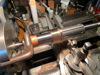

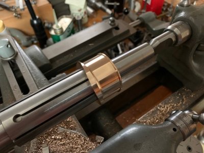

Hi All,

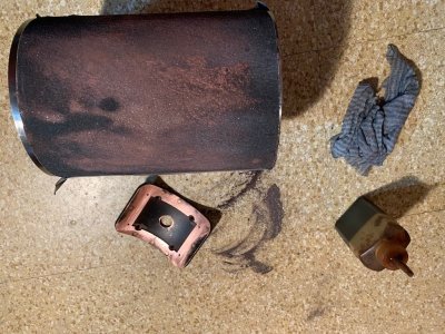

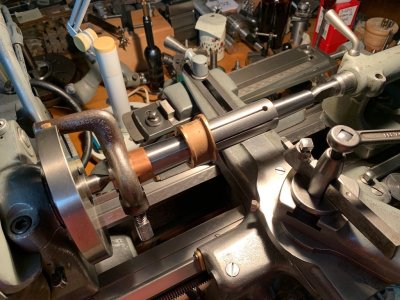

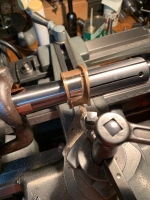

Am finally back to undertaking some finishing work on the stack casting. This operation involves profiling the OD of the stack with some very basic form tools to form the root radii on the stack upper and lower flanges. I can only do this by employing the fancy expanding arbor as seen in the setup photo (photo 157).
I had to proceed very slowly and take very light cuts as I left the casting only a light tap fit on the expanding arbor sleeve (with the sleeve left slightly recessed on the upper flange end) due to the fact that I also wanted to face across the top flange square to the bore and to the outer profile. Many times this resulted in slippage if I took too heavy a cut, so one had to carefully retap the sleeve/casting numerous times.
The other problem which resulted was chatter when forming the upper and lower flanges (the root radii) as the form tool starts to cut all around its profile. Sometimes, one had to resort to hand turning the chuck to eliminate this chatter using only very light scraping cuts with the sharpest cutter. This is where any looseness anywhere will come back to bite you.
to be continued.

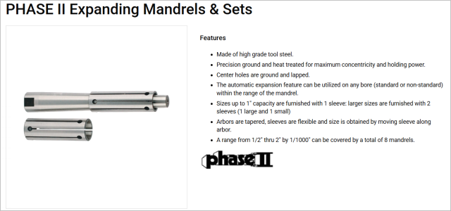

That turned out well.
I actually bought a single expanding arbor sleeve when I was building my radial, single because they are kind of spendy as graduated sets. Fuzzy memory but I'm pretty sure from KBC Tools. When I put a DTI on the mated assembly the runut was not very good, I'll say 0.003" just off the top of my head. I removed the outer sleeve & measured inner part, seems like it was about half. The enter drills looked unremarkable, re-mounted & got exact same readings. So something not right about concentricity relative to center drills. I maybe could hav edialed it in better with a 4J chuck but I think thats going outside their intended setup on centers? I returned it & have been kind of cool on them since. Now they do stock low level stuff too so maybe that was the issue. Anyway, what brand is yours & what kind of TIR do you get?
Hi Peter,
You got me on this. I simply don't know as I have not tested the concentricity or runout as this was the first job where they were used. Locomotive work, especially on something like this, does not have the same precision requirements as does IC work so if the runout was 0.003", no one will notice and it won't affect the operation of the locomotive. And yes, I could have had runout as I held the stack casting very lightly on one end of the expanding arbor sleeve. The sleeve was not pressed on hard as one could do if one was turning, say, a heavy IC flywheel. The stack part ended up being a relatively thin shell after profiling and I was afraid that I might split the casting if I pressed the expanding sleeve hard on the tapered arbor.
There is no name on the set which I purchased on ebay so I presume they are nothing special and from offshore but there was nothing obviously wrong when inspected visually. Everything appears to be hardened. The price was quite reasonable as I bought a set which was missing a size and yes, I have seen individual expanding arbor sleeves which were three times the price of what I paid for the entire set here (I received 6 out of a seven sleeve set). I do have sizes now from 1/2" up to 2" which will cover anything I ever expect to need.
I had the same experience with a made in India MT reference bar. The OD & taper was very accurate because of centerless grinding. But it was way off if registered on center pips. My thinking was they used the centers to rough turn the blank but bever utulized again for centerless grinding, so basically not intended to be used that way. Maybe the 'real' bars are different, I really dont know.
Back to expanding mandrels, forexample Travers only carries one line, Phase II, the house brand usually from Asia. QC kind of varies from totally acceptable to something less from my experience
The description says center holes are ground & lapped which I do not recall being stated on KBC line. Maybe an inprovement? But that could be then vs now or the offshore line they carried at the time. The outer sleeve is hardened so these are not intended to be skimmed in-situ. I think you get what you get.

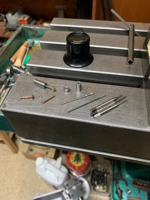

Hi All,
The start of my secret "riveting" process to rivet the stack to the smokebox shell. Only you guys are ever going to see this.
The first operation is to make a very close fitting (a tap fit) plug to fit into the blast pipe opening which is exactly opposite the stack opening in the smokebox shell (photo 164). This plug fits the shown centering piece of my rotary table.
The next operation is to make custom threaded rivets from commercial 1/16"diameter model engineering rivets. All of the special parts to do this (including the nuts) are shown in photo 165. The plain rivets are threaded 0-80 NF. It is quite a fiddle to handle all of these tiny pieces.
to be continued.

  • 165 The Custom Made Tooling Used to Thread the One Sixteenth Inch Rivets and the Rivet Nuts.jpg

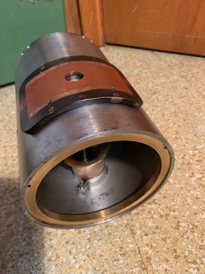

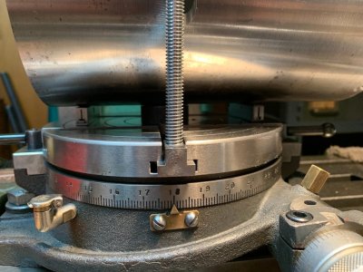

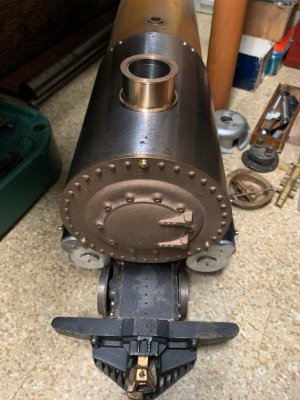

Hi All,
The smokebox shell as setup on the centered rotary table (photos 166 167). As you can see, I was pushing the limits of what my 6" diameter rotary table can handle.
I was just about to tilt the head of the mill a few degrees to provide clearance for the rivet drilling operation when I realized there was a big problem. This operation had worked fine on previous locomotive projects but it wasn't going to work on this one. I should have seen this much earlier but I didn't.
The stack bottom curved flange which sits on the smokebox shell, when turned from the casting provided, ended up being much smaller than on previous models due to a casting flaw which I wanted to get rid of. The resultant smaller bottom flange looked very good aesthetically, but then I realized the rivet drilling operation would drill into the stack liner itself making my "easy/practical" method of assembly/disassembly, if ever needed, not possible.
The Columbia design does show the stack "mechanically attached" as either a riveted or bolted assembly (no details given) but on a much wider flange.
So, as a result, I decided to go with the easiest alternative route of using a high temperature adhesive such as Loctite 620 on the underside of the stack bottom flange. This adhesive has a upper heat limit of 450 degrees F. which the stack will never reach but if it ever does then I am looking at silver soldering the stack/ss liner assembly. This adhesive also has the advantage of being listed as a strong sealing adhesive which the smokebox needs as there can be no leaks whatsoever of air into the smokebox. The smokebox needs to always be under a slight negative pressure when the locomotive is operating in order to draw the firebox combustion gases through the boiler tubes.
to be continued.

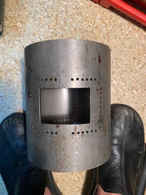

Hi All,

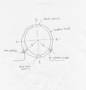

Next up is to attach the smokebox shell to the cylinder saddle with drilled matching holes in each part as seen in photos 170-171. These photos are taken from another project and are used here only for illustration. Photo 172 is a cross section sketch showing their location in relation to other smokebox features.
Don't be fooled, this is one of the most demanding and intense operations one can get into as I will explain.
To begin with there is no way that these two parts can be drilled together. One has to first carefully lay out and drill the cylinder saddle bolt hole locations first and then spot each one through on to the smokebox shell so that each and every hole in both parts aligns perfectly. Not only that but one has to be aware of and perfectly align every other feature which has previously been machined into the smokebox shell. In my case I am also going to flush thread the saddle bolts directly into the smokebox shell, so the room for error, this way, is even smaller (just the clearance drill size on each bolt hole). I want to have as clean and clear a smoke box interior as possible. Why, because the smoke box shell will house the internal poppet multi valve throttle, the superheater header(s), the two steam downcomer pipes, the multi nozzle blast pipe assembly, the blower ring and blower piping, etc. and yet it is still necessary to thread one's way past all of these obstructions to be able to clean and brush out all of the boiler tubes and flues on a regular basis. It is a totally contradictory situation but every bit of clearance you can find helps. As you can see there is no lack of things yet to be made.
Not only that but in order to even begin this operation, I have to remove the cylinders from the locomotive chassis and their motion works, strip it down to a bare cylinder block, mark everything, then reset the bare block square, level and aligned in every direction on the table of the mill. This in itself is hours and hours of patient frustrating additional work. And you cannot make a mistake at any point in the process.
This is where preparation and setup is everything. I am in the midst of this at the moment so stay tuned.
  • 172  My Original Sketch on the Layout and Drilling of the Cylinder Saddle and Smokebox Shell ...jpeg

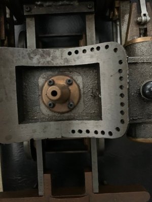

Well, this locomotive gave me a real surprise. And unlike what I normally experience, it was a very pleasant one.
When I began to look at how best to remove the cylinders from the locomotive chassis, I discovered it had a detachable saddle piece! Not only that, it is a complete one piece cylinder block unlike the normally seen two piece split half cylinders. I have not encountered this before so It came as quite a surprise.
This means that it will be very easy to attach both parts together with no fancy setup's or special aligning fixtures to make. And the remaining nearly complete cylinder assembly does not have to be removed from the chassis saving all that work and aggravation. Whoever designed this and had it cast this way (no easy task) was really using his noggin.
The only thing I struggled with a bit was to remove the four saddle piece flat head retaining bolts which were standard shallow slotted. Two of these fasteners were more or less destroyed getting them out so I replaced all of them with standard flat head cap screws as seen in the photo.

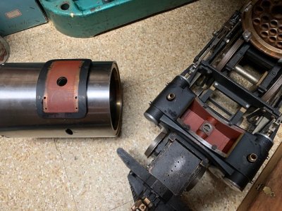

Hi All,

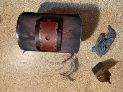

One final operation before the trial fitting the saddle piece to the smokebox shell.
The smokebox saddle piece was a close fit on the smokebox outer shell but I wanted it even closer without having to go through the entire setup process again.
I came up with the quick and dirty method shown in the photos. A piece of coarse emery paper was tightly duct taped around the outer shell and the curved underside of the saddle piece was translated and oscillated around on it dry. Very crude but it worked as the saddle piece now fits the outer curve perfectly. Just take your time and press lightly.
to be continued.

  • 194 Reverse Tapping Through the Smokebox Shell for Final Fitting of the Corner Attachment Bolts.jpg

Hi All,
After finally successfully bolting the cylinder saddle through into the smokebox shell, I could now proceed with all new construction without regard to first having to align the many existing smokebox shell features which caused so much grief. At least, that is what I thought!
I decided next to proceed with the blower ring itself. It has four blower ring jets as seen in photo 201. In the drawing, because it is enlarged, they appear to be quite straight forward to produce. Not so! They are tiny with the jet section of the blower ring itself being a drilled #80 drilled hole.
I have never drilled with a #80 drill before and all I can say is that it is a different animal. I have successfully drilled down to #63 holes but this is really different; one has trouble even handling the drill. To begin with no ordinary Jacobs type drill chuck can correctly hold such a small drill; fortunately, I have a 0-1/8" Albrecht chuck but even this is not ideal. Albrecht makes a special, super sensitive, design 0-1/16" drill chuck for these tiny drills and that is what is needed.
To compound the problem, feeding the drill directly with the tailstock hand wheel (on the 9" SB lathe as I had no other method at the time) is a no-no. I snapped the drill off when when feeding it this way even being exceptionally careful with peck drilling minute amounts and clearing chips. The drill jammed in the partially drilled hole and that was it - part scrapped. I know that one can alter the drill cutting lips on a stone to a zero cutting rake when drilling brass but try that on a #80 drill even under magnification. I was learning the hard way again.
to be continued.
#80 is 0.0135" or ~0.34mm. Have you tried tungsten carbide PCB drills? I find they work well & have a larger shank diameter which eliminates the need for a special (small) 3J chuck. Pecking is usually the way to do it but the real problem I see with a tailstock driven drill is if your TS is positioned left or right 0.001", that represents 7.4% of diameter. Most all TS are positioned high 1-2 thou unless you have taken yours down. Now add it any runout of whatever you used to hold the tiny drill & very rapidly errors accumulate & it usually ends badly. If you manage to get a hole, its probably not aligned to center or consistent diameter. That mat not be of consequence in this application if its ?pressure relief? or something.
