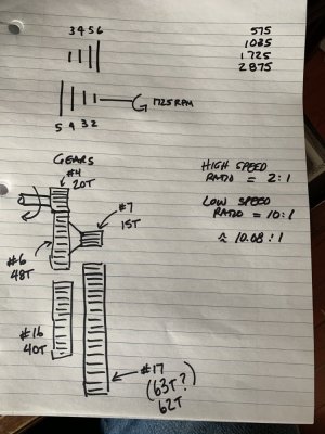

Hi Emery,
If you look at my post again you will note that I mentioned the 5:1 gear reduction you get when you switch from High Speed to Low Speed. Well I did not include the High speed reduction but here is a look inside the gearbox of the Utilathe (9 inch). When I wrote the first post I had reduced the inner gear reductions to a 5:1 but this pic should explain things better. EECF9EBE-D737-4B76-AE98-7C303D012F7D.jpeg
The 2:1 high speed reduction allows for the motor pulley to be larger than the 4321 and make it a 5432. So using @YYCHobbyMachinist pulley specs with the 6,5,4,3 on the spindle drive: that pulley drives a 20 Tooth gear connected to a 48 Tooth gear which in turn will drive the #16 40 Tooth gear when you are in high speed. the gear reduction is 2:1 so with a 1725 RPM motor you will get the speeds I put up in the top corner reduced to the high speed output: 575/2 = 287.5 , 1035/2 = 517.5, 1725/2= 862.5 and finally 2875/2 = 1437.5 RPM and the Slow speed will be the 15 tooth driving the big bull gear (number of teeth not listed but should be 63 (perhaps 62) to give you your slow speeds. The gear ratio is not a perfect 10:1 but around 10.08 to 1 so there will be a bit of RPM variance but close to 57.5, 103.5, 172.5 and 287.5 for your slow speeds.
Anyway, if you are seeking perfection the only way would be to make a custom pulley to get the ratio as close as possible. As @YYCHobbyMachinist stated "close enough" with a 6, 5, 4, 3...and that could be the original........

Indeed - but your best bet is to keep the pulley diameter larger so more of the belt is in contact. The 5432 is fitted to the motor. The 2 will be closet the motor. Then it’s a matter of what you want in the end for speed. If you had a perfect 1725 rpm motor and you were driving the 6” pulley 2/6 x 1725 = 575. In low speed 575/10.08 = 57 RPM
but say now you take a 1-3/4 / 5-3/4 x 1725 = 525 RPM
so this was part of my question - were the “original pulleys” dialed in to match the gear ratio’s to give you those speeds indicated on the machine? Or was close enough the mission?
if you go back to my original post I changed the drive pulley to a 4321 - well that would be “impractical” with a 1” as it may be too small for the belt to get a good grip. So you go 5432 as your drive then mess about with the spindle pulley.
in the total ideal world you would want that fist RPM to be 500 so you would get 250 and 50 with the gear reduction. That would take pulleys close to 2” and 7” giving an RPM of 492. The problem comes as the next ratio is not good for a 7654
3/6 x 1725 = 862 and is a bit slow. A better match would be 5-1/8” so you would get 3/5.125x 1725 = 1009.
