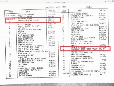

I'll measure my pulleys in the morning just to be sure. The Manual list the pulleys as a 64 and a 54 which I think is 6" 4 step and 5" 4 step.
I'll check that out, thanks
You have a manual that lists the pulley sizes?
No, I think Yota is referring to the regular manual. It’s list the part codes are SCA-64 and SCA-54.
Likely SCA-64 means 6”, 4 sheaves. Likewise 54 means 5” 4 sheaves.
Okay,
I did some calculations.
With the stock 6 inch (spindle) and 5 inch (motor) @1750 RPM
slowest speed in high range. (Should be 250 RPM)
1750 RPM on the smallest side on the motor pulley (I am guessing it’s a 2”) Going to the 6” ring on the spindle pulley you have a 575 RPM going into the head stock. (20T gear)
The high rang gears then goes to a 48T to a 40T (which is your main spindle)
575 x 0.416 (20T to 48T) x 1.2 (48T to 40T)
= 287 RPM. Close enough...
When I calculate my ratio in the same slowest speed in the high range option which should be 250... mine equals 405 RPM
Looks like I might have to go shopping for some new pulleys.
