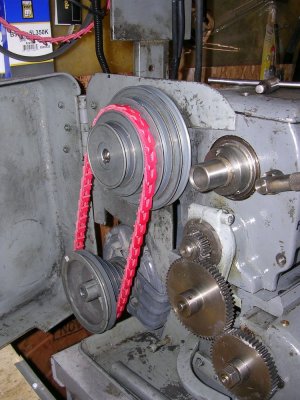

I got my belts at KMS, https://www.kmstools.com/a-1-2-link-belt-per-foot-134582, I used the "A" size belt as it was left over from another project.
When I'm done for the day I take the tension off the belt as well. I also remove the chuck, put all the controls to neutral and put the cover on but that's just me. I do woodworking as well in the same shop so I try to keep the sawdust of the machines.
Amazon is selling 5' for the price of 3' at KMS. The advantage to buying local is you know what your getting and you can have it now. The link belts are a bit noisier than one piece belts being able to get the size just right without having to buy another belt is so convenient.
I’m thinking about swapping out the B size belts on my mill for link belts. I’m fairly confident the originals are what’s on there now.
The "B" size is what is supposed to be on the SM but I had the smaller belt on hand and it works fine for what I'm doing. I don't seem to lose any grip and I'd rather have the belt slip than break something.
My mill has the "B" belts as well.
I have the red belt from Lee Valley, bought it for my small drill press and then sold it before I ever used the belt. Just bought the 4' length to get the lower price.

Ha..... these things do run a bit smoother... Got figure? Amazon - 5' for $36.
Things get even better if I add a link and let the motor rest on the chip tray. What does that tell you?
