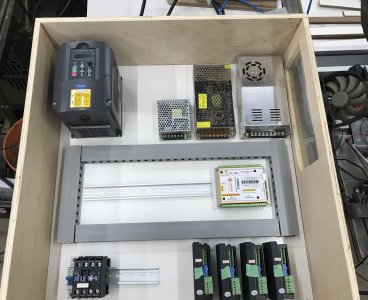

Dropped all the major components into the computer case today.
From top left:
VFD
12v power supply for control board
36v power supply for stepper drivers
(fan which will go above the power supplies)
Four stepper drivers
Control board
I will mount another fan on the bottom of the enclosure to blow across the stepper drivers.
Waiting on wire raceway before I can start wiring in earnest.

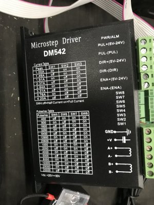

what brand stepper drivers does the aliexpress store sell?
I think I'm going to start making small purchases locally when I see deals. I'm also going to go with DIN mounted power supplies and make mounted for the stepper drivers. I have a bunch of DIN terminal blocks already
They seem like generic DM542 drivers. I know some folks on the Discord had issues with missing steps and had to replace the kit drivers with drivers from StepperOnline. I hope not to have that problem!

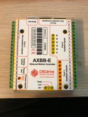

Well, I've had to make a direction change electronics-wise. Previously I was going to use a custom made grblHAL board and IOSender as control software. I've had many issues flashing the board, proximity sensors that work in the morning and then not work that afternoon without any changes to hardware or software.
So I decided to move to the UCCNC control software from CNCDrive and their AXBB-E motion control board.
It's proprietary which I have some nervousness about but there is a huge user base and the developers are very responsive.

Now it's time to start filling up the enclosure.

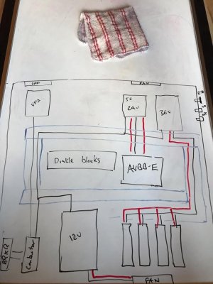

Here is a rudimentary (emphasis on rudimentary!) sketch of how it's going to come together.
From the top left VFD , 5v/24v power supply for the controller and limit switches, 36v power supply for the stepper drivers,
Middle is a row of Dinkle terminal blocks for power distribution and the AXBB-E controller.
Bottom left are 120v breaker, contactor, 12v power supply for the three fans, and the four stepper drivers.
In the top right on the outside are the e-stop, and on/off switches. There may be a potentiometer for VFD speed control. We shall see how controlling the YLang VFD via PWM turns out.
Stole a bit of time at the end of the day to arrange electronics.
I think this layout will work.
The only slightly awkward part is that the wires for the stepper drivers come out of the side of the control board that faces the power supplies. I put the control board on risers so I can run the wires underneath. If it looks messy I’ll just run them out the top and through the wire duct.
