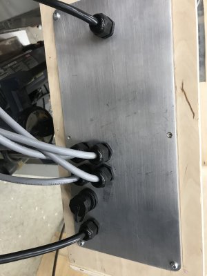

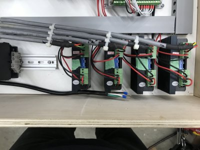

More progress on the enclosure today.
Stepper driver cables in place and secured.
All cable glands except for the limit switches are in.
Top is spindle cable from the VFD, then stepper drivers, Ethernet cable and power.

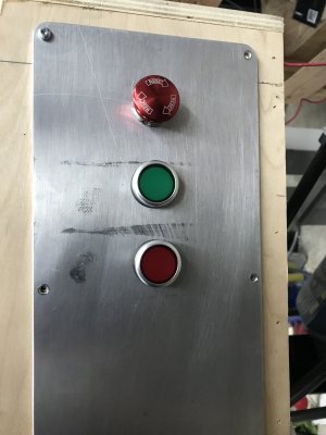

Estop and on/off switches are in and working correctly.

Nicely done. Very neat and tidy!
Thanks Dan. Lots of planning to get everything in and placed in a way that kept line and low voltage separate.
And I had to learn about contactors and latching circuits.
This project has been a tremendous learning experience for me. And I’ve not even started the actual design and machining aspect of it!

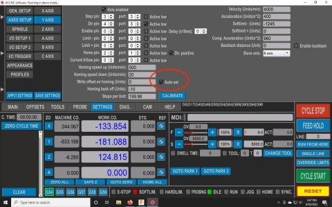

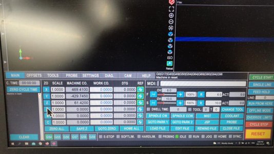

Had a big breakthrough with the UCCNC software tonight. I was struggling to get soft limits working. If I homed and then enabled soft limits I would get a message that a soft limit had been reached. Which didn't make any sense to me as the machine was at Zero on all axes.
Turns out that homing in UCCNC doesn't automatically zero the machine coordinates. There’s a checkbox on each axis to zero that axis' machine coordinates when homed. Checked them for all axes and entered the travel distances and now my soft limits work. Pretty darn happy about that!

I would never have figured out the soft limit thing had someone not explained two things:
1) that a different screen set was available that showed both work and machine coordinates at the same time. This let me see that homing zeroed the work coordinates but not the machine coordinates.
This is the screen set that I had to find. This is a shot after homing. Notice the Work Co. are zero but the Machine Co. for Y is -429.7450.
So when I enabled the Y axis soft limit of -264, the controller immediately said "Whoa there big fella, you're already out of bounds, you ain't going anywhere!" (or something that ;))
2) what the "Auto Set" checkbox did. As soon as I checked this box and homed the machine all the coordinates set to zero which allowed my Y soft limit of -264 work. (This is not a screen shot of my software but an example)

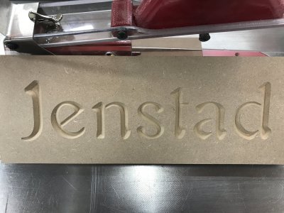

I tried out vcarving for the first time.
Went ok in my books.

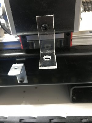

Tried using my corner finder today and ran into a bit of a problem.
When I tried to clip on the magnet that is connected to the DC0 I got a spark.
Eventually found a proximity sensor with an internal short sending 24v+ to the sensor body thus energizing the entire steel mass so connecting the DC0 lead was dead short and shut down the software.
New sensor is on it's way.
In the mean time I made a quick sensor mount out of acrylic to isolate the sensor from the frame.
