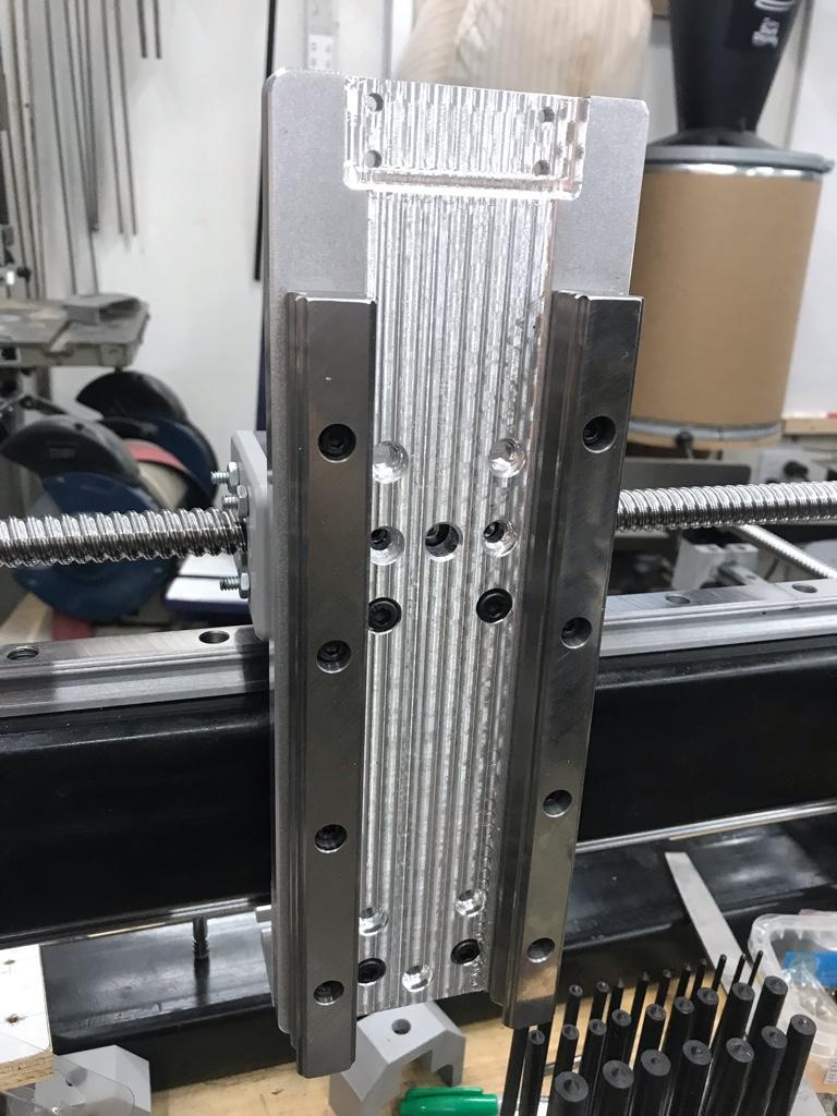

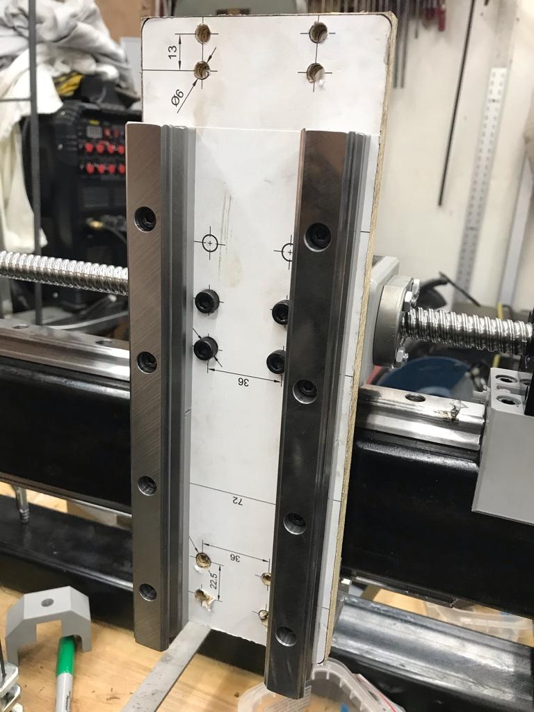

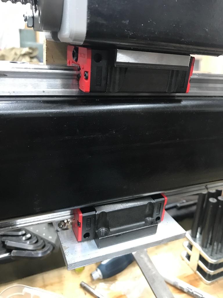

Got the X axis rollers done and the temporary Z axis plate made.
Need some more M6 hardware though.
It's a bit rough. The maker said his endmill was dull and feed rate was too high. I'm going to give it a pass with my 1" facemill.
Yeah, I had them made for me because I didn't have time to get the material and do all the machining.

Managed to secure the rest of the hardware to finish the mechanical build.
And...shocking no one more than myself, I managed to get the custom built, Teensy 4.1-based control board flashed with grblHAL and working with CNCjs and OpenBuilds controller software.
