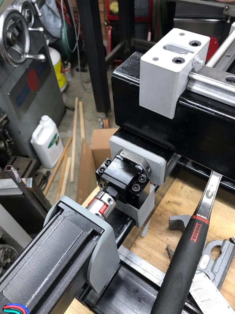

A minor update: I managed to get the frame bolted together. Went very smoothly due in large part to the excellent drill guides.
There are four 6mm x 10mm SCHS at each connection point for a total of 24 SHCS holding the frame together.
Next step is to locate and mount the Y-axis linear rails and lead screw bearing block mounts.
This is a screenshot of what I'm talking about. Arrows pointing to the lead screw bearing blocks mounts and linear rails.

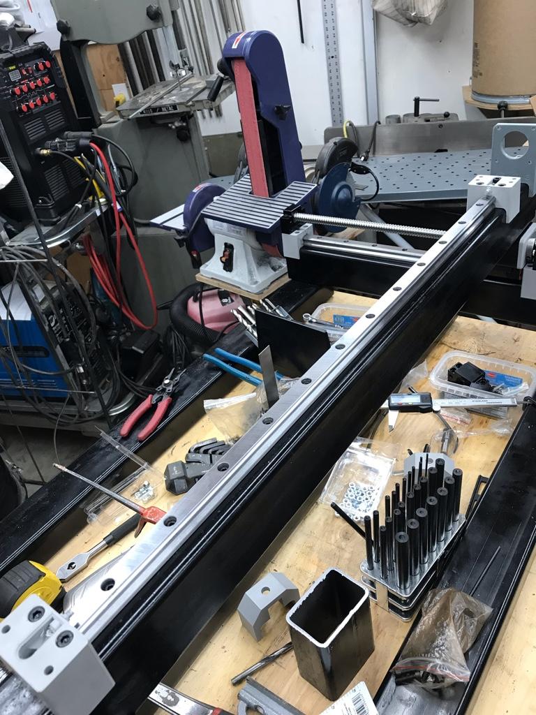

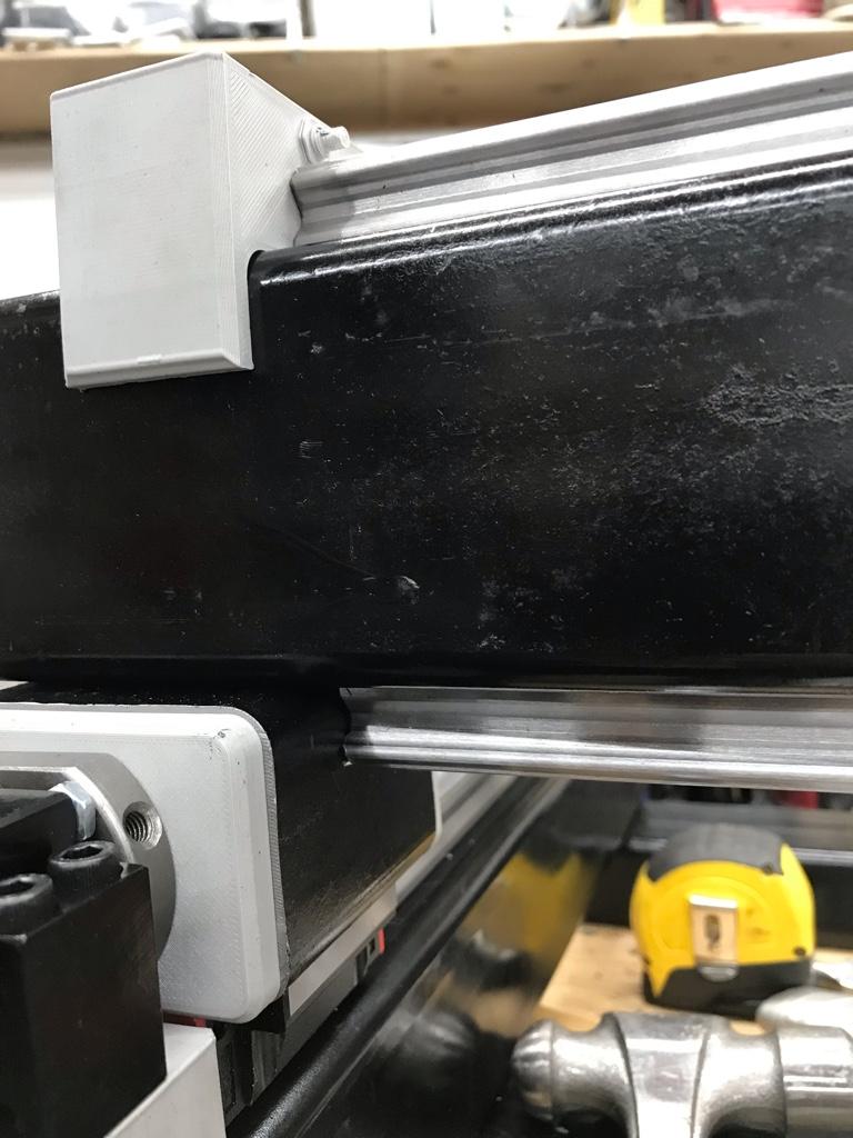

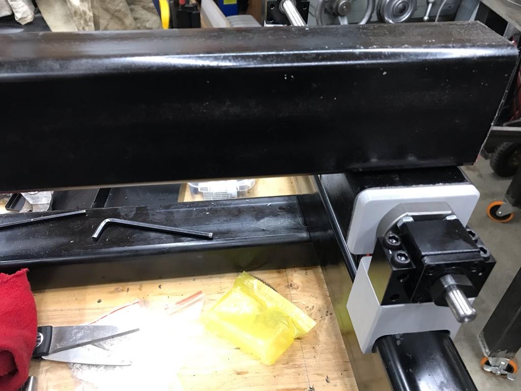

Good progress tonight.

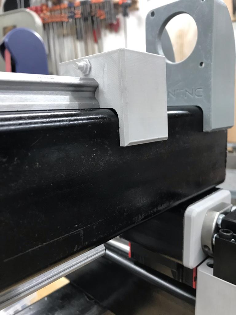

Got the bearing blocks mounted and the rails and roller slides on both Y-axis.
The pieces sitting over the rail are to centre the rail on the steel.
And the roller block in place.
Next I have to cut, drill and tap the steel risers that sit on the rollers and support the gantry.

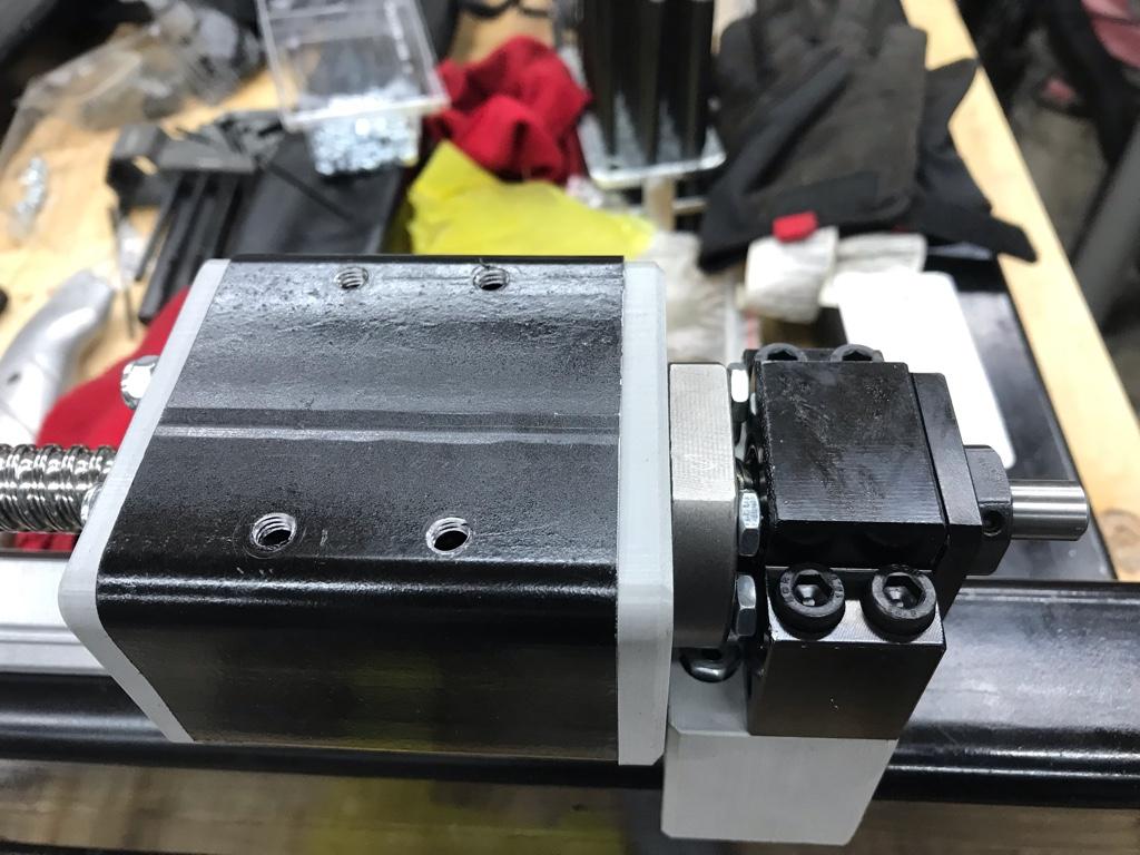

Today’s progress.
Got the roller mounts cut and squared up. Hit the 70mm length dead on.
Drilled to match the roller guides and tapped to attach the X-axis gantry.

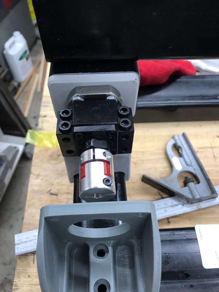

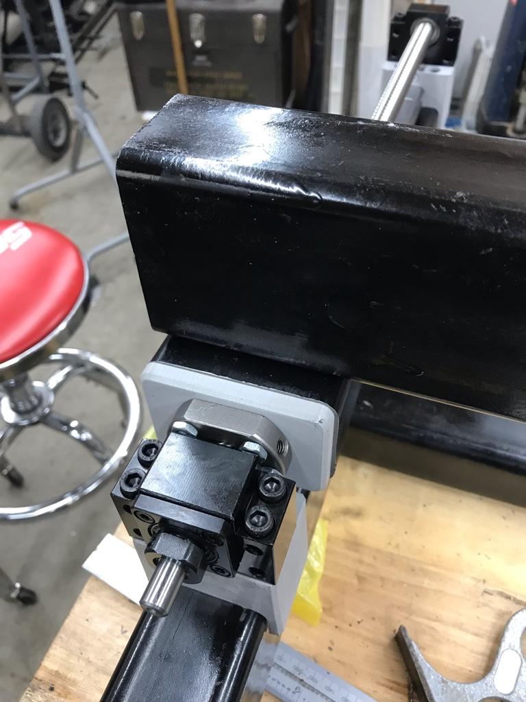

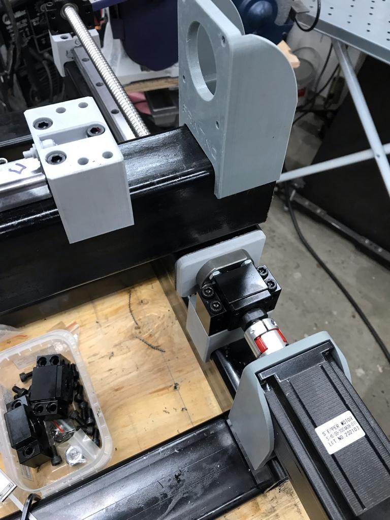

Got the ball screws in and the roller mounts on.
And cut the X-axis gantry to length and drilled the mounting holes. Still need to add the linear rails to the gantry.
The next thing to build is the Z-axis. It’s a complicated assembly so I’ll need to read the instructions a few times!

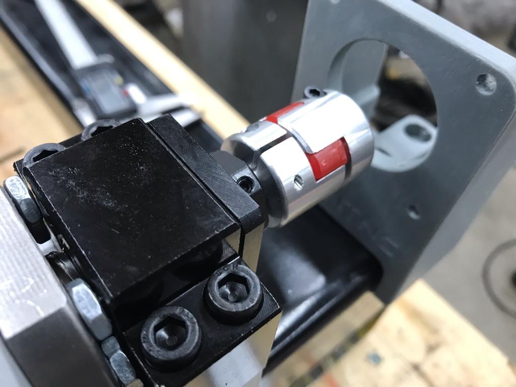

Tonight’s progress was mounting the bearing blocks and upper and lower linear rails on the X-axis gantry.
Lots of careful measuring and drilling. And tapping. Thank goodness for spiral taps!
