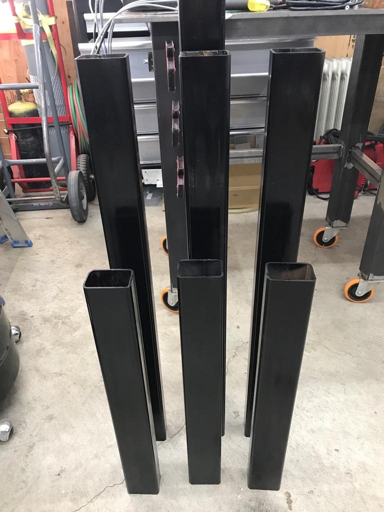

Another big step today.
Picked up the 2"x3"x.125 wall tubing and a roll of PETG 1.75mm filament for the 3D printed motor mounts.
Next step is to modify the parameters in the Fusion 360 file so that the radius of the 3D printed parts will match the steel.
Edit: modified the F360 file and downloaded all the assembly tool stl’s for printing.
Deburred and painted the steel today.
