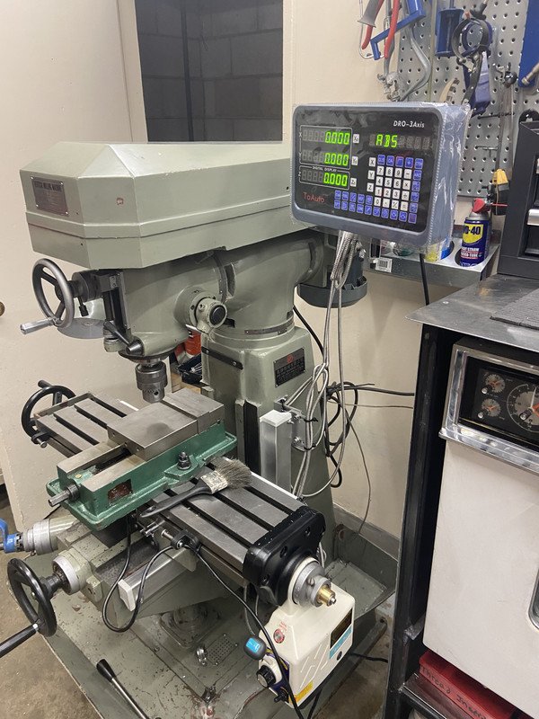

I have the same machine, very happy with its capabilities as my own capabilities are one step above newbie.
I did add a power drive for the table and I made a 2” tall spacer to raise the head mechanism further from the column, longer bolts were needed and I machined the spacer on my lathe with corresponding male and female surfaces to mate to the existing column and head gear components. The spacer increased the clearance between table and quill so my Vevor indexing / rotary table has working clearance.

I also added a 3 axis DRO, a great aid for my very basic capabilities, cheap on EBay and pretty easy to install.

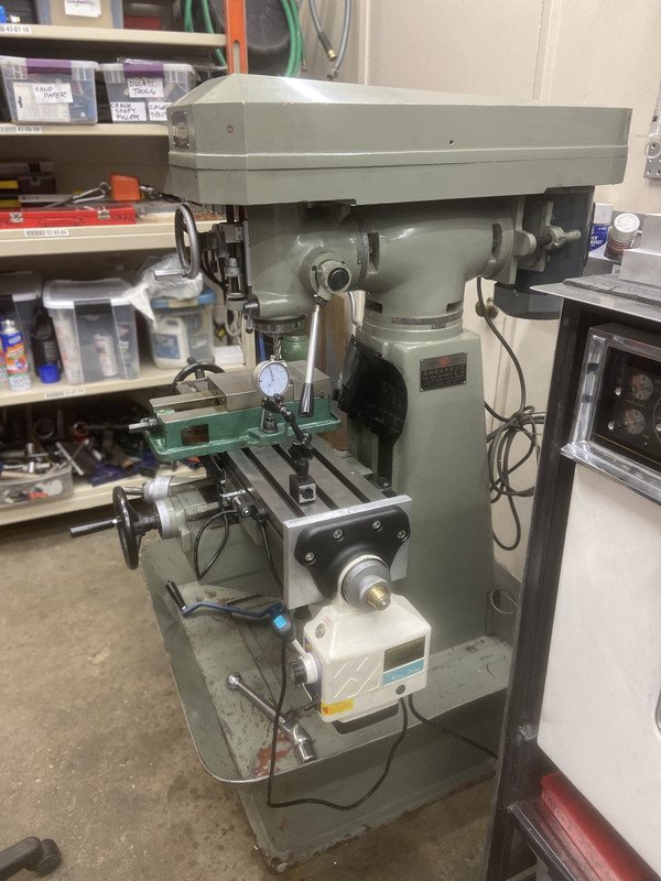

Some old pictures I have of my mill before I added the column spacer. For the Vevor drive I started with a 1/2” thick piece of aluminum bolted to the end of the table.
Then I shaped the aluminum adapter to match the Vevor drive.
I had to shim the brass bevel gear that engages the table lead screw, made an extension to the end of the lead screw, a bit of back and forth to get it to run smooth but the Vevor is a fraction of the cost of a Busy Bee, I have had it for at least four years now.
I want to add a separate DRO for the quill itself.
I have also added a LED light on an adjustable arm on the right hand side and made a heavy mobile base from steel tube with castors and leveling feet.
I keep picking up tooling as needed, collets, boring head etc.
