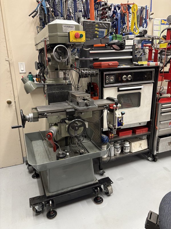

Mill arrived

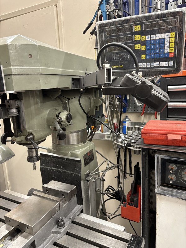

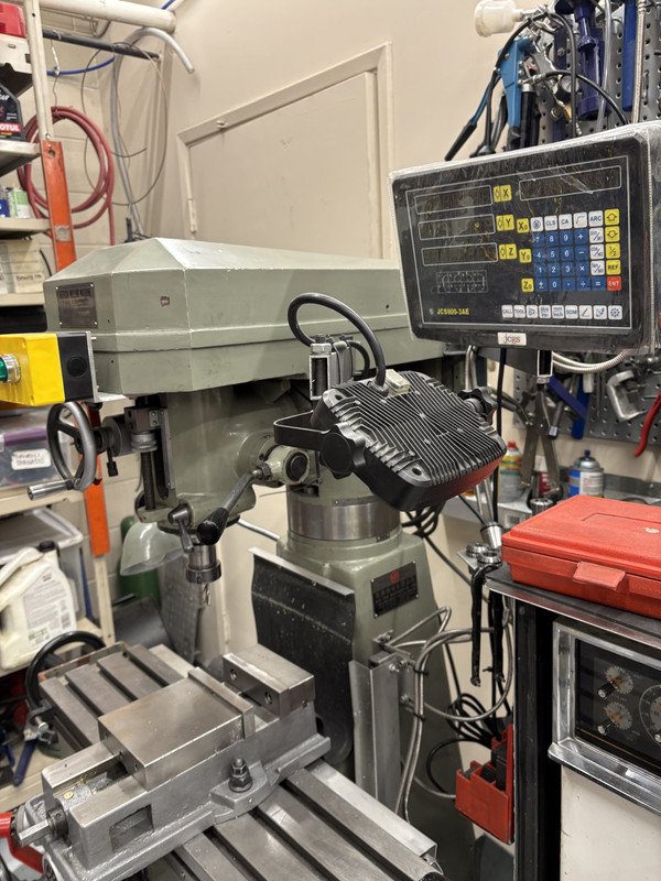

Is your dro glass scales or magnetic, BTW, right on,
I have the cheaper glass scales, for my capabilities they are fine, I think the whole setup cost me under $500 off Ebay with shipping.

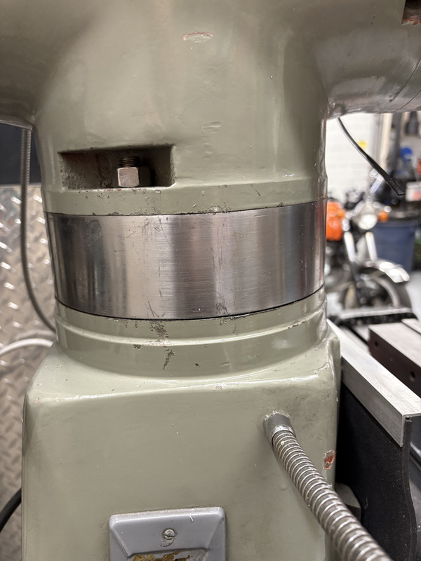

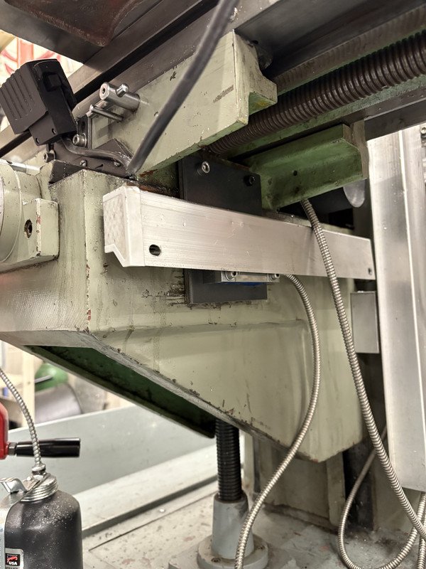

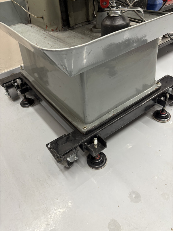

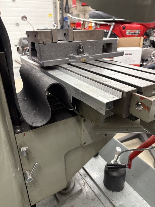

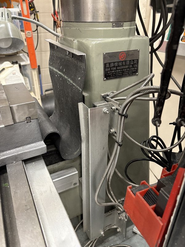

I added some pictures of the steel spacer I fitted between the column and head assembly, the rolling base I welded up from steel rectangular tube, castors and leveling feet, and the DRO setup.
If there is anything you need more detail on just ask,
cheers
Jim
That's great Canuck750, I never thought to add a riser when I owned one of those machines. When I bought my 3/4 Bridgeport clone I ended up making a mold and casting one for it from ductile iron.
GREAT PICTURES, it's good to close ups as to where things can be placed, ie, dro scales and so on, it's kinda like cheating.....
So here in lies a problem, is the casting on your machine the same under your scale? It appears your scale mounts are fairly far back, any thoughts.
Cheers..

I think the castings are the same, I remember there were challenges with making the brackets for the scales and pickups. The column itself is tapered on my machine and the vertical scale brackets were a pain.
I actually just found the same mill different name on it with pics of standoffs and how it was rigged. This is all pretty exciting stuff, 😉 can't wait till the snotty weather to start flying, the shop is a calling.
