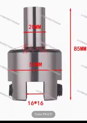

Now that you have a mill...you can definitely make some of the tools you'll use...
One of my next projects is a fly cutter...and the best part is you're using your tools to make tools!Screenshot_20250810_130931_AliExpress.jpg
