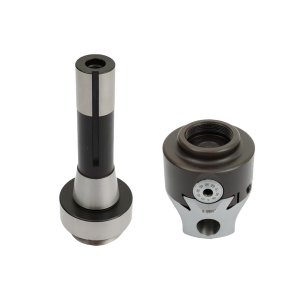

So I order a boring head, inserted it and put a dial indicator on it after watching it wobble around like an egg visually, any suggestions on an accurate boring head, this is the one I ordered, link below.

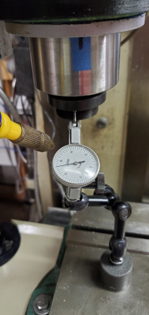

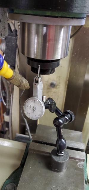

So, where the collet screws into the head, the collet had a real visible wobble, then I indicated the head itself and it appeared to compound the issue. I also thought crap is the quill out on this new machine but it was spot on. I cleaned the inside of the quill for any factory goo in there and checked it again but came out the same. then for giggles I inserted a boring bar and indicated the boring bar shaft ( the part that goes into the head) and chased the boring head scale around for a bit to see I could get it to run close to true, that was an exercise in frustration.
'the collet screws into the head' - I don't have a good mental picture of what that means. Do you have a picture or can you describe it more?
It is almost impossible to use a dial on the end of a bar, you need scrap stock and make a cut. Then measure the cut
its a two piece unit, I indicated the collet first the shiny bottom part a real visible wobble, that part alone was 15thou approx

that looks like it fits into an R8. Then the tool comes in two parts. The picture is unclear about how they attach together, but the tool itself doesn't have a collet
unless the R8 surface is very bad, probably the tip will cut a good circle. a scrap test piece is the best test I think

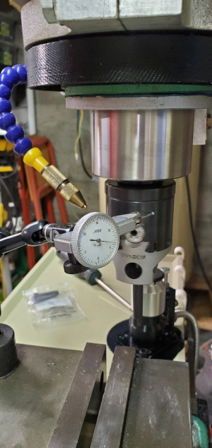

One thing to test is this:
First install just the holder and measure runout, horizontally and vertically.
And the seating surface underneath.
Then screw on the boring holder and see how much it deflects.
My holder was less than 0.0005 horizontally and vertically. However the boring tool holder moved 0.0095 radially. But then since the cutters are also adjusted radially it shouldn't make a difference since we measure the board after the first pass and then adjust the screw to increase depth of cut.

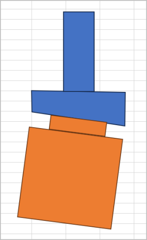

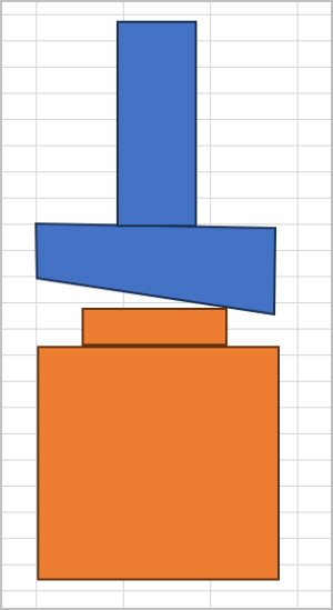

I would take the time to blue the R8 taper area with a Sharpie marker, snug the draw bar & see if it shows any abnormal contact. If they got the angle wrong then its going to sit cocked & be different angle every installation. If the R8 seat is acceptable, measure where the wobble high/low/whatever on both the arbor flange & the boring head. If runout is repeatable then likely the arbor was machined incorrectly assuming your boring head is OK.
Here it kind of depends where the issue is. Left = arbor threads are in line with spindle, resulting in more like tangent point contact on the boring head vs flush faces.
Right = arbor threads are cocked like the flange face, which means your whole head will oscillate.
but a bar held in all of these various eccentric positions still describes an exact circle. As exact as the quill. The scale on the boaring head won't be accurate in terms of dimensions, but otherwise there won;t be any issues

NAILED IT, that is exactly what I did, 15thou or more runout, wobbled like an egg, small exaggeration but yes..... got worse on the boring body.
