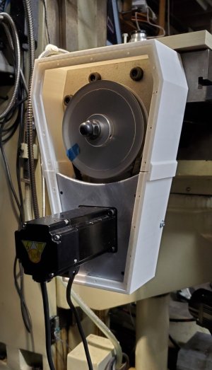

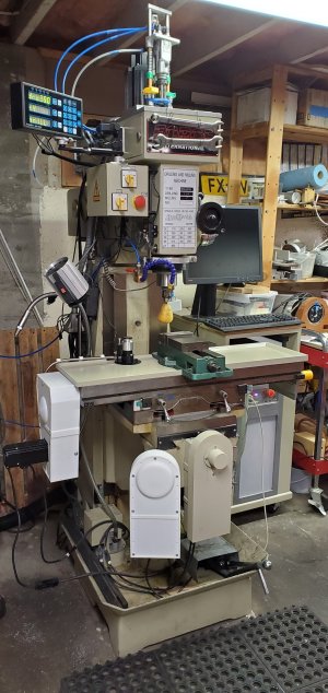

The paint has cured enough that I can at least put the covers on the Y axis. The X axis is still a work in progress. Rather than print 42 renditions of the bottom part of the X axis cover I think it will be easier just to mill the motor mount casting to the correct dimensions. Leaving it as cast was fine but now it's too wide to match the back casting.

Thanks. Looks like that paint was discontinued in January 2023 so finding some sort of chemical that could accelerate the curing process is likely not going be available. Nothing else will get painted until everything is ready to be painted. Then just leave everything for the requisite 10 days or so and do something else. Like go on vacation...
Or be like me - paint it in the spring and I won't usually touch a machine tool until late September - its just the way the summers go.

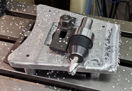

I thought I had it clamped well enough. Probably did. But without flood coolant the feed was too high for the 4 flute bit and slotting. Did fine on the two edges and then I had to hit E-Stop. Picture is worth 1000 words.
Ouch! That hurt!

I was so careful. Clamped and blocks underneath.
Probe the hole several times after homing.
Edited the G-Code to not start spindle and changed travel clearance.
Set Z=0 to 2" above and did a dry run to make sure i had clearance.
Enabled spindle and reset Z to top of casting.
As it was doing the back side and the WD-40 vapourized I thought "Maybe I should slow the feed a bit".
Well 25 ipm was too fast. The air jet wasn't on enough. Slotting with a 4 flute in cast junk aluminum not a great idea.
Melted metal stuck in the flutes.
I put a feed speed pot on my control board, and I use it a lot. Probably the most used control of all.
Agreed four flute mill and aluminum not a great combination. It always seems okay until it's not.

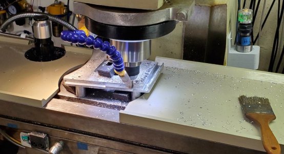

Alright. Status report time.
Making progress with the two flute 3/8" end mill and 5 IPM still at 2500RPM spindle speed. Air on harder and I could actually use the shop vac to suck up many of the chips. Nice too, how the table covers fit since this piece was smaller than the vise base.

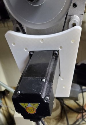

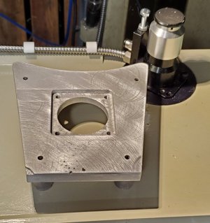

Now why am I doing this? After about 3 tries at a 3D print cover for this lower half I realized the real problem was that the casting was just a tad too wide and when moved down to tighten the belt made things even worse. So a narrower and shorter motor mount makes the original cover suddenly fit perfectly. Here's the completed one only a little worse for wear from the mistake.
But wait you might ask. If I'm using CNC to mill this X axis motor mount how am I driving the X axis and how did I know the covers will now fit properly?
Easy Peasy. Just make a temporary motor mount.
Done! Before I paint all of them I think I want to 3D print a wrench holder that I've mocked up with wire. Especially since the paint takes so long to cure.

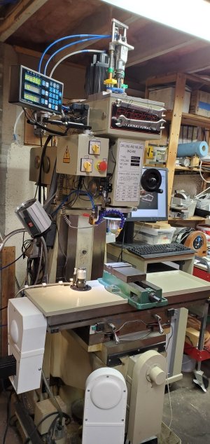

A friend told this about the picture of my mill with the completed belt covers:
Looking at the mill picture, I got a distinct feeling of a fully decorated Christmas tree .... and am thinking .... "and a partridge in a pear tree "
So I thought I'd oblige him and send him another photo more in keeping with that concept.
