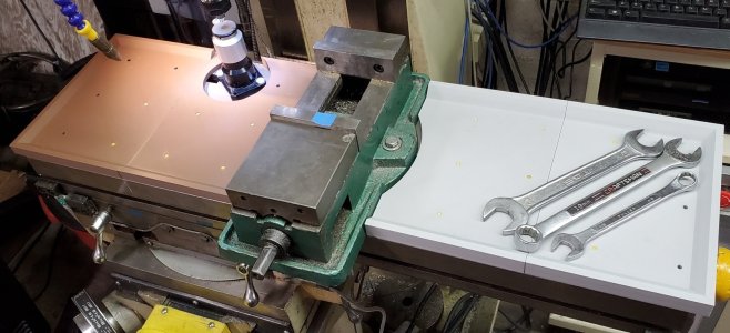

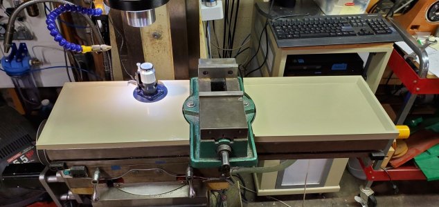

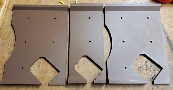

Finally got around to making some table covers to keep the crap out of the T-Slots. The tool height tester caused a lot of issues. First time, measured incorrectly. Second time too thick in one spot for the nut that captured the cable. Third time a nice fit but too far back so the T-Slot guides didn't fit.
Finally gave up and made a round spot for it. I can make a new insert now that prints faster and the angle of the rectangle isn't important.
For anyone who wants to make something similar here's the step files. I inserted a plane and then extruded/cut in either direction to create the half pieces. They just fit into the Bambu printer. The rails and dowels were printed on the SOVOL. The plan was also to make a rectangular insert that fit in the end of the mill table but instead I have a hole in the end of the rail and I can just insert a bolt that presses against the end of the table.
Once I create a nice insert for the tool height sensor I'll glue the pieces together and prime/paint. Maybe an epoxy paint to deal with various coolants or lubricants.
Yes. Over kill....
The black insert now fits perfectly. There are three guides underneath that fit into the T-Slots. And it's now painted the same colour as the mill. Almost looks like it came with it. Although too clean but then the paint is still sticky so I have to wait a bit before I can make it dirty.

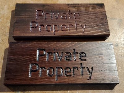

We don't want people stealing our small crop of pears so I thought I'd make a few Private Property signs on the CNC router.
Cedar. Top one cut first and then smoothed on the jointer. Took away too much of the letters. Second one joint the surface first and then cut the lettering.

A friend suggested I put a sticky layer of clear plastic on the wood and then rout through that. I have tried clear packing tape. Left granules of melted plastic that needed cleaning but seemed to work. I've sprayed that with red paint. When it dries I'll put down a layer of Varathane to cover the red. Then pull the tape and sand/stain the rest of the wood. See how that works.
I use blue painters tape.
