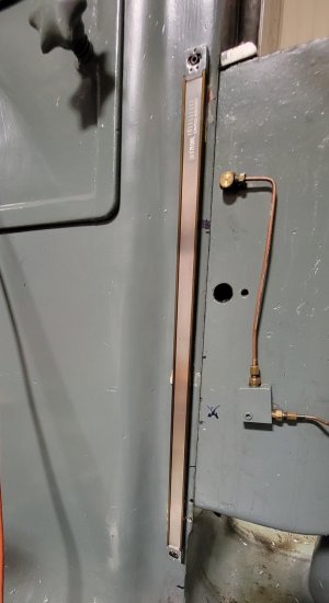

This morning I tackled the Y-Axis. Zero problems drilling the knee. Well, I say zero, but not really. It drilled with regular HSS just fine, but the casting was quite thin where I chose to drill it. Didn't leave much for putting a screw in. Perhaps worse, when I added the scale, I discovered that the knee had a convex surface where I chose to put the scale so I had to use the tiny little grub screws built into the scale ends - they are there for that purpose.

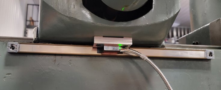

Anyway, now the Y Axis Scale is installed, levelled, and properly aligned.

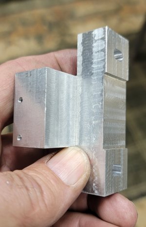

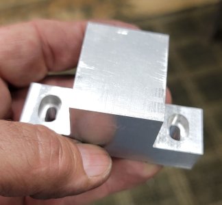

Next up is the read head bracket. The bottom of the table apron has a slight 10° slope to it. So I cut a piece of bar stock off with a 15 degree angle cut right into it from the git-go.
Now I have to figure out how to machine the rest of the features into the bracket piece with that dumb angle in it...... But I do get to use a working X-Axis DRO to help me do it!
You could always put some bondo or something like it behind it I just went with the screw adjusters.
I won't know for sure till I get the read head installed. I want to try and do that yet today.
If it doesn't work, I might put something like bondo or wood filler behind it. For now it tests ok.

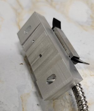

Finished the Y-Axis Read Head Bracket after working on taxes enough to keep the bride happy.
The back recess and 5 degree angle are to accommodate the slight contour of the bottom of the saddle below the right x-axis crank.
The one screw is slightly hidden by the sensor cable, but I figured it was more important to have the screws line up than it was to have perfect access. There is plenty of access there for an Allen wench. Besides, the bracket can be mounted before the sensor is attached if need be.

Here is the finished install.
Just need a cable relief and I may do a shield.
I definitely discovered that the magnetic scales do not like swarf. You can even see the 2mm magnetic pitch!

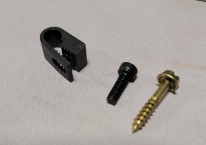

A while back, I bought a bag of cable clips to run Ethernet cables in the house. With modern WiFi, that was a waste.
But if I replace the wood screw with a machine screw, I should be able to dress all the cables and provide strain relief very nicely. The DRO cable is bit thicker than Ethernet cable but the clamp is adjustable enough to hold it just fine.
More drilling in undrillobillium..... o_O

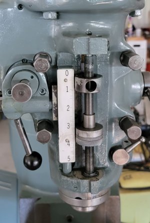

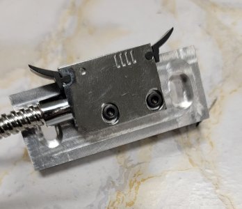

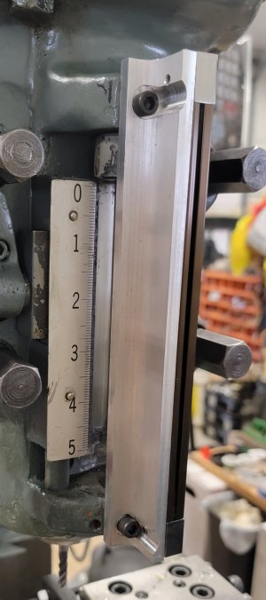

Well, it's time to install the 4th (quill) axis on my Hartford Mill. I've taken months to get to it cuz I couldn't come up with an ideal design. Hartford would have fired me if I worked for them. A guy I worked for years ago once said: there comes a time in every project when you have to fire all the engineers and get on with production. Engineers are perfectionists and their own worst enemy at times.
So many compromises:
Access quill stop adjustment
Quill Scale Visibility
Rigidity of scales
Rigidity of sensor
Repeatability
Clear of quill feed wheel
Clear of Turret Face Lugs
Signal Cable Folding

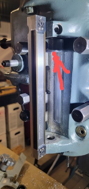

Well, I think I have it nailed.
Here are some before and during photos.
The read head will go on the quill indicator (see red arrow) in the photo below.

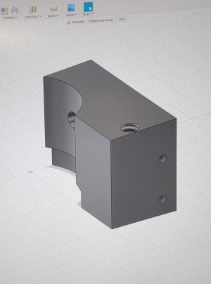

The Mount will look like this:
Please note that I'm standing on the church steps naked with this photo. It is the very first Fusion 3D solid model I have shown you guys. Please be gentle......
The threaded hole on top is for a 5/16 post to provide strain relief for the cable. The sensor attaches to the two small threaded holes. The hole in the curved surface is for a 1/4-28 screw to hold the fixture to the quill indicator. The bottom relief is to let the quill stops turn freely.

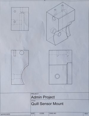

I also did my first shop drawing from the 3D model. Wow! Now that's a cool feature !!!
I'll prolly always do crude drawings right out of my head just because it's easy for me, but Fusion is so much more professional looking!

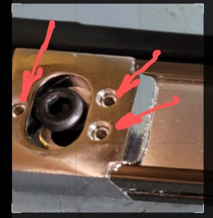

My scales actually came with integral jacking screws for that purpose. If you look at the photo with the red arrow on it, you can see the three jacking screws on each end of the scale.
I guess for anyone who doesn't have magnetic scales, you might not have even noticed that the scale was actually already mounted in the photo.
I can't really check axial alignment till I get the sensor mounted. But another advantage of magnetic scales is relative insensitivity to alignment. In my experience, they will work relatively well with a misalignment (gap) that varies by about a 1/16 inch. Of course, I will shoot for whatever minimum axial and gap misalignment I can achieve.

You might want to look at earlier posts on my DRO install. I previously mounted the X, Y, and Z magnetic scales on the table, saddle, and knee of my mill.
But my Readout box has the ability to combine my quill with the knee to provide a total Z for both together.
So I am now mounting the quill scale on the quill. Again, if you look at the photo with the red arrow, you will see that the magnetic scale is already there. I just need to machine and mount my quill adapter for the read head (which is what is shown in the drawings). It might take a few more days owing to other family related priorities. But it's within striking range now.
