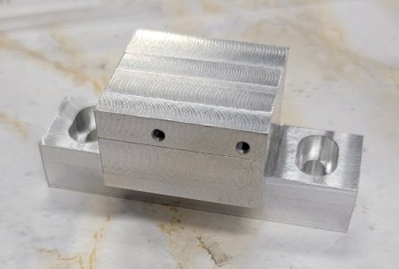

Well, Carbide cuts the cast, but like a snail. So I took a diamond burr as per @whydontu 's suggestion and cut away about a 1/16 of an inch of skin. Then re-applied the carbide drill. THAT WORKED! It was still slow going, but not so slow that I wanted to quit.
At 5:15 I was tapped and ready to attach parts. Here are a few photos.
I made a custom X-Axis read head bracket:
The assembled and installed X-Axis scale looks like this:
