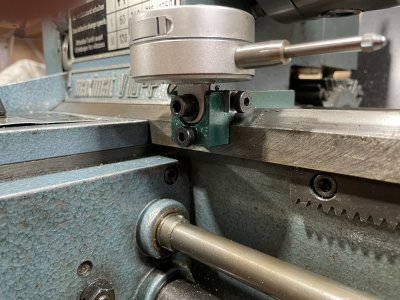

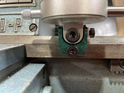

A better way to retain indicator stems is with a slit & perpendicular clamping screw. No sense distorting or denting the barrel tube. Maybe that was the intent of brass, but pressure is pressure. If it was a Princess Auto dial I may have stayed silent, but a $ Mitutoyo... I was obliged to speak up :) Actually I should have sketched the slit extending further back which will reduced the amount of screw torque required

V4 of the lathe stop... I will look at indicator later as an addon option.. and BTW, Fusion fasteners are GOOD, even though this was imported back into NX.. better than having to download from mcmaster carr
Nice tidy little stop.
Need to add a micrometer spindle to the stop and a mount for a dial indicator. I'm not sure if the latter should be a split sleeve like @PeterT drew or a tang holder for a back mount indicator. I have mixed emotions.

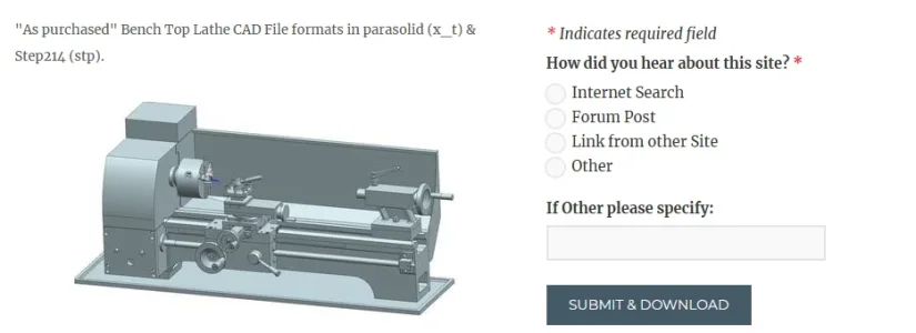

https://www.wadeodesign.com/cnc-lathe-documentation.html The Grizzly G0602 is essentially identical to my King KC1022. When I decided to add an ELS I went looking for existing CAD files and found his.
Thanks Gerrit. I poked around a fair bit and ended up at dead ends. But I wasn't really expecting to hit pay dirt so it's no biggie. Nothing ventured, nothing gained!
I'm not about to create it myself.
Thanks again. It was worth a try.
LOL, yes that was the intent of the brass screw. Maybe in version two I’ll use the slit method which I agree is nicer on a nice dial indicator.

Yes, it looks like some sort of heavy duty thimble so you can fine adjust the stop.
If you need a better photo of it let me know.
Thanks. Better photo isn't required. Not sure I want a solid stop anyway. I prefer a dial indicator stop without a hard stop.
Maybe combine all these ideas... I have 2 weeks off... Why I like hard-stop as opposed to micrometers and indicators is... you have a compound with graduations on it... and depth mic, or Vernier so these other things seem redundant to me... but that's my preference. Remember, I used to do short run production .. say 10-30 pcs / run... also the Colchester had a multi position carriage stop setup as shown..
On that page scroll down to this section and answer the question, e.g. forum post. It will then download a zip file that contains the .step of the lathe.
Sorry @gerritv, as usual, my post wasn't very clear. I found the download for that lathe. But I was looking for the file for MY LATHE which is a bigger grizzly lathe. I couldn't find it.

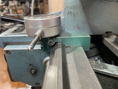

Winter is here and weather has shifted to shop weather.
I'm back at several projects that have been on hold.
Don't have a 3D printer yet, so wooden prototypes are us.
Looking good so far.
I wish that zero screw could be moved to the bottom right. It will be a bit of an issue when I make the metal prototype.
This one fits both a 1 & 2 inch plunge indicator.
I'll prolly cut a 45 degree flat on the top edge to look a little nicer.
