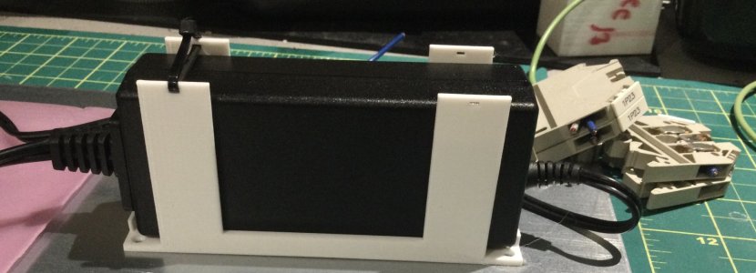

+ I don't know how to use Fusion or any similar program, however the PCB software I use (Altium) has 3D capability that is very easy to use. That's all I have been using. So perhaps you can leverage some other software that you are already familiar with. With Altium you can make the shape of the PCB anything you want and you can set the thickness to anything you want, a through-hole pad becomes a drilled hole. So I can make a shape and then save that thing as a step file. I can then make a more complex part by just merging the various step files and saving them as a step file. I can rattle off a simple part in minutes using this technique. Yesterday I needed a simple mount for a power supply. A few measurements later I had my simple model and off to the printer.
In the example shown below, the base was just a rectangular PCB, with 4 pads (mounting holes), I added little edges using the create extrusion feature. Then I made another simple PCB shape for the four little tabs, simple rectangle shape with a slot for the tyrap. I then added four of the "tab" step files to the original (oriented at 90 degrees) and placed appropriately. Point is you can start with really simple shapes.

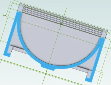

Wall thickness for example. Although a machined or sheet metal box might work well with 1mm thick walls 3D printing is too thin and it's fragile and can warp.
Support while printing. Or just design so the support is built in. And is it printed right side up or down and if so how to add support.
When we build for metal we can get away with a threaded hole in material that is the thickness of a standard nut. Holes that are 3D printed are generally just concentric circles and aren't well melted together so designing for a thicker area for screws. Ether to be tapped or trying to make threads (usually doesn't work well). Or instead create a circular and then hex hole that doesn't go all the way through and epoxy in a nut. We do that in woodworking but rarely in metal working.

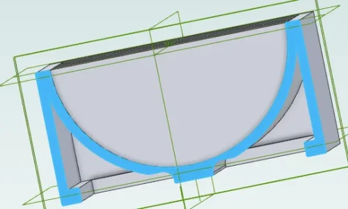

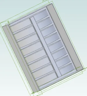

For example. Here's the first try at the cutter holder box viewed from the bottom. Meant to be printed from the top side. The walls are so thin that the printing of the curves creates gaps because the curve is changing faster than the thickness of the layers.
I added a support since the curved parts didn't reach the bottom and tried printing it with the box sitting upright.
I still had issues even after I added fillets.
Since @David_R8 uses Alibre ATOM Rev 27 I can't read the design files into my Alibre Expert 25 or 26 I used the dimensions from his box and started over.
I used thicker walls when I created the shell under the curved slots. Now the space between the slots is filled. Then I added a plate on the bottom and cut out two rectangles and added the fillets. Now instead of 1.5 hours it takes 4.5 hours to print.
While printing in black it appeared to have a flat are at the bottom of each slot. So I sectioned the drawing. It shows a side effect I didn't expect. The fillets appeared to be cutting away part of the curve. Turns out it wasn't just the fillet but the plane and the inserted flat section.
I played around a bit more with the thickness of the flat section, plane position and fillet radius.
Now it's what I want and I can print it right side up so that when it sits on a shelf or drawer it will sit flat since it was printed this way on the build plate.

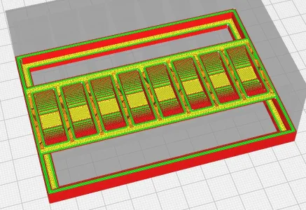

None of this would be an issue with it built out of metal because we'd never design it to have this type of cavity on the bottom. Maybe flip it over to create some slots so it would be lighter but that's just extra milling time with no real purpose.
And now the CURA slicer properly fills in the gaps with 20% infill. This section is at layer 33 out of 175.
