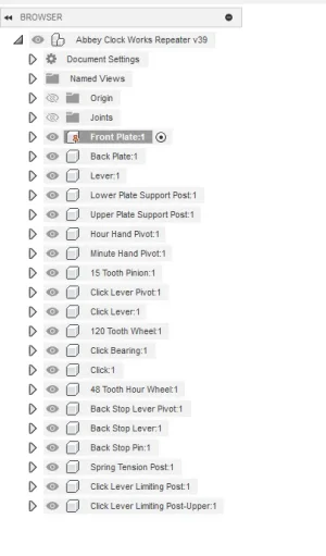

Another thing I'm confused about. My Documents on the cloud seem to separate drawings from designs.
That might be why the drawings don't update as I change the design. This really sucks. I don't want to have to redo drawings every time I make a change.
Also, does anyone know if the drawings eat into my 10 file limit?
Yes a Writeable drawing counts.
I don’t know about Fusion but other systems I’ve used “know” the address (file location) of the model file and the drawing file pulls the data from the model even if it’s not open so the drawing should match the model. All bets are off if you move the model some place the drawing doesn’t know where to find it. Again, in other systems you can go in and tell it where you moved the model file to.

You drawing file will show this little warning triangle at top of screen when you save the model: I have all file related to a project in one folder. Also I generally have all parts for a design in one file, thus limiting the interaction with the 10 active file limit in free version. I know some don't like that approach but even on a moderately powerful desktop PC I can play with an entire model of a Grizzly G0602 lathe down to every bolt nut and washer.

You could always create a Team, this should allow collaboration e.g. with the lessons from Janger.
Yes, that's the same triangle I was referring to except that mine also shows up beside every dimension In the drawing. The dimensions are also the old ones.
My impression is that the drawing remembers what the numbers were when you made the drawing, and also knows that you changed them since then, but can't find them.
There must be a way to update the drawing without having to redo all the dimensions.
