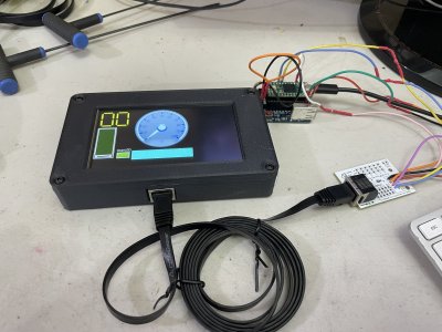

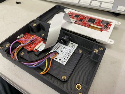

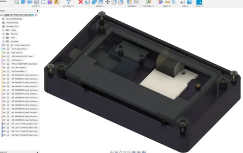

Regarding holes, stress, fit, etc - designing 3D printed parts with fasteners takes some planning. The images are for a machine control panel which will be used and abused in service. It must be tough, shockproof, dustproof and servicable. The design (F360) uses geometry to hold the parts snugly in place without screws. The lid is screwed into the case and the base of the case has a VESA style mount plate. I use M3 and M4 inserts which fit into an undersized hole and are melted into position with a soldering iron. Wall thickness is 3.5mm. Material ABS-CarbonFibre.
Designing with Fusion offers many possibilities, including parametric designs, full 3D component integration and complex motion assemblies.

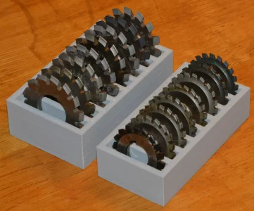

The original box had 62.8mm diameter cavities. For 60mm diameter gear cutters. The width of the box is 70mm. My cutters are 40 and 50mm in diameter. Gee I though. Parametric CAD. Why not make boxes the right size for my cutters.
So when I draw the box I set the width to the cutter diameter plus 10mm. The 50mm cutter box width is therefore 60mm. That's the only parameter I need to set. The slot for the cutter is 2mm larger. The depth and width and all work out just peachy.

I had originally thought it was for Lathe gears, not gear cutters. But they are both good ideas! I have a few gear cutter sets that could benefit from a holder like that.
Here's the result using brand new M3D grey. For some reason it lifted in the corners a bit. Normally this printer doesn't do that.
These are the 40mm diameter M0.5 gear cutters. I think I should build a lid for it or print a second as a cover.

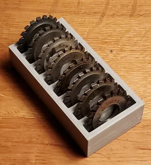

I'm now busy printing the 50mm cutter box. It's the same length as the others but an extra 10mm wider.

That is one impressive box. I wish the electronics magazines would run an in depth column just on packaging. I find that one of the more difficult things when I build stuff.

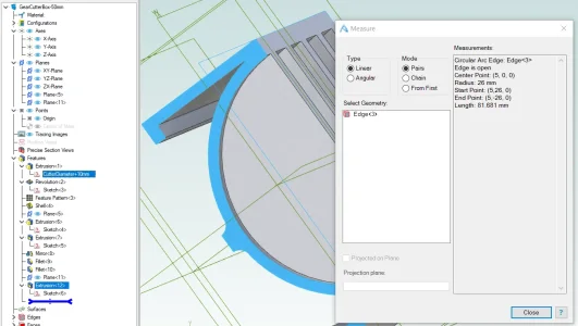

Here's the second one. Gives a better perspective of Parametric 3D CAD in the sense that the two parts are different by changing a single dimension that is then used to create a number of other dimensions.

Is that like print scaling or some other tool?

Each length can be a distinct value like 1.000" or 25.4mm and each dimension is assigned a number. Like D2, D3 etc. Now imagine this new length you want to set is D4. You could set it to be 1.000". Or it could be D2*4. If D2 is 0.25" then D4 is 1.000". Same value but D4 is now dependant on the parameter D2. That's why it's called parametric CAD.
Make sense?
