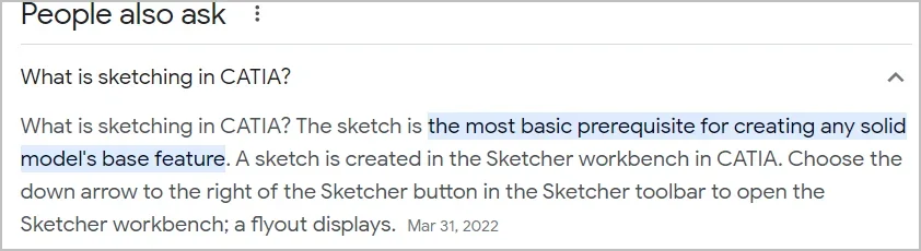

That sounds more like Catia. You don't start with 2D and morph that into 3D. You start with 3D solids that you shape as appropriate.
Sorry for sidetrack to what is a Fusion post. I've never seen CATIA but always assumed it was $$ industrial strength 3D software, but more or less workflow aligned to alternate parametric apps like Inventor, SolidWorks etc. which are heavily sketch driven. Google is a dangerous thing, but it seems to contradict what you've stated.

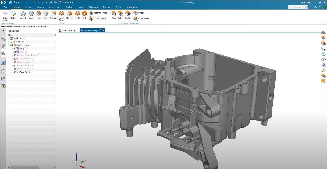

Here is the workflow in molds for example.
Customer sends data from different CAD software with no history.
We rename it *.CTM and modify it using synchronous modelling (history kept), all moves on the dumb clay can be changed..
*.CTM part is linked to shrink part, where expansion is added.
shrink part linked to molding part where part is moved to mold position.
molding part is linked to parting part, where core and cavity are split.
parting part sheets are linked to partingline, core part surfaces on layer 27 cavity part surfaces on layer 28
partingline development is done on layer 26. at end of development on layer 26, layer 26 gets parameters removed.
layer 26 is linked to 27 and 28 where they are sewn together to part surfaces
layer 27 partingline and part (sewn) are linked to core block. layer 28 partingline and part (sewn) linked to cavity block.
core and cavity blocks trimmed with linked sheets
all components are then linked and cut from blocks.
This is entirely parametric....
As far as working with dumb clay, I just make a copy and start editing... I do not need to have sketches... never ever use them. @Susquatch
Now I really cannot speak to Fusion as I have not used it that much. I am totally addicted to NX software, which has sketches. I just have never used them once I started working in industry..

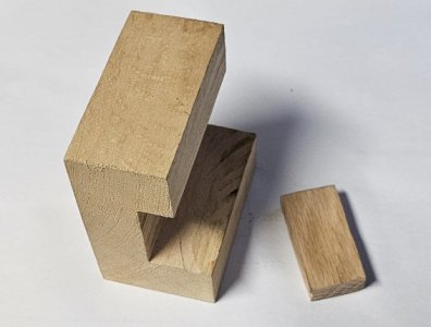

I whipped this off my 3D cellulosic duplicator.
The small block is the sliding lock.
Fits perfect as drawn.
Some more functional requirements to add, and also some cosmetic features and bevels but so far so good.
I modified your concept. Note the cap screws on top for easy locking. Just need side screw for adjustability.
Or if you don't want to hunt for the hex key, sprung handle thingamabob. These are carriage stops, but same concept
I like that. the bottom part having the little step insures the pressure is direct and prevents it from rocking... Thankyou for the input...

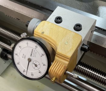

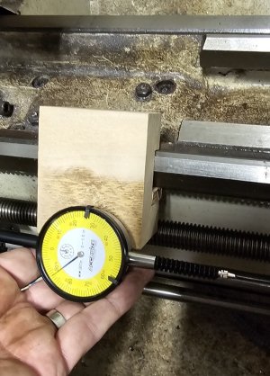

Here’s my take on a Indicator mounted on the carriage stop that I purchased with my lathe:
There are some recessed magnets holding it on (covered with 1/32 ply to make it easier to remove the chips that get on the magnets)
I like the idea of a two component design. Keep the stop simple and add the indicator only when needed.

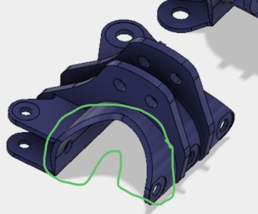

I had a model where I just couldn’t blend between two bodies in a nice way. I opened the component in the Surface workspace, deleted the faces of the offending bodies and then extruded a surface that made the cuts I needed. Then I turned what was now a surface model back into a solid model...
This is the model that was giving me that grief, with the surfaces I needed to blend:
If you’ve come across something where you think “this would be so easy to do with a file”, then you probably need to use the Surface workspace…
(A bit of background, Fusion doesn’t really make 3D solids, what it does is make surfaces and then the program can “define” a fully enclosed set of surfaces as a solid model. By using the Surface workspace and deleting a surface, I turned the model into a hollowed out shell of zero thickness. I needed to repair the shell and make it fully enclosed again and once that was done Fusion allowed me to turn it back into a solid model)
