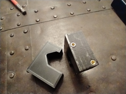

When I get home, I'll post another photo of that. It's basically a sliding block that tightens onto the inside bottom corner of the way. Pockets in the sliding block capture the screw ends, and main block is threaded. Lots of other ways to do it.

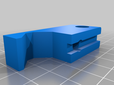

I added you to a DM Thread on Fusion and my stop. I think there is a Fusion File there.
The stop isn't a high strength accessory. My guess is that you could modify my file for your lathe and print out a working part on your 3D printer that would be every bit as good as my future aluminium stop. I'm so jealous of you guys that can do that.
I plan to add a few more features to my stop that would be easy to do with a printer. But for now wood is my easiest prototyping option.
@slow-poke - here are the photos I promised.
The pen lines were just to find the centerline of the sliding block to intersect the bottom of the way.
It's important to know that the way is a 90 degree V with the top ground off. So a 90 degree block rides it perfectly. Also, the line of the bottom of the way is behind the V so the main block is pulled square as the sliding block is tightened.
In the working stop, the sliding block (the dark brown wood) will be a wee bit thinner to ease installation and will have a V relief machined into it to improve the grip on the bottom of the way.
Originally, I was going to include a micrometer thimble, but I see no point given that it would be too easy to damage it. I'd rather just watch the dial gauge.

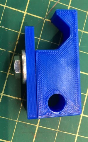

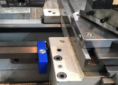

Well, thanks to inspiration via Susquatch and Blondihacks for the ready made 3D model and 20 minutes of print time in draft mode I have a working prototype that fits my lathe.
I will make a "better" one from aluminum or steel in the near future.

Couple of comments.
Top of V way needs to be taller to avoid capping out. Make it more of a V-slot so it sits on the way without bottoming out.
The hole for the indicator stem needs to have a clamp built into it somehow. I favour a longer block, a slit, & a through screw.

From the blondihacks video, she determined the angle is not actually 90 degrees, the plastic deforms, but the metal one will be done correctly.
Good point. Its been so long since I started this thread, I forgot that many lathes are not 90.
Fortunately, mine is a perfect 90. So I don't need to worry about it. Your mileage may vary.
Regardless, the throat width of the V in your block needs to be less than your lathe so it sits properly and doesn't interfere.

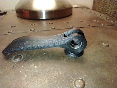

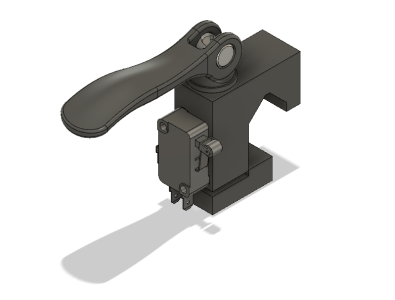

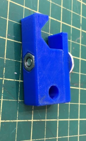

I went another way for my clamping... a fast lever action to be able to reposition the clamp fast. I made it as an end switch to reverse the lathe when threading
I printed the lever and the bearing surface.
I can easily modify to add a indicator holder, instead of the microswitches
Took no time at all to model and print.
