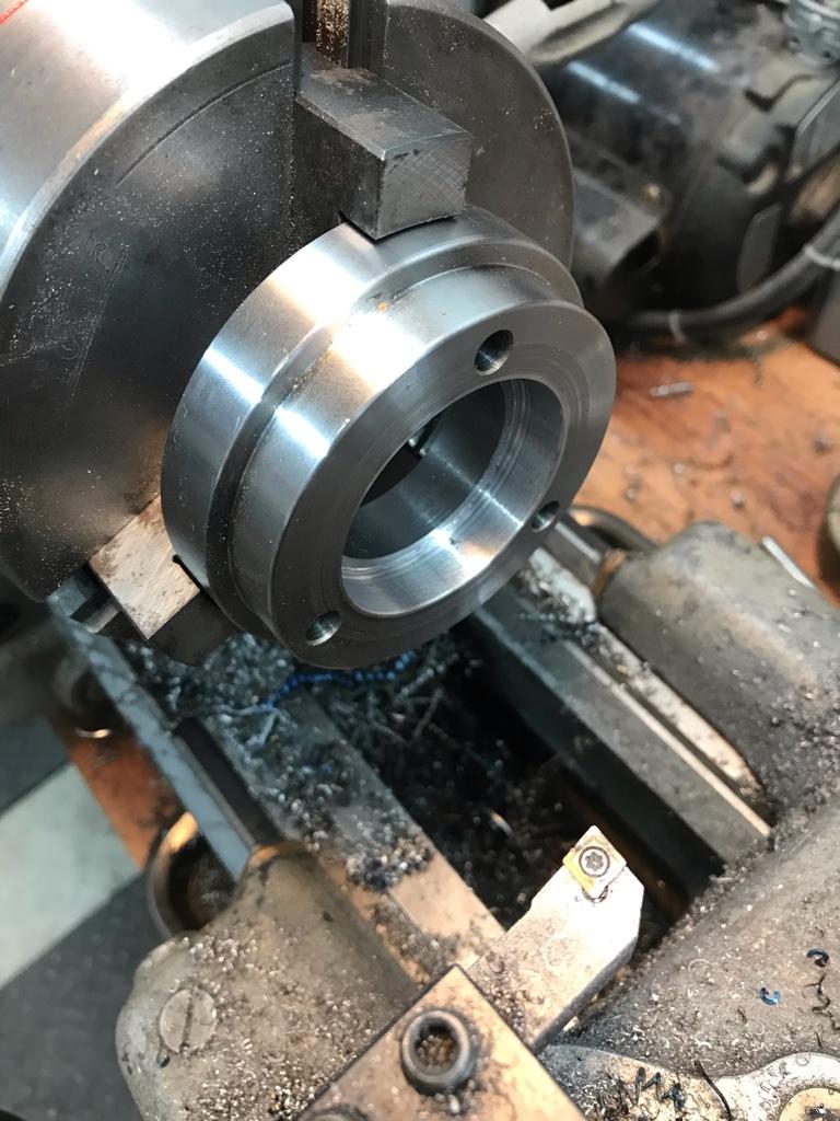

I finally felt well enough to venture into the shop so I took the afternoon off.
Made serious progress on the mill power feed.
Originally I planned to mount the feed on the right side of the table. That would have required boring out the ring gear to fit the end of the lead screw.
For reasons unknown to me, the two ends of the lead screw are different diameter. The left side fit the ring gear perfectly. So I revised the plan and decided to put it on the left side of the table.
I also decided to lay the drive horizontally front to back as that gave me more clearance over the base of the mill.
This also allowed me to use the round mounting collar that came with the unit.
(Huge thanks to @YotaBota for donating the regular horizontal mount but it proved unnecessary in the end.)
I faced off 1/2” of the collar and then bored it out so it slipped over the snout of the cast iron bracket that bolts onto the table.
(The pic below is a test to make sure it would fit snug on the bracket)
I then positioned the ring so the two of the three mounting holes in the above photo were horizontal on the cast iron bracket.
None of the two tapped holes in the collar matched up with the many holes in the unit but two spots were partially drilled and those worked perfectly.
The gear and shaft is long so I parted it off at the threads.
I still have to figure out how to secure the gear to the lead screw. It has a key way but there isn’t a matching one on the lead screw and don’t have a way to cut one into it. I may cross drill it and use a roll pin but I’d like to be able to adjust the gear mesh.
Another idea is to drill and tap the gear for a set screw or a pair of them on opposite sides. The lead screw is not hardened so I could easily file a flat into it for the screw(s) to land.

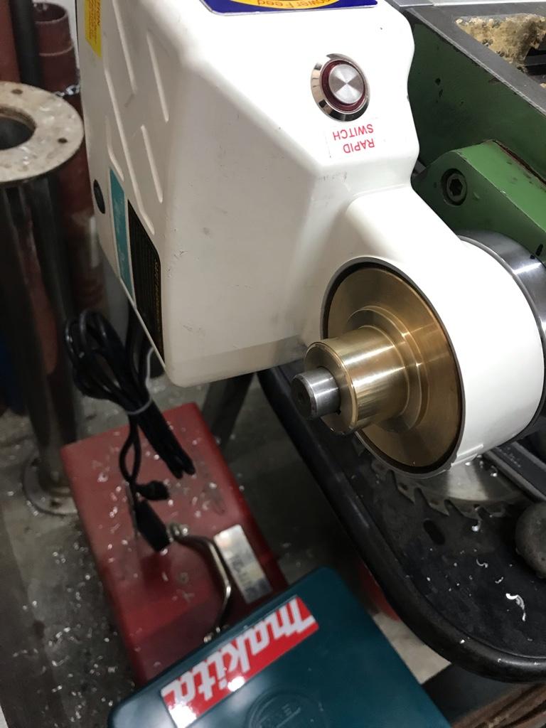

I've been looking at this over and over again, and just don't get the arrangement?
I assume the piece you parted off threads into the gear that meshes with the PF gear?
Why would they have that sleeve in the first place?
I don’t know what the piece I parted off is for when the unit is used on the Y-axis of a Bridgeport style mill.
I saw @YotaBota mill but I didn’t notice exactly how it was arranged.

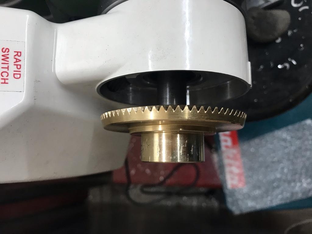

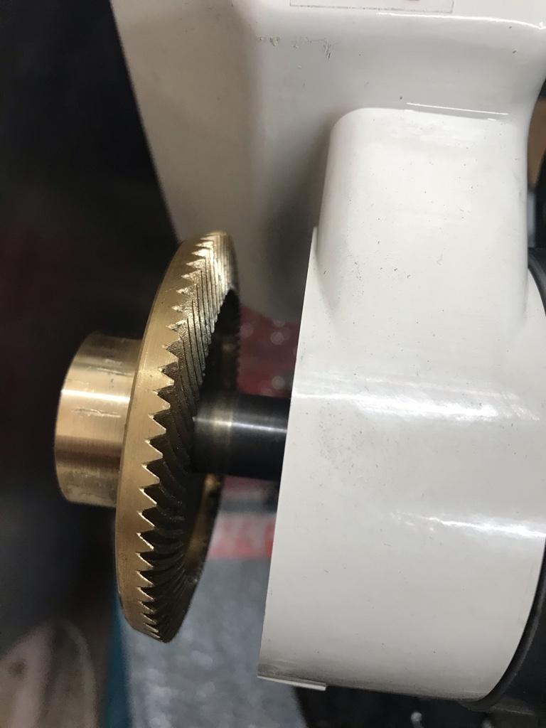

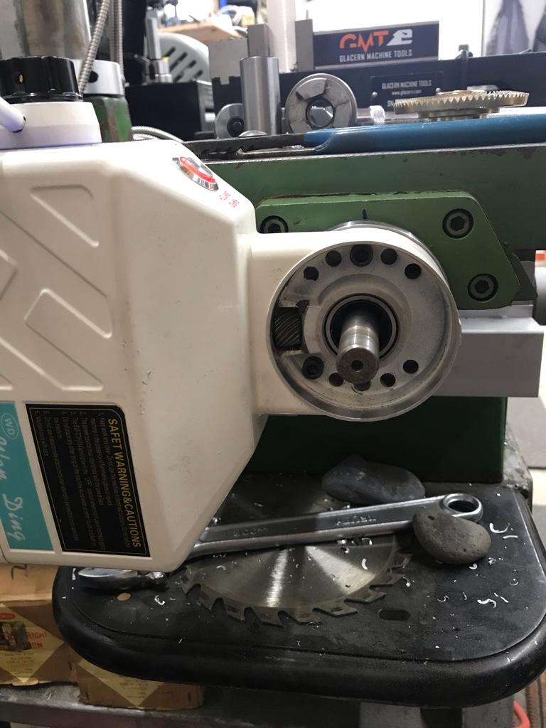

Here’s a couple of pics that may help.
This is the unit mounted without the ring gear in place. The pinion gear is to the left of the lead screw.
There is also a bushing slips over the shaft and runs on a needle bearing in the opening. It’s the silver ring that’s visible around the end of the lead screw.
Here is the ring gear partiality on the end of the lead screw.
David I see a threaded hole in the end of the shaft I assume fastened the original crank handle. How is torque transfered from the handle to the shaft? Is there a key? Does the handle slide over the OD of the shaft like a Bridgeport style machine? I'm thinking that you might use a collar and selective shims that slip over the shaft to force the brass gear in mesh with the motor pinion and allow adjustment of backlash. All of this stuff to be held in place by the bolt that fastens crank handle. Then perhaps an axial drive pin or 2 through the handle into the end of the brass gear to transfer torque?
On my mill (6x26 knee) the part your parted off is for the dual spacer which has the graduations on it.
You know I never noticed that that hole was so deep, I always thought it was just a centre drill for a live centre when the lead screw was made.
I don't believe it's tapped though.
The handle is attached with a set screw that bears on the shaft. It has a dog style connection that connects a round collar which is pinned to the shaft.
When the handle and collar are in place there's about .25" of shaft sticking out of the handle.
When the brass gear is snugged up to the pinion gear, there is about .75" of shaft sticking out past the brass part. I might try to see if I can make a thinner version of the round collar and see if I can put the handle back on. I'm not sure I'll have enough shaft length though. I suppose I could just put the handle back on and call it good.

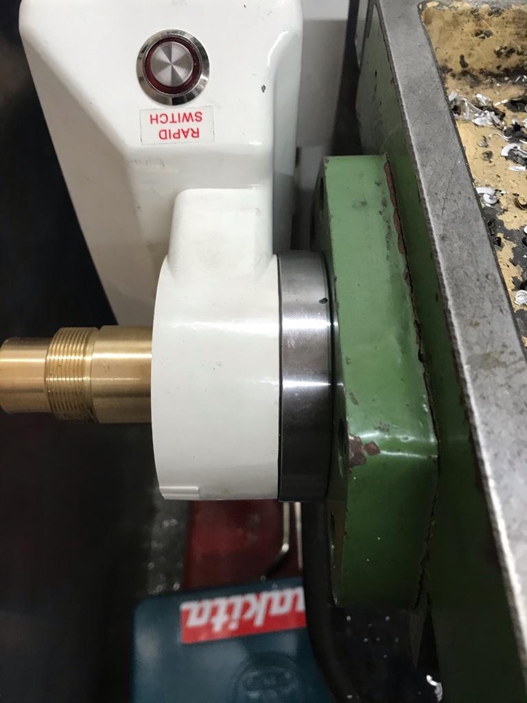

Where did the threaded brass piece in the first image disappear to in the second image?
That's what I parted off.
In the first pic, there's a groove just past the threads. That seemed a logical spot to lop off the excess. I've since parted off an additional .25" or so to make more room on the shaft for another locking collar, or maybe the handle.
