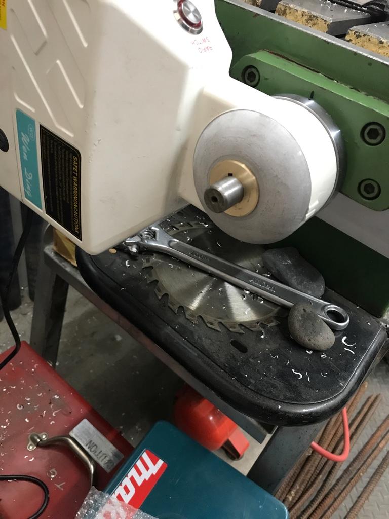

Well the power feed is complete save for the collar on the end of the lead screw.
I 3D printed the grey cover for the gear.
Works great!

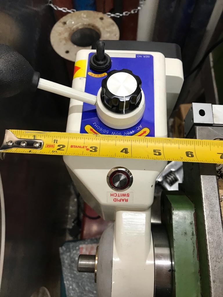

Can you post an image of the overall installed as it sits on the table please? How far to the left does it extend past the end of the table? I'm really tight for space on the left hand side and am wondering if this would work for me.

Here’s a pic Craig
It’s 6.5” from the end of the table to the top of the handle.
4.25” from the edge of the table to the side of power feed housing.
It takes up less room than the handle did.

This would work for me. What dia is your lead screw on the LH side?
Did you end up covering over a gitz oiler on the LH side lead screw support casting? I assume you ended up drilling and taping the support casting correct?
[mention]YYCHobbyMachinist [/mention] oddly there is only an oiler on the right side bracket.
I don’t know the diameter but I’ll measure it for you.
I did drill and tap the bracket. A couple of 1/4-20 SHCS.
