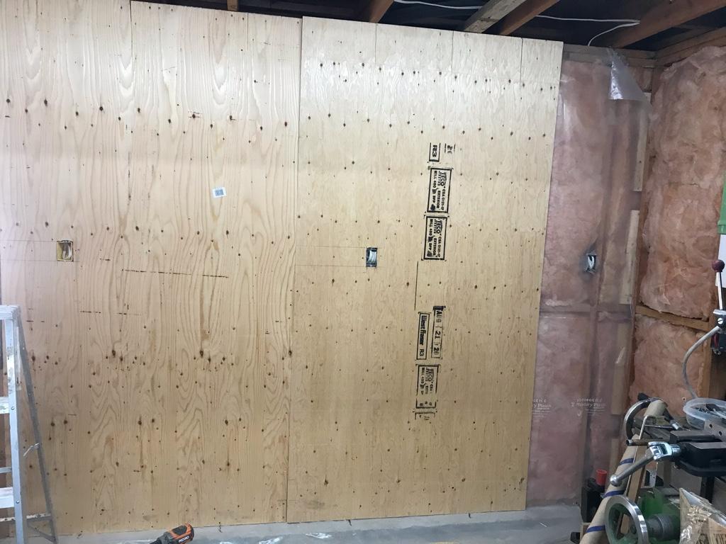

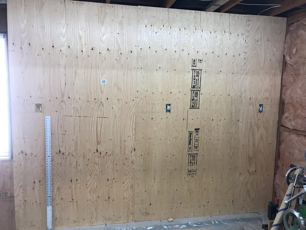

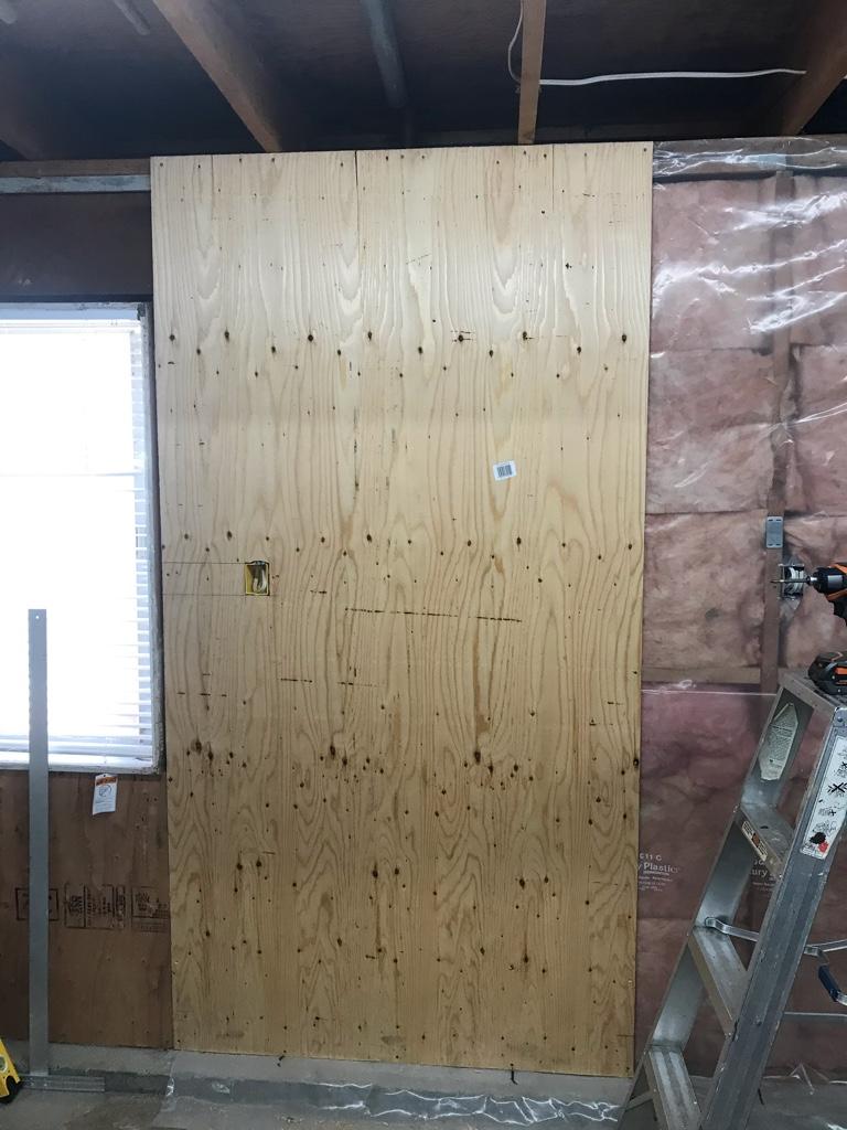

Bit of a long day but the end result is worth it.

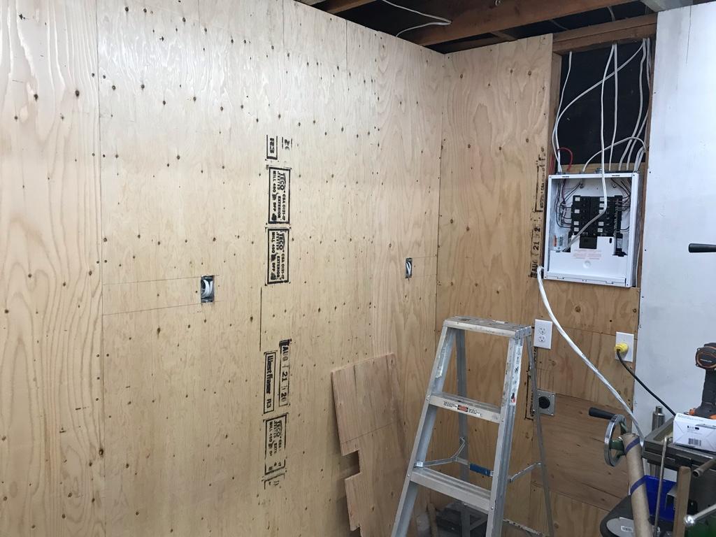

I wired in four 120v outlets and a 40A 240v plug for the welder.
All that’s left to do is fill in the space above the panel and paint.
Then all the interior wall done
I still have to run some outlets in the wall
but those I have to do with conduit as there’s no overhead access due to the beam.

You probably mentioned this a many moons ago, but what kind of (I assume TIG) welder are you plugging into the 40A & have you had any issues approaching the max?
oh crap it says right there in your profile. duh
Nice. One thing about plywood is its tough. You can screw & hang legitimate stuff to it.
Yup, it’s a Primeweld 225 AC/DC TIG.
I’ve only just installed the 40A circuit so I have no idea what it’s like at max amperage.
I will say that I could squeeze 85A out of a 15A 120v circuit so 225A on 240v 40A should be doable.
Specs call for a 50A breaker but none of the folks who I know are running 50A and it maxes out just fine.

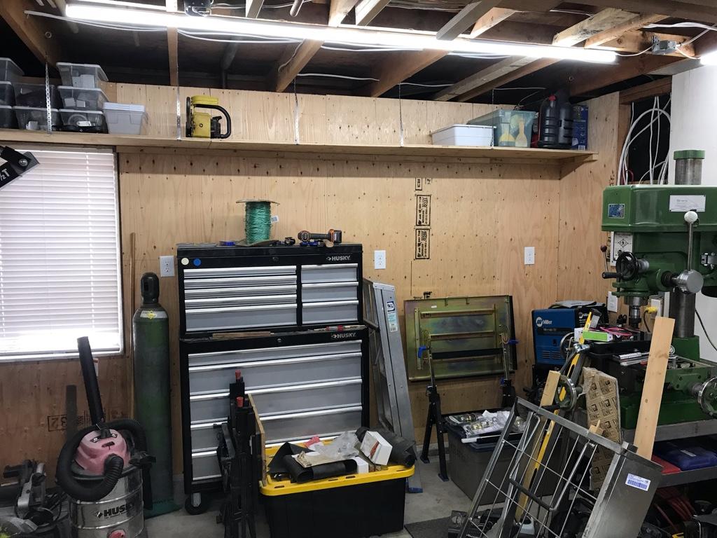

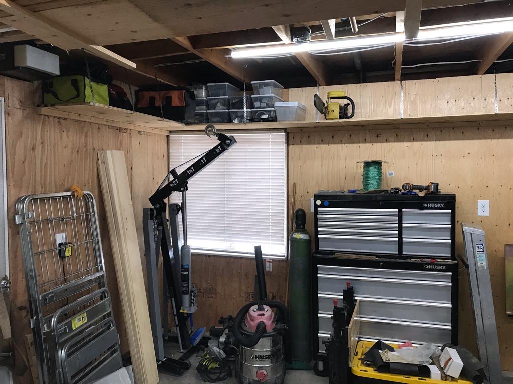

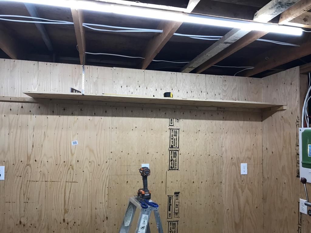

Put in an hour or so after work and got the beginnings of the shelving up.
Reusing the 5/8 ply from the freestanding shelves, 2x2 clear along the wall, 3/4” metal strapping down from the roof joists wrapped under the front edge of the plywood. Fastened with 5/8” wood screws.
Bit hard d to see the single strap in place near the left end.
Strong enough to hold me doing a chin up. Just one ;)
