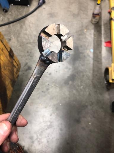

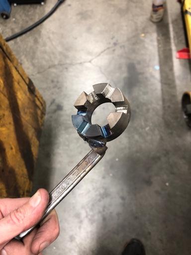

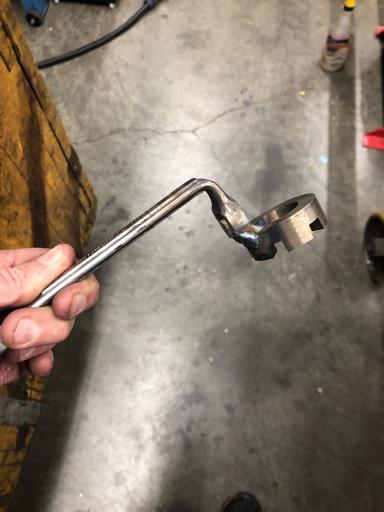

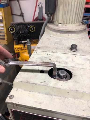

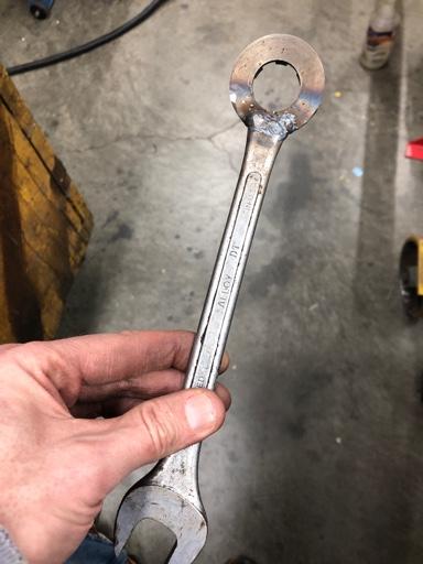

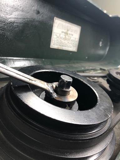

Neither of my mills have spindle brakes or spindle locks, makes it interesting for tightening draw bar manually
Made spindle wrenches out of some old wrenched from an auction and some 2” 12L14
