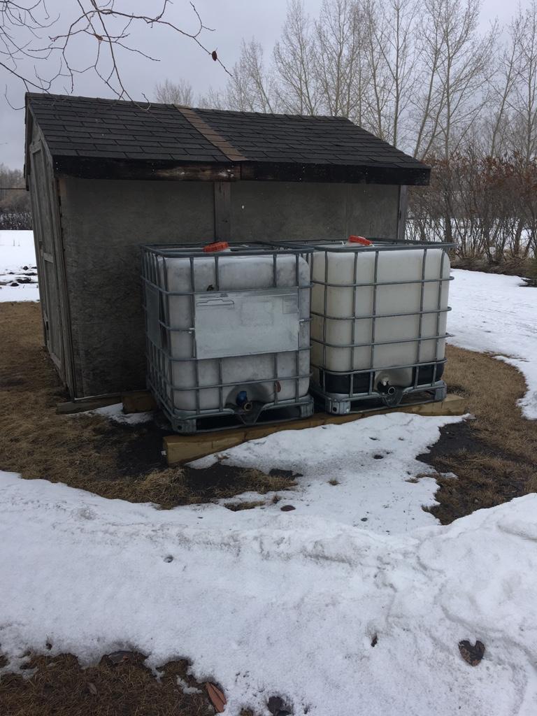

Thanks for the idea. @Dabbler the Brenntag web site says below. So what is a tote? A drum?
BUY ACETIC ACID
We sell the following various grades of acetic acid in drums, totes, and bulk quantities:
Acetic acid 25%
Acetic acid 56%
Acetic acid 70%
Acetic acid 80%
Acetic acid 84%
Acetic acid 85%
Acetic acid glacial
Janger
(John)
Ah I would call that a cube or M3 cubic meter. A drum is apparently 55 gallon drum (200litres). Well I guess I’m not sure I want 200 litres of strong vinegar. Unless there are ten guys in Calgary who want 20 litres each?
kevin.decelles
John, depending on cost, I can store a drum out here , or a tote, provided it can reside outside (freezing?)
